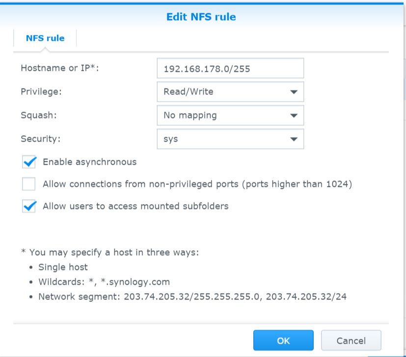

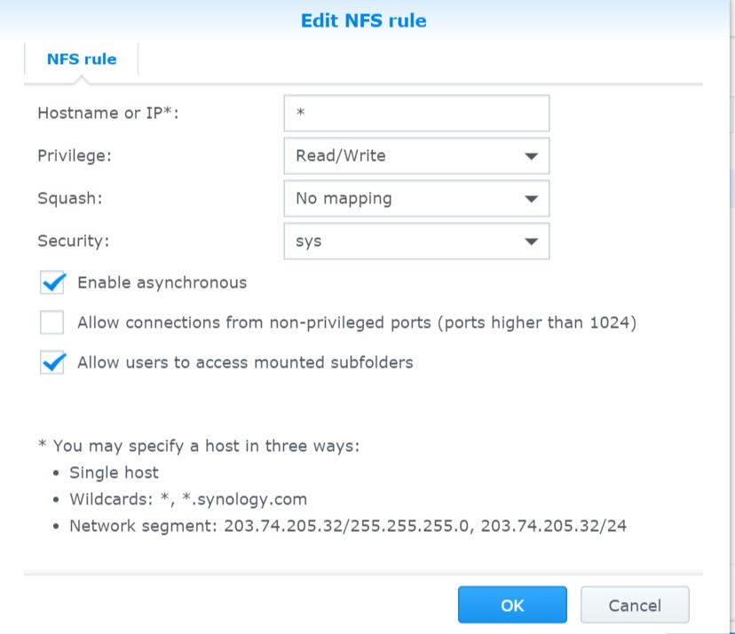

Hi Tim, the string is the standard one "nfsvers=3,ro,noatime", I have tried several others in the past, and spent evening trying to understand unsuccessfully. Actually the mount seems OK, but when I try to create the database it goes in loop forever with no result. Hope that helps.
BTW one thing the 3 players should have I believe is give more detail about the mounts and mpd db updates.
Thanks a lot
Jean-Louis

Hi Jean-Louis,
When u connect to the music share on the NAS from either a Windows or Mac computer, what do you type in to make the connection?
For example:
(1) On Windows you would use File Explorer to map a drive to the share on the NAS
z: \\nas_name\share_name\folder
(2) On Mac you would use Finder, Go, Connect to server...
cifs://nas_name\share_name\folder
If you can do #1 or 2, then this information can be used to fill out the fields in the NAS source screen in Moode.
Tim

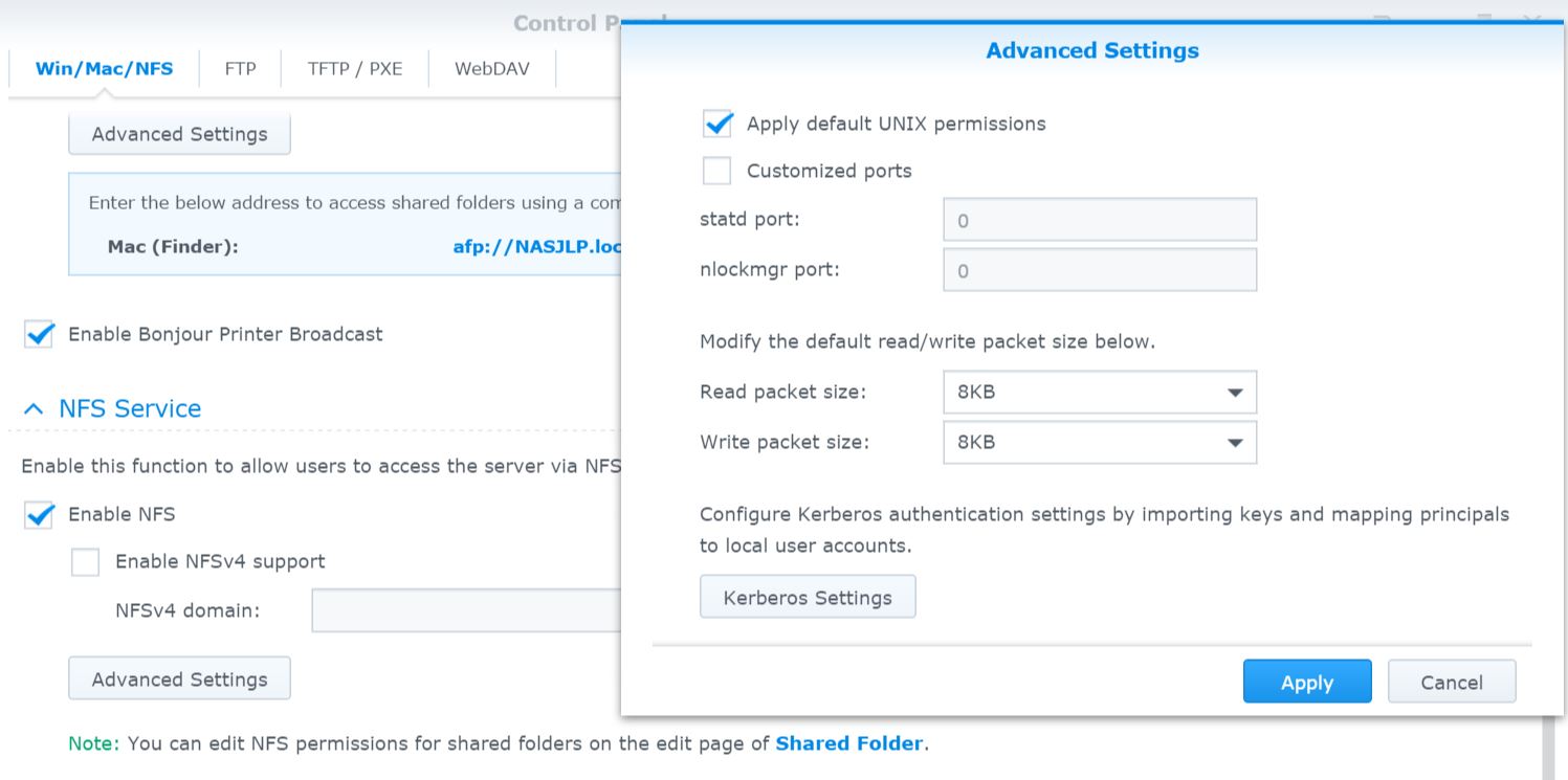

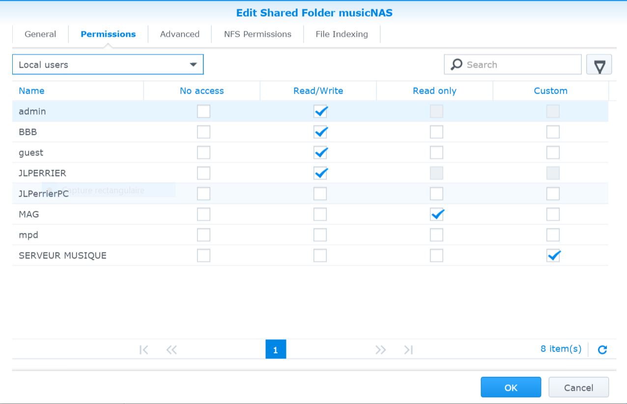

Hi Tim,
In the Windows properties of my NAS I got ‎\\NASJLP\musicNAS‎. I am trying to connect through NFS.
In Synology system, I granted all authorization to the user BBB I created, btw not asked in the "source" menu, as well as "guest" and "admin".
In Synology admin (I have only one disk installed), they tell me the name of the folder is /volume1/musicNAS, which I entered in source menu. In Moode, after validating, the NAS is recognized in the sources (no X) but nothing happens.
Jean-Louis
Tell me if you need something else
I add some screenshots from the Synology config if it may help
