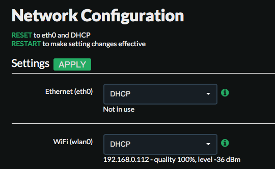

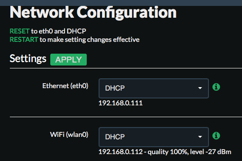

Finally, someone else with a Wifi issue ... will check the interfaces file and report back..
update: no joy. the wifi interface doesn't come up on my setup (pi3, built-in wifi) and the interfaces file reverts back to "off" after reboot.
Post the output from the following cmds
ifconfig
ip addr show wlan0
-Tim
Yes I realised my mistake.
but even with off settings, the wlan goes down
What DAC are u using?
-Tim
ifconfig
ip addr show wlan0
-Tim

Hi, couldn't get a log out of the router (its one of those routers provided by the company with no access to log files)...
after assigning a fixed IP address to the WiFi interface (MAC) it gets an IPv4 address but doesn't work. The eth0 interface has a ipv6 address and all transmissions are going through eth0 .. in the moode web interface it says "not in use" but if I take the RJ45 plug out of the Pi3 all transmission stops... I have no idea where the ipv6 addresses are coming from ??

Follow up
I called my provider and asked her to upload the latest firmware to the router... and guess what ? after reboot all is working again ! the raspberry is still getting ipv6 addresses but both interfaces are up. I have no idea what is going on but it looks like the problem was originating from the router.
eth0 Link encap:Ethernet HWaddr b8:27:eb:e6:78:d5
inet addr:192.168.0.111 Bcast:192.168.0.255 Mask:255.255.255.0
inet6 addr: fe80::b644:467:dcdb:2091/64 Scope:Link
UP BROADCAST RUNNING MULTICAST MTU:1500 Metric:1
RX packets:752 errors:0 dropped:0 overruns:0 frame:0
TX packets:504 errors:0 dropped:0 overruns:0 carrier:0
collisions:0 txqueuelen:1000
RX bytes:132226 (129.1 KiB) TX bytes:197089 (192.4 KiB)
lo Link encap:Local Loopback
inet addr:127.0.0.1 Mask:255.0.0.0
inet6 addr: ::1/128 Scope:Host
UP LOOPBACK RUNNING MTU:65536 Metric:1
RX packets:473 errors:0 dropped:0 overruns:0 frame:0
TX packets:473 errors:0 dropped:0 overruns:0 carrier:0
RX bytes:73587 (71.8 KiB) TX bytes:73587 (71.8 KiB)
wlan0 Link encap:Ethernet HWaddr b8:27:eb:b3:2d:80
inet addr:192.168.0.112 Bcast:192.168.0.255 Mask:255.255.255.0
inet6 addr: fe80::e15f:a866:c14c:7f9b/64 Scope:Link
RX packets:704 errors:0 dropped:0 overruns:0 frame:0
TX packets:278 errors:0 dropped:0 overruns:0 carrier:0
RX bytes:141329 (138.0 KiB) TX bytes:87563 (85.5 KiB)
