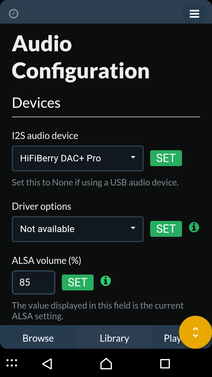

I have connected my Raspberry 3 with HiFiBerry DAC + pro via RCA to my amplifier. To adjust the volume to other amps connected to the amplifier, I have set the Volume (ALSA) to 85% in MoOde Audio Player 3.7 under Audio Configuration.
Has this setting affects the bit rate of a HiRes file (for example 24bit / 96kHz only ~ 20 bit remaining) or only changes it the audible volume?
Thanks alot
Thanks alot
