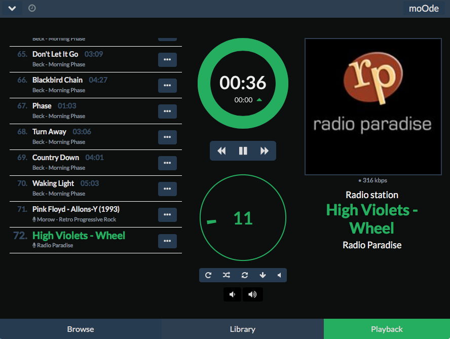

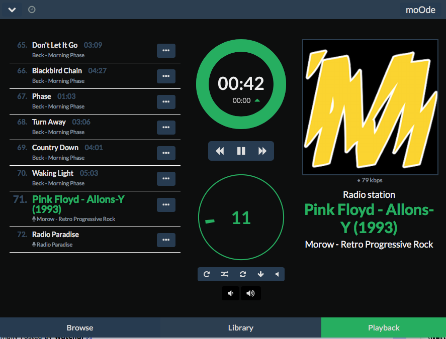

Metadata is coming through on my end.
-Tim

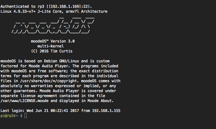

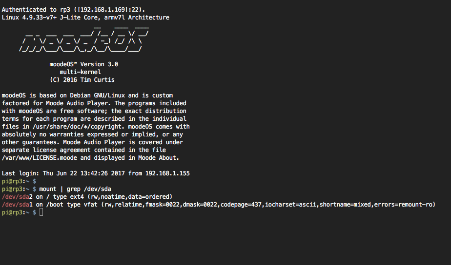

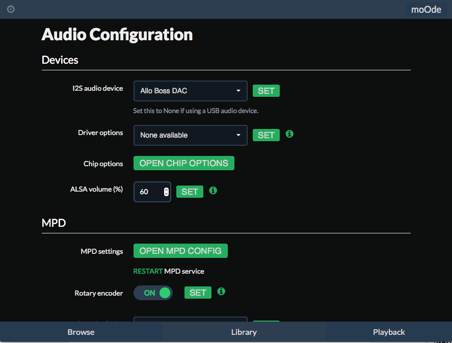

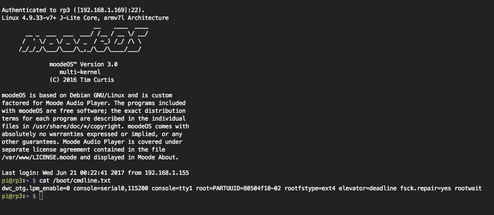

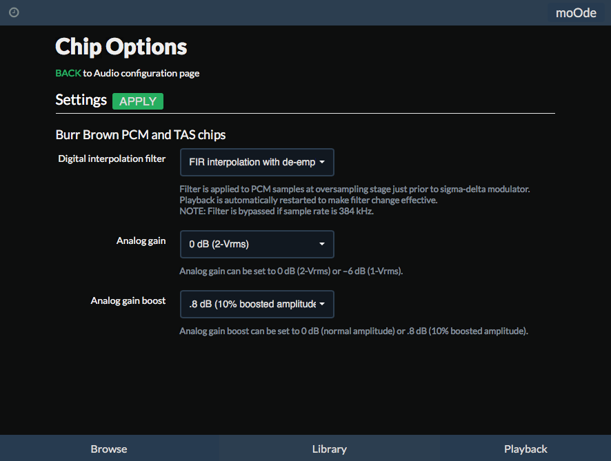

Hi - Some screen shots of moOde 3.8 including UI improvements, kernel 4.9.33, and new USB boot capability made possible by Raspbian 2017-04-10 release.
Hats off to the Raspbian dev's for making USB boot so easy to configure :)
-Tim

Yes, it's very easy to set up.
Thanks for including it. With SSDs at basement prices, it's a much more reliable platform than SD, where quality of disk is imperative.

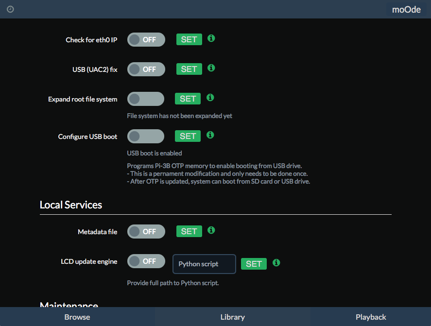

Hi @soldeed,
Programming the OTP memory to enable USB boot does not affect booting from SD card. The system can still boot from an SD card. If both a bootable SD card and a bootable USB drive are connected then the system defaults to booting from the SD card.
moOde 3.8 will include a System config setting to enable USB boot capability and a new File System Expander that works on both SD cards and USB drives. :)
-Tim

Is it correct to assume that if you follow the above procedure to boot by USB that once the OTP has been changed then you can never boot by SD card again?
Does 3.8 change anything with regards to the USB boot ability?
Just to clarify: the multi-boot feature was available with the new support chip, but hadn't been tested, so they left it turned off in the production Pi3. Once turned on, now there is support, there's really no need to turn it back off.
As well as USB MSD boot, it supports PXE (remote boot over Ethernet) which, once you set it up, is seriously cool - run Moode for Audio, Kodi for multimedia, or whatever other custom os you want - great for testing, etc. Just tell the PXE server what os to serve and reboot - great for "Pi in the wall" installations or distributed headless Pi across a network.
No storage needed at all on the Pi, you can assign network storage of whatever size you want (My 'work' PXE server has 12TB of SAS storage - only a few cents per GB!) or you can distribute a custom Moode config to each device based off a common image - you only need to change the hostid, which you can script to be the MAC address or a portion of. Great for distributed multi-room.
If you have kids, get them a Pi3 and PXE a desktop image with centralised storage, printing, etc. and no need to worry about corruption, virii, etc. - desktop performance for a fraction of a desktop pc price. Of course PXE will distribute any OS - windows, Linux, Mac OS - as long as the device supports it (most modern kit does) depending on what you want to do. Buy some second hand thin clients if you want more grunt and distribute Windows or Linux. My home PXE server is on a Mac mini, but it could be a Windows pc, Linux box, or Pi (put that Pi2 to work - PXE server doesn't need to be able to PXE boot itself) and doesn't need to be dedicated - PXE and network storage doesn't need much grunt.
