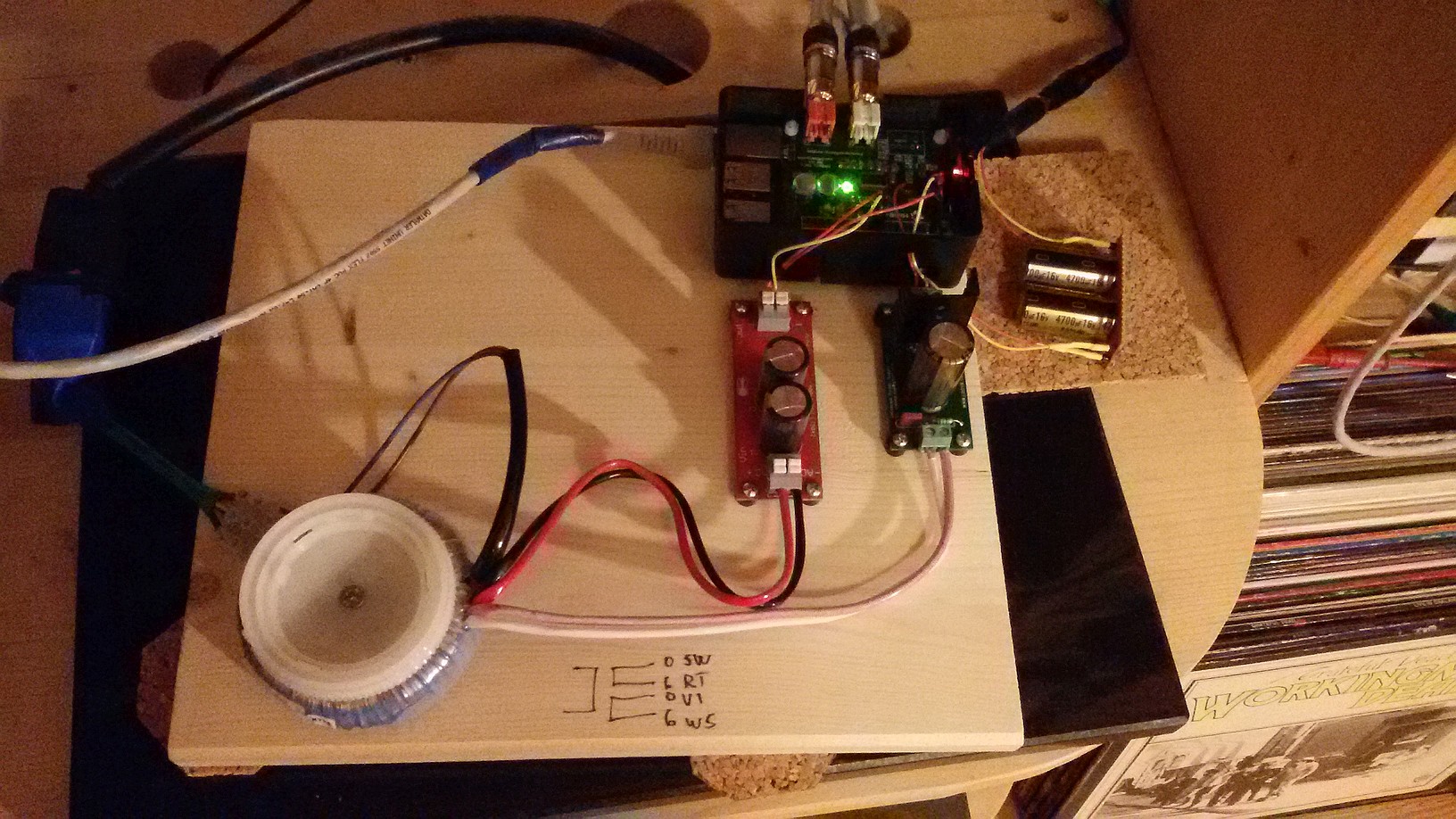

I have built a new streamer. After reading endless discussions on different forums i did this:
Raspberry Pi3 with Hifiberry Dac+ Pro with three power supplies:
1. iFi ipower 5V ps for Pi with 9400uF caps buffer connected directly to GPIO pins 6 (gnd) and 2 (+)
2. 3.3V ps with LT3042 for clocks and the digital part of DAC + pro connected to pins 20 (gnd) and 1 and 17 for (+). You have to bent PI3 pins 1 and 17 on gpio header, than DAC will not get 3.3V from Pi
LT3042 400mA DAC power supply xmos | eBay
3. 3.3V ps with TPSA4700 for the analogue part of DAC + pro. You have to remove R14, than DAC will not get 5V from Pi and then connect the + on the output leg of 3.3V reg
TPS7A4700 Ul IAAOSwSlBYts6j | eBay
One 50VA 2x6V transformer for ps 2 and 3, already ordered one 100VA and more caps for regulators ...
I have changed caps C7/C8 after PCM1522 for Digikey P/N PCF1457CT-ND Panasonic ECH-U1C222GX5. SMD parts are nightmare.
After i did this picture i connected 4TB 2.5" hd with my music files (wav, dff, dsf) directly to Pi. In this way i have the best sound quality, better than playing from NAS. Adding better rca outputs and one nice case is planned.
I am using Moode 3.7 and imho the best sound is with LL kernel and Fifo setting. Sound quality is absolutely phantastic compared to Pi3 with waveio and Buffalo II Dac, but soon i want to built another streamer using Pi3, Digi plus pro - i2s - Buffalo II. It is incredible how important power supply and clocks are.
I am missing one feature in Moode. When i go one track forward, than it automatically plays music, when i am going one track back, than i have to press "play" again if i want to hear a track again. Any chance to change this behaviour ?

I really love to see this kind of DIY that pushes the envelope Maybe you hang out with the inmates in the Line Level forum?
Current behavior is:
- Click on the Playlist item to restart the track
- Click prev btn rewinds the track to the beginning
- Click prev btn again starts playing the previous track
What would u like to see?

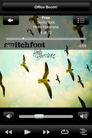

Thanks for the answer. I am new to moode player after many years of squeezebox. Now i know how to restart the track
When i was writing my post my player was already turned off so i checked the relase number on Your webpage and it was already 3.7.
I have 3.6, today i will update for 3.7.
There is one thing i am missing, or it is hidden somewhere. Simple display of track X from YZ tracks somewhere close to the display of time.
Like in Logitech app:
