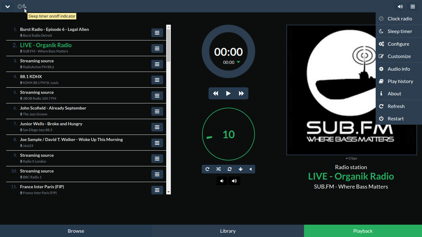

Pre
Gentle persons:
Here is a preview of a coming attraction.
I'm methodically modifying Tim's code to add a sleep-timer function (have I mentioned how many files and how many lines of code Tim manages on his own? I tip my hat to him!).
The attachment is a screenshot of my modified home page which shows a new "Sleep timer" entry in the pulldown menu and a new Sleep timer on/off indicator in the top bar. The crescent moon is my choice of icon based on what's available in the existing kit.
Working in this M-V-C architecture is a bit of a trick when one hasn't done it since Bush the Second was President. I'm nearly to the point where selecting the Sleep timer entry in the pulldown menu will pop up the Sleep timer settings pane. This pane imitates the existing Clock Radio settings pane but with only 3 entries: Enable - yes/no, Remaining time - minutes, Shutdown after stop - yes/no. The pane is mostly coded but I'm still dithering about my choice of time representation.
All this is just the eye candy. Underneath it sits code to effect the countdown and subsequent triggering of mpd/system actions.
Oh, what fun...I think.
Kent

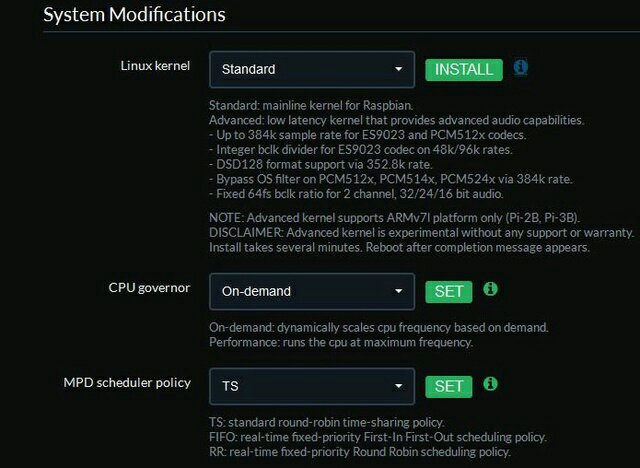

With low latensy need to be careful! At very low valued possible jerks in the sound! How does it help improve the "interoperability" still do not understand))
DSD128 over DoP uses 352kHz ?
it always has been, according to the specification (by default in kernel 4.4.*)
About realtime MPD -> These settings?
usermod -a -G audio mpd
echo "Setting RT Priority to Audio Group"
echo '@audio - rtprio 99
@audio - memlock unlimited' >> /etc/security/limits.conf
1) Doubt its the Adv kernel causing glitches, more likely MPD pegging the cpu trying to deal with DSD128. Maybe a bug in MPD.
2) According to DoP spec, 352.8k rate is correct for DSD128
DoP open Standard | DSD-Guide.com
-Tim

In dop mode DSD128 It does not use a lot of resources!
I use Kernel 4.4.7 + one of the latest mpd!
Sure if dop=of. then cpu very high load, because if dop off
dsd 64 convert to pcm 352.8k and dsd 128 convert to pcm 352.8 * 2 = 705.6k and downsampling to maximum support rate 384k
