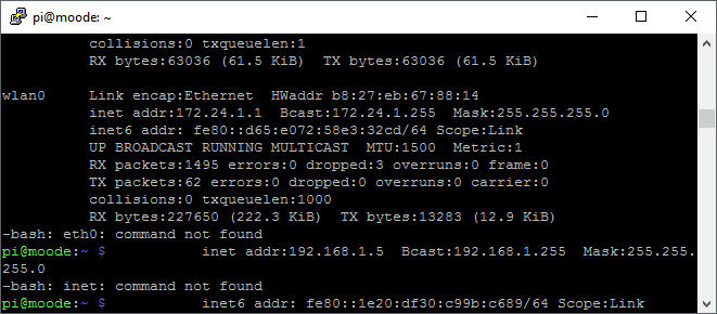

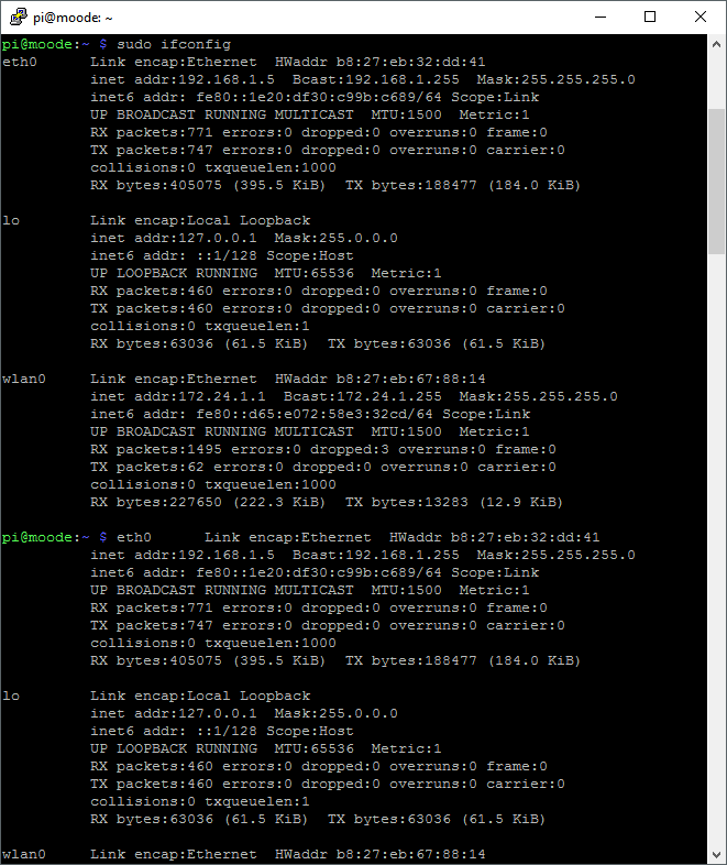

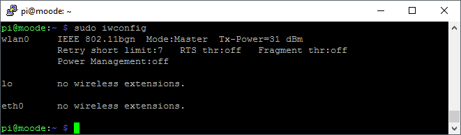

I couldn't figure out how to copy/paste from the putty terminal to here, so I had to take screenshots. I hope they work well enough.
These were taken with the Ethernet cable connected. I'll try disconnecting the Ethernet and rebooting the Pi, to see if it shows up as an AP that can be accessed by the PC or my phone.

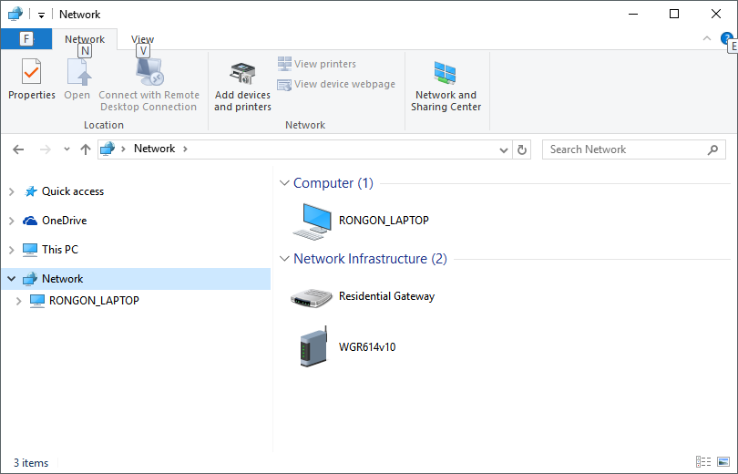

Incidentally, at this point, with the Pi connected by Ethernet cable, it's detected by Windows on my network (shows as a drive), and I can access it from Windows. This is the same as it was before.
UPDATE -- I disconnected the Ethernet cable, rebooted the Pi. It should now be an AP I can log into from an Android device (like my phone) or from the PC's WiFi card, right? Unfortunately, the PC can't see the Pi, and neither can the phone. Running http://moode.local/ from my PC browser results in "This site can't be reached" (of course). What is supposed to happen at this point?
UPDATE 1 -- The device "Moode" just showed up in my phone's list of wireless networks. I'm able to connect. Unfortunately... Now what? When I tried to open http://moode/ in my browser, it says "This site can't be reached" and "moode refused to connect".
Sorry if these are all dumb newbie mistakes, but this is my first foray into Linux or anything like this. I'm flailing, I know.

All the screen shots look ok. The wifi adapter on the Pi is definitely functioning.
When u initially connect via Ethernet and open the Network config screen, you should enter the SSID and password of your home WiFi network, then reboot.
If u want to try AP mode then note that Android OS does not support .local so you have to use http: //IP_ADDRESS_OF_PI. This is an old and nagging issue with Android.
-Tim

OK, understood. I've entered the WiFi SSID and password into the Configuration > Network screen in Moode. Should I delete the entries in the AP section? (AP SSID, AP channel, and AP password)
The Moode device has now shown up in my Windows Network. All folders, etc. fully accounted for.

I was able to open the UI by entering the IP address of the Pi. However, let's say I'm in a motel room somewhere, with my Pi with DAC/headphone amp and headphones, a USB thumb drive with music on it, my phone (to control the Pi), and the motel's WiFi. What would be the process of playing tunes from my Moode Pi? Are you expecting that I'd control the Moode Pi from a Win, Mac or Linux laptop instead of an Android phone or tablet?
Do I need to tell the Pi to set itself to a static IP address? I'd think that if I connect the Pi to a DHCP server somewhere else, it's going to get assigned an IP address of the server's choosing, correct?
Another thing, maybe a limitation of my PC -- If the PC's Ethernet interface is enabled, its WiFi interface is unable to connect. Once that happens, the Pi is also unable to connect through WiFi. I have to disable the PC's Ethernet interface, then the PC's WiFi interface becomes enabled, and then the PC can connect to the Pi through moode.local -- Is that the way it normally works?
Leave the AP mode entries as-is. AP mode is activated only when the SSID under WiFi (wlan0) section of Network config screen is blank.
If u want to use Moode via WiFi away from your home network then u need to blank out the SSID for your home lan then shutdown.
-Tim
