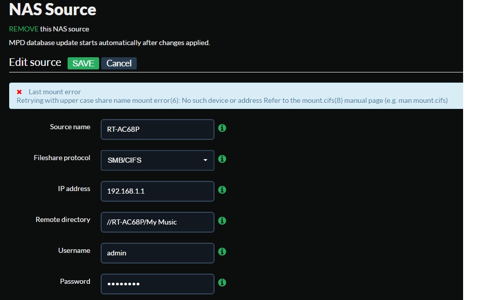

Hi Tim,
Thanks for developing such a wonderful program. I am using it and right now able to listen the radio stations. For some reason I am unable to configure the NAS. Actually its a HDD attached to a Asus router and I have tried many times and cannot get it to work. I am attaching the screenshot and keep getting this error.
thanks,
