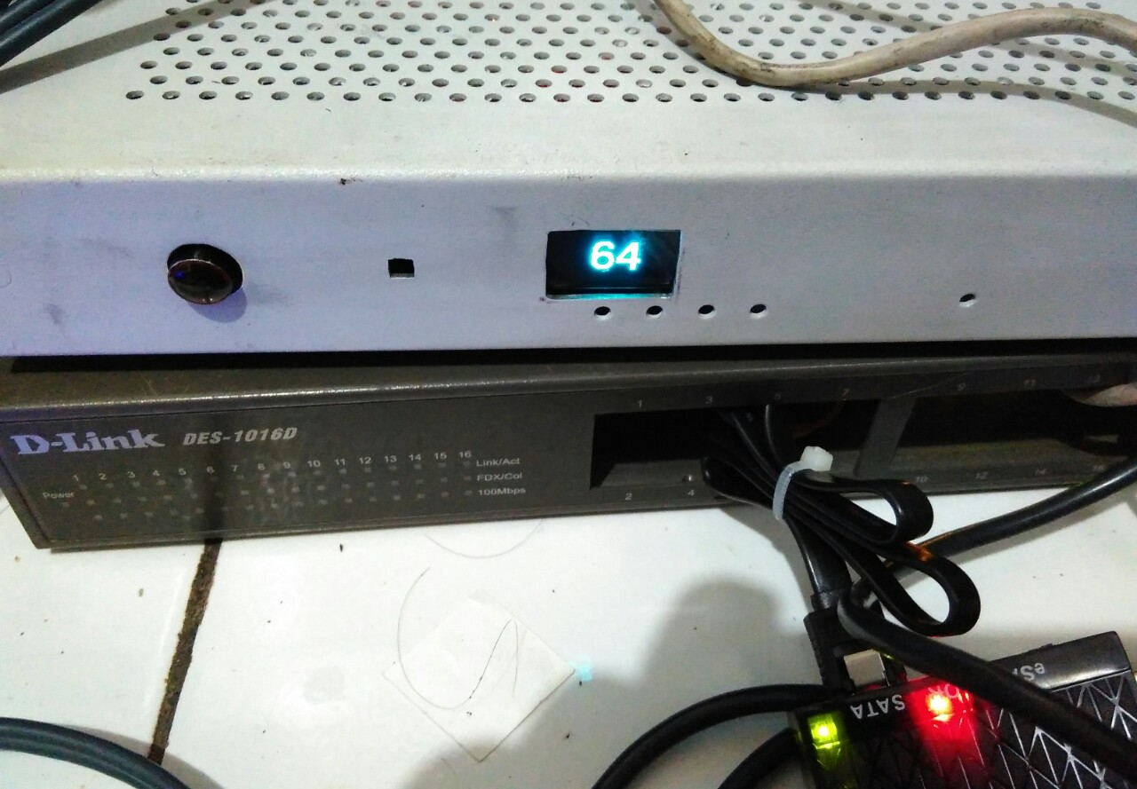

Still no luck
What is your DSD over PCM setting in MPD?
Looking at your screen grab, it looks like you have DOP set to 'yes'.
DoP (DSD over PCM) playback. This wraps DSD inside fake 24 bit PCM according to the DoP standard. Requires a DAC that supports DSD. No support from ALSA and the sound chip required (except for bit-perfect 24 bit PCM support).
https://www.musicpd.org/doc/user/dsd.html
I know, it look like dop is active, but i Set DOP to disable. Any other way to force to disable DOP?
If your DAC supports DoP then set it to 'Yes'
-Tim
-Tim
Aha! Logically it looks like you should do it the other way round. I don't have any dsd but just playing with a dsd-capable dac right now, so I should probably make one to try ou and see what the fuss is about
Aha! Logically it looks like you should do it the other way round. I don't have any dsd but just playing with a dsd-capable dac right now, so I should probably make one to try ou and see what the fuss is about![]()
DSD just another way to fill your HDD space
After looking at /etc/mpd.conf DOP set to yes change line usb_dsd to yes
If DOP set no -- usb_dsd change to no .
