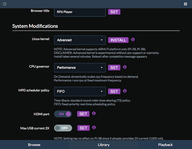

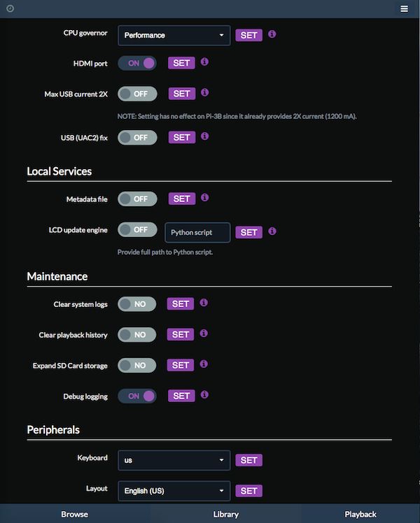

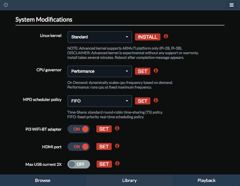

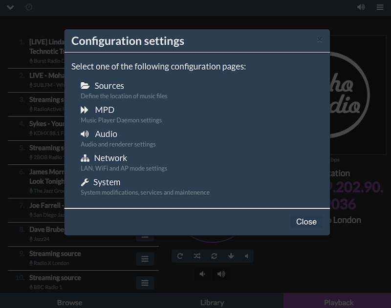

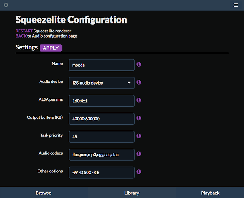

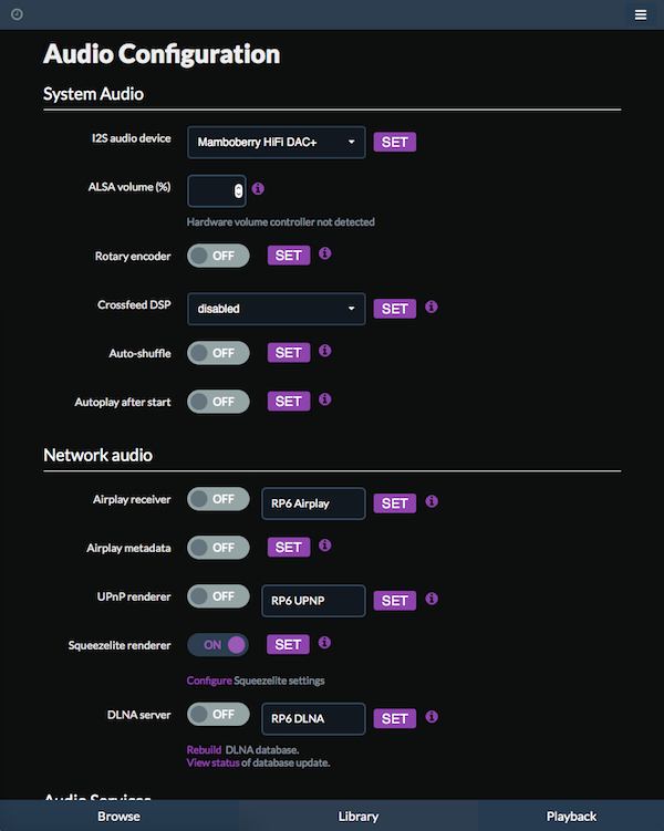

Attached screen shots show the new Moode 3.0 Audio config, Squeezelite config and System config pages. Thanks to inmate SC for the nice suggestions for improving the UI :)
Note the new setting on System config for CPU governor. Setting the governor to "Performance" runs the CPU at fixed max frequency. The default setting "On Demand" runs the CPU at varying frequency depending on load.
-Tim

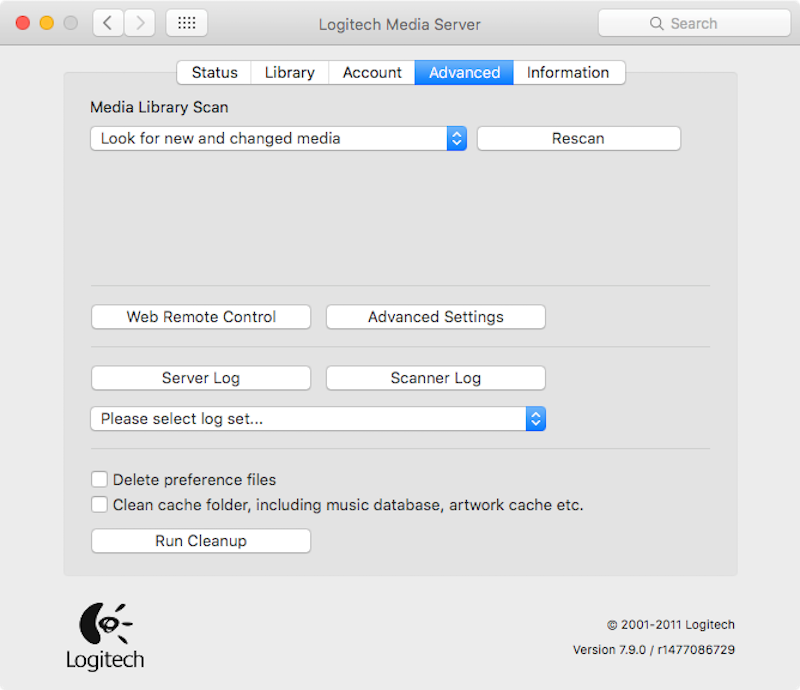

Hi Bob,

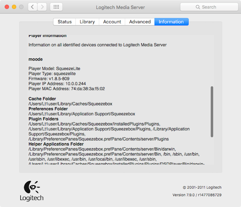

Here's a few screen shots showing LMS, LMS Web Remote, LMS info and Moode Squeezelite indicator.
LMS is running on my Mac Air.
-Tim

Hi Bob,
The Squeeze system is similar to UPnP A/V and Airplay but more powerful.
In it's simplest configuration:
- LMS is server and indexes the music collection
- Squeezelite is client and receives streams from LMS
- LMS Web Remote functions as the Player UI
LMS and Squeezelite can exist on the same host or different hosts.
There are other Remote Controllers for example iPeng for IOS and Orange Squeeze for Android.
Tim

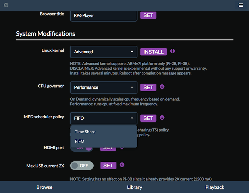

Real-time FIFO scheduling for MPD included in Moode 3.0 :)
This provides improved overall responsiveness and ensures that the audio pipeline in MPD is not preempted by low priority tasks. The FIFO scheduler runs on both Standard and Advanced kernels.
This feature plus the Advanced Audio Kernel and Performance CPU governor provides a great foundation for high-end audio.
-Tim
