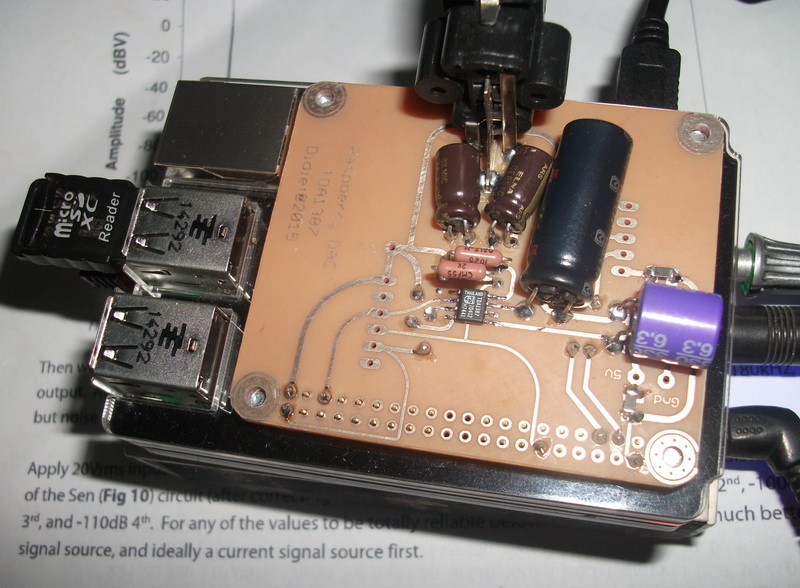

My issue i don't get anything on local display. I love seeing kernel loading :D
And i don't thing it hardware issues, my HW run normal with other OS
R-Pi 2 + DIY DAC + HDMI to VGA adapter. No UTP cable, so no Web Gui

Moode is headless music server with Web UI designed for access by Browser on Smartphone, Tablet, Laptop/Desktop over network. Local display not supported.
The only way I can think of to enable local display would be to install and configure a Browser on the OS then maybe it could work. The Browser would need to have Javascript engine and HTML5.
Just guessing :)
Tim

i think there is nothing wrong with moode config.txt , it just moode cannot detect my display on first boot. Because when i restart my Moode (without changing anything) by ctrl +alt+del i can see kernel loading.
HDMI_force_hotplug=1 just help my display :D

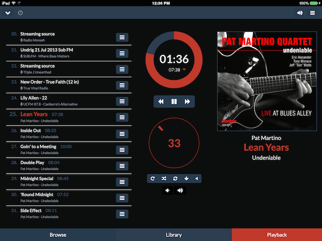

- NEW: Synchronized multi-room audio via Shairport-sync Airplay receiver
- NEW: Display album art embedded in FLAC and MP3 audio files
- NEW: Serve album art to MPoD/MPaD clients (url=http://moode)

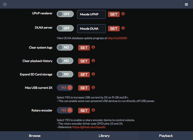

- NEW: USB 2x current setting for improved support of non-powered USB storage devices
- NEW: Automatic configuration of PCM5122 on-chip analog volume ctrls
- NEW: WiringPi GPIO interface for control of GPIO pins
- NEW: Rotary encoder and IR device device drivers from IQaudIO
