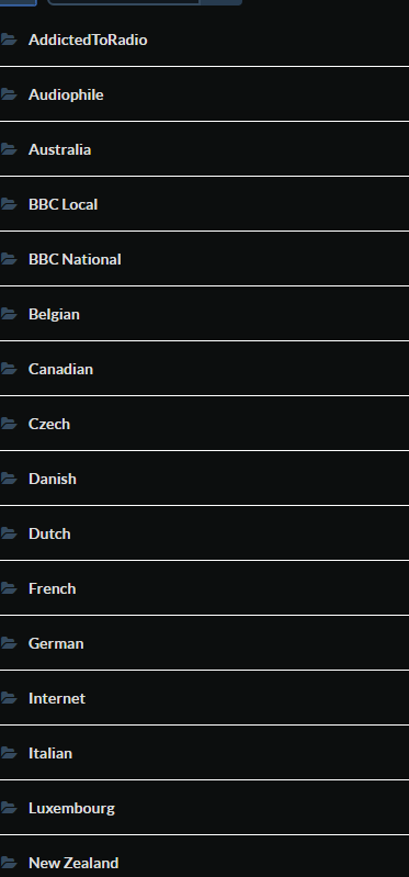

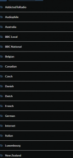

I still need to send to you the package, on my todo ;)
Here is an example of the grouping I'm testing for the Radio stations;
What do you think ?
What do you think ?
Hi Richard,
The challenge is that there are many possible ways to organize the station list that are equally good. How to decide?
An alternative to subfolders is to add metadata to the radio station sql table for example Genre, Country, Group, and then make a Library panel like screen. This would be a lot of work!
-Tim
