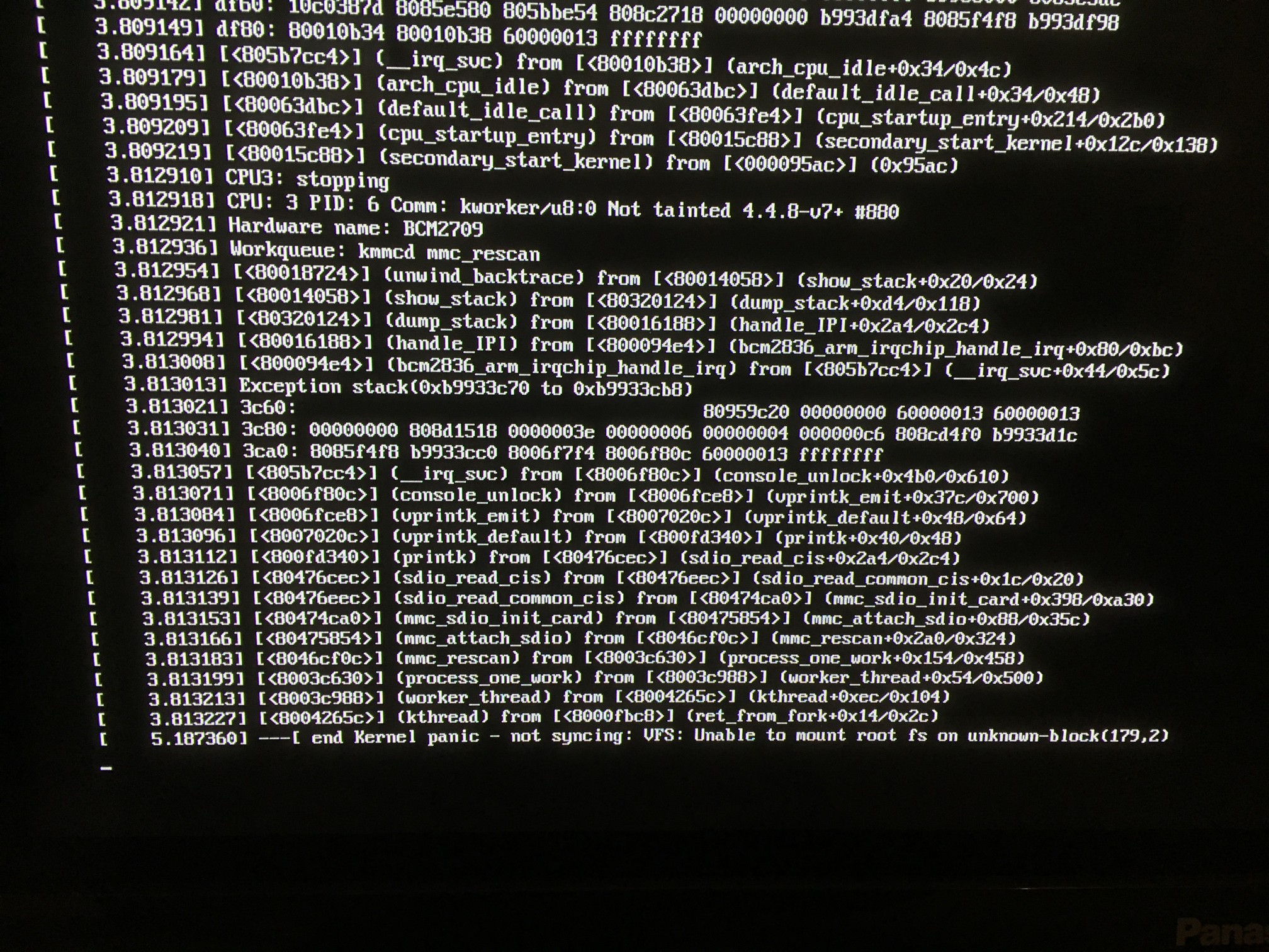

Hi, I used to have the R2 with the previous release of Moode and I liked a lot, I didn't have any problem until now, but now I bought the R3 and I downloaded the last release of Moode TR4 and I have some problem :(
The boot stop like in the photo.
Maybe I'm tired and it's just a stupid thing.

Looks like it could be a bad or corrupt SD Card.

Looks like a corrupted SD card image. Reformat and reflash the card, and make sure the OS you flashed it on has unmounted the SD card before you remove it.
Good luck.

I answer myself.
I did a stupid thing that doesn't need to explain :p :D:D:D

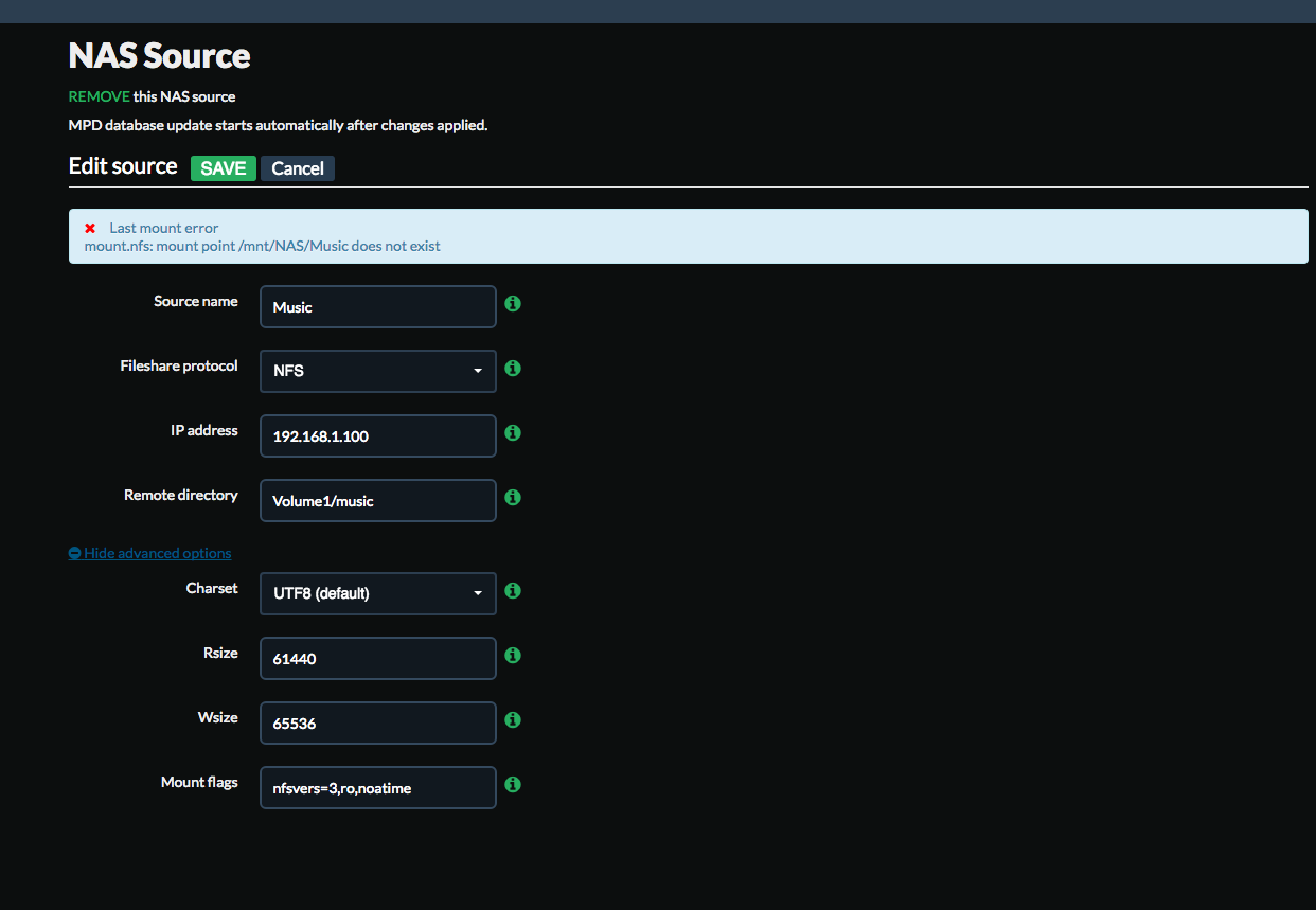

Setting up NAS with Moode
I new to the forum and Pi 3 world. I am not a coder or network guru by any definition just someone willing to learn. If I am going to solve the problem of connecting Moode music player with by music library it will be with the folks posting in this forum. Here is my setup:
Synology NAS
Mac book pro
Raspberry Pi 3 with Hifiberry DAC Pro
Moode Audio 2.6 TR4
Here is my Moode NAS setup screen with a typically red X and error message.

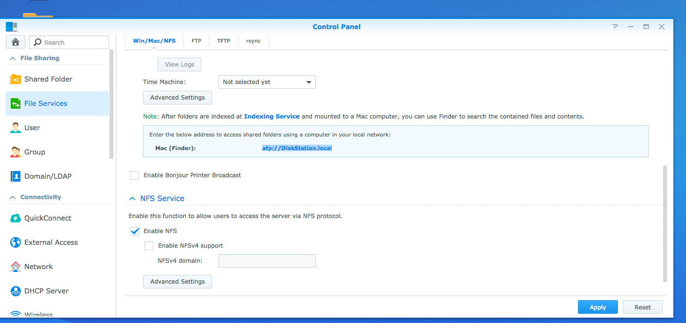

Also, attached a screen shot of the Synology NFS config
Any suggestions or ideas are greatly appreciated.

Try;"music" instead of "Volume1/music" in your moode nas config. Or "Volume 1/music". Note the space.

I use a couple of Synology NAS units and the below suggestions are based on my setup.
You do not seem to be using a Static IP address for the NAS - best to set that up first otherwise everytime it reboots the IP address MAY change. What router are you using?
Once you have done this then on the Synology / NFS set Client to * and tick the other two boxes.
On the RPi / Moode enter your new Static IP address and for folder enter /volume1/music.
