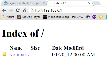

Took some pictures, I have a USB stick on router that I can access with ftp://192.163.0.1, usb stick is seen volume1, but when I configure NAS tried /, volume1/, sdb_JetFlash/ etc folder/directory, but does not seem to load properly. I also tried SMB rather than NFS without success.
am I overlooking something here?

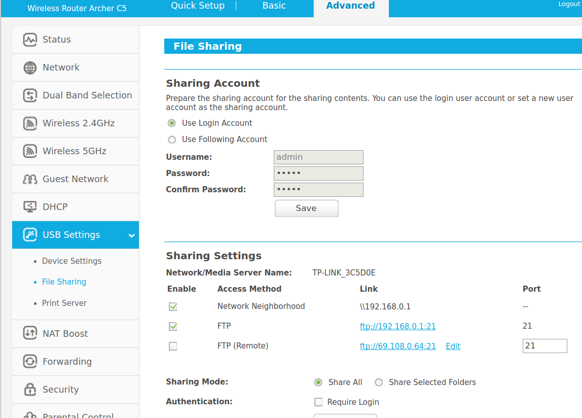

It's the file sharing tab in the router config whi h we need to see
the first picture TP-link with file sharing tab highlighted?, here is another picture of the "advanced" tab under file sharing.

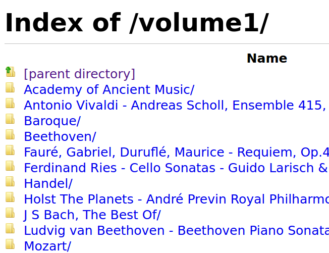

So if you go to \\192.168.0.1 on a windows PC what do you see? Ntfs might require sec=ntlm in advanced options in moode nas config.
Also, try path volume1 in nas config without slashes anywhere
Windows 10: backward slash does not work on cmd terminal or browser window , forward slash on browser windows brings up the router login page. ftp://192.168.0.1 on browser shows the USB folder as pictured. Under network it sees the router and moode installed RP2.
Right click on the windows 10 start button, select run, then \\192.168.0.1Windows 10: backward slash does not work on cmd terminal or browser window , forward slash on browser windows brings up the router login page. ftp://192.168.0.1 on browser shows the USB folder as pictured. Under network it sees the router and moode installed RP2.

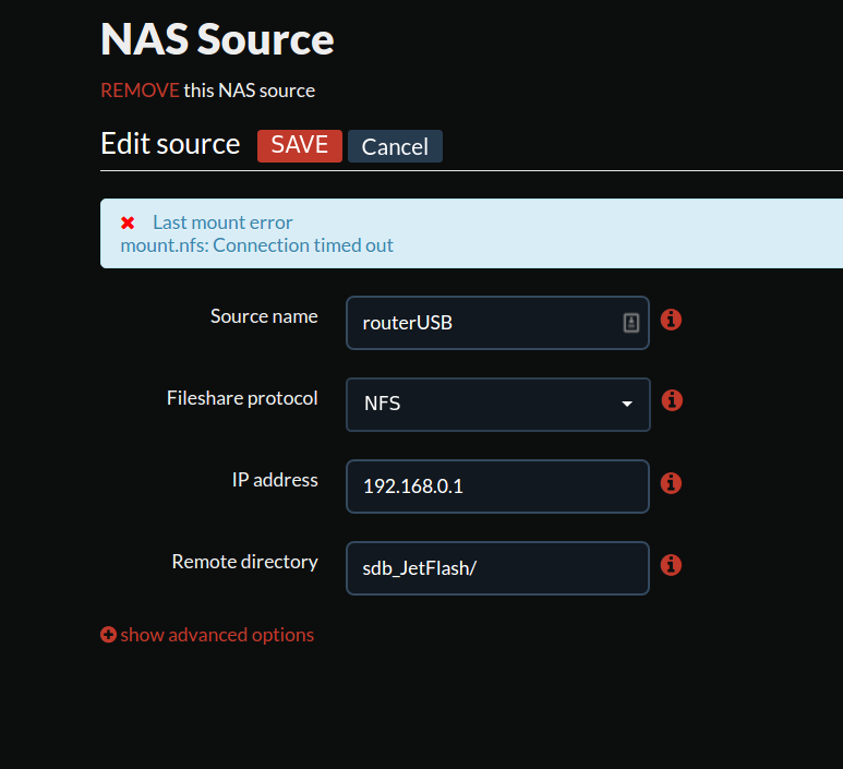

In a previous post (http://www.diyaudio.com/forums/pc-based/271811-moode-audio-player-raspberry-pi-306.html#post4715008), you shared a screenshot of the entire browser window showing the full path of the displayed index listing is "ftp://192.169.0.1/volume1/". That tells me your router is offering files via the ftp protocol.
Moode Player can be configured to access a NAS via either nfs and smb/cifs protocols. The fact that you get the "Connection timed error" is consistent with your router not being configured to offer either of these.
I'm unfamiliar with TP-Link products and their online documentation is sparse on technical details. The spec sheet for your router says "Support Samba(Storage)/FTP Server/Media Server/Printer Server". You'll need to figure out how to turn on samba. That's why philrandal asked you to show your router configuration, but I didn't see an appropriate option in the screenshot in your answer. It looks like something was cut off.
Other things being equal, once you succeed in turning on smb, I'd expect you to succeed with the remote directory entry simply "volume1", not "volume1/" or the other choices you show.

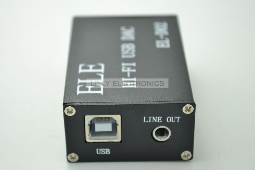

It's a USB dac, not i2s. That should point you in the right direction. It should just work.I have ELE EL-D02 DAC/amp using PCM2704 chip. I like to try this but not one of the listed dacs, under system conf-i2s drop down, should this be setup as a "plain DAC"?
thanks,
thanks,

I understand the feeling it's over your head. Once the stars are in alignment, though, everything "just works". Thanks to Tim with his software and the HiFiBerry folks with their line of DACs, I finally have an incentive to rip my entire CD collection to flac files. For the time being, the results are being served to my several Moode Players via my ASUS router. Down the road, I may have to move to a stand-alone NAS with expanded services and greater throughput (there are all these DVDs on hand too!) but the router is good enough for now.
Basically, we're trying to split your problem into two parts.
1. make sure your router is serving a music folder (e.g., file directory) to your network using one or the other protocol Moode Player can understand.
2. make sure your Moode Player is configured to access this music folder.
(I'm ignoring the possibility of basic network connectivity issues since you are able to see this router from some other host on your network, but if push comes to shove this can be addressed too).
If you get the itch to try again, I found a "how to" which seems to cover using your router (TP-Link Archer C5, right?) to share a folder on a USB drive via the smb protocol. See How to setup and provide access to your local storage drive with the Archer C7/C5? - Welcome to TP-LINK . The trick seems to be to check the box labeled "Enable Media Sharing". See Step 5 in the how-to. This is different from enabling ftp access.
Once you've done that, you can try the diagnostics which philrandal suggested. See Step 6 in the how-to for a restatement of these in terms of test hosts running Windows, MacOS, and Linux.
If the diagnostics are successful, then move on to configuring Moode Player to access the folder being shared. The trick here is to be sure your "Remote Directory" name in the Moode settings is the same as the "Share Name" in your router settings. With my ASUS router, this name is necessarily the same as the name of the folder being shared from the USB-drive ("Music" in my case), but the TP-Link how-to implies you could set a custom share name.
Good luck and good listening!
Kent
PS - Candidly, I think TP-Link's documentation needs work but maybe that's just me. I don't have one of their routers to play with to sort it out.
