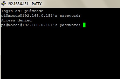

Just a friendly repost
Moode 2.6 Test Release 1 (TR1) is available for download at moodeaudio.org under the TEST CODE button.
...SSH logon is now pi@moode (pwd=raspberry). Preface all cmds with sudo
Enjoy!
Tim
Hi Tim,
I can't logon by ssh by provided information, Access denied, pls assist.
BR
Hi Tim,
BR
Post the error message.
-Tim
-Tim
I used putty
I used putty
I tested PuTTy on my end from a Windows 7 PC using pi / raspbian and no issues.
-Tim
