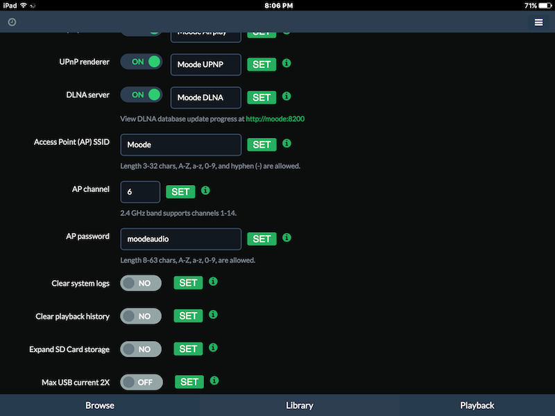

Just a brief update on moodeOS 1.0 and Moode 2.6.
I've been testing Access Point (AP) mode and am planning to include this as a new feature. It's completely automatic i.e., there is no ON/OFF setting but does have three settings in System config that can be changed. Defaults listed below.
SSID: Moode
Channel: 1
Password: moode
It works as follows:
- Network config has to be at OOB default of eth0 or reset to default eth0 via the Network config screen.
- Plug in an AP capable Wifi adapter and reboot
- Moode will auto-configure AP mode
- From any Wifi capable client select "Moode" from the list of SSID's
- Enter "http://moode.local" in Browser

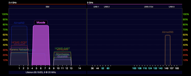

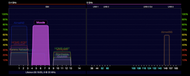

Here are some screen shots of the completed Auto-AP mode feature for Moode 2.6 The signal strength graph is from Wifi Explorer util.
Tim
