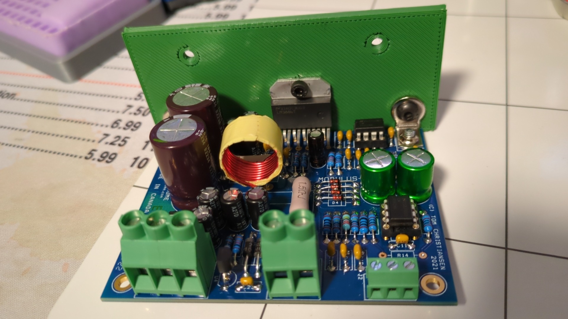

My Modulus 86 all wired up, plugged in... shoes on, hand in pocket, wife nearby....fuse in Front LED on, no smoke measured +/- 35V, still no smoke.
I will call that a success thanks to a good video (and emails) from Tom.
I'm giving myself a pat on the back for wiring up the power LEDs in the right order (orange-blue / standby-on)
Tomorrow I will wire up to the speakers. Wish me luck.
So the instructions from Tom resulted in a fantastic afternoon of listening to music on my new modulus-86. Amazingly it worked first time, DC offset as expected, sounds great. Thanks to Tom for answering my pretty rudimentary questions and supporting throughout! My electronics background is limited so thats a testament to the instructions and guidance.

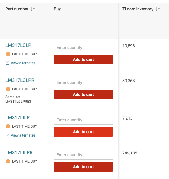

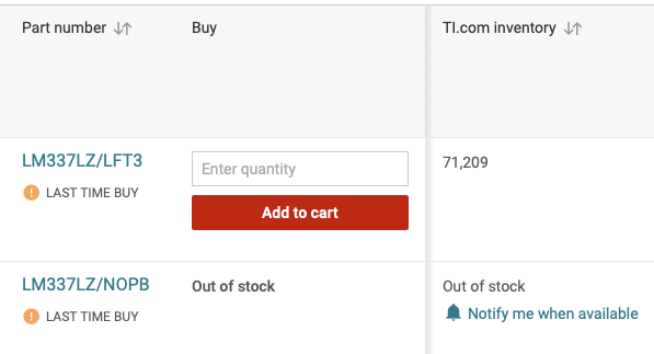

In other news. TI has quietly discontinued the TO-92 versions of the LM317L and LM337L regulators used in the Modulus-86. It looks like the surface mount options get to continue. The TO-92 version of the LM317L is made by other manufacturers as well so that's no issue, but the LM337L in TO-92 is TI-only. So that's a bit of an issue for the Modulus-86.
I'm not one to cry "the end is near!" but in this case the end could be on the horizon.
I see at least a couple different ways of dealing with this:
Anyway. Those are my thoughts this morning. I'm currently leaning mostly in the direction of buying a lifetime supply of the ICs so I can keep selling kits for another year or two. But the other options have not been ruled out either. And right now there's no need to panic. When TI announces a lifetime buy they usually give their customers a year or so to order before the part becomes obsolete, so here's still time and still parts in stock.

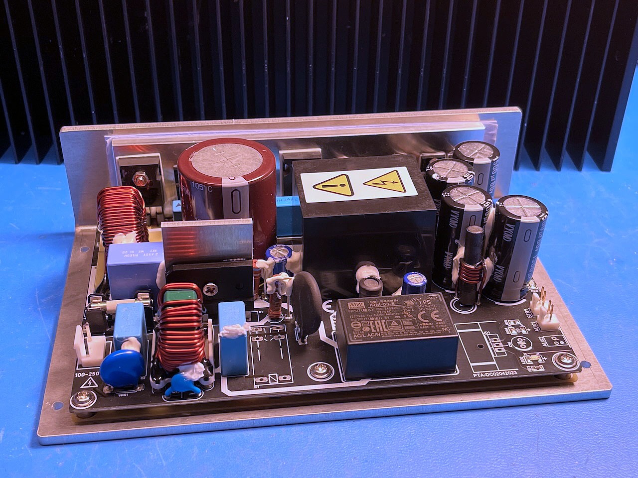

Any updates on this...Look what just landed on my lab bench (pardon the crappy colour balance in the picture). Thanks Sami!
This is the real deal! It certainly presents itself as a professionally made product. I'm looking forward to testing it.
Supposedly it'll deliver 400 W continuously. It also features power factor correction. Oh, and Sami also verifies the EMC compliance to EN55032 Class B and electrical safety to EN62368-1. I'm pretty stoked about this. I hope that the supply performs as well as it looks. If it does I might consider buying a stack of them and have them for sale in my store.
Tom
I'm impressed so far. The over-current limit kicks in around 8.7 A. It's a pretty soft limit. There's also the option of adding capacitance on the output, so I think this will be plenty for an audio amp. I would like to evaluate it with the Modulus-686 before committing to a large order of them.
I ran it for 20-30 minutes at 180 W and it got a little more than lukewarm (45 ºC).
If it works well with the Modulus-686 and Sami can make a version that's adjustable from ±30 to ±36 V I could potentially see carrying them as a product in my store. The supply I have covers ±32 to ±38 V, so extending the range a bit shouldn't be a show stopper. I just need to verify that it works with the MOD686, but I have a few other things on my plate these days as well so I can't promise that I'll get to it immediately.

Not very. But some refuse to touch surface mounted components of any kind. It's just outside their comfort zone.How hard is a lm337 to solder in a SMT version? I am not opposed to having to solder SMT components.
I could use the TO-220, 1.5 A versions: LM337 and LM317. I really don't like having those stand up straight without support, so I'd probably lay them flat on the board. This would increase the board area, but at least they'd be all through-hole and DIY-friendly.
