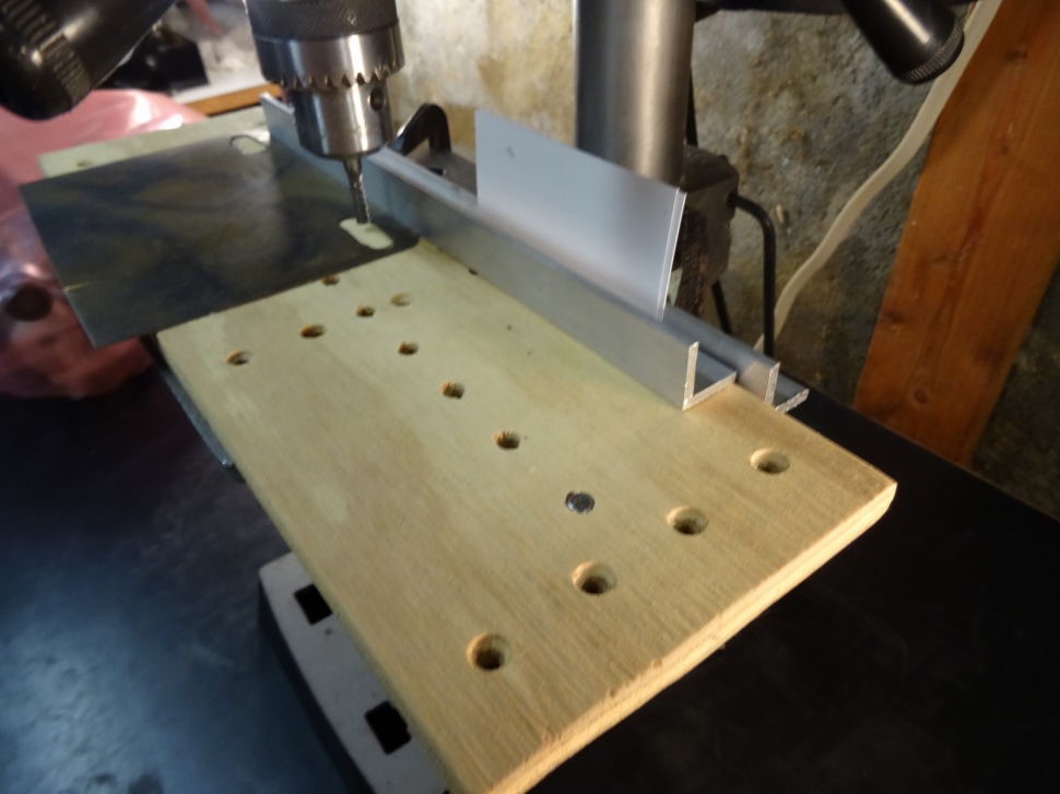

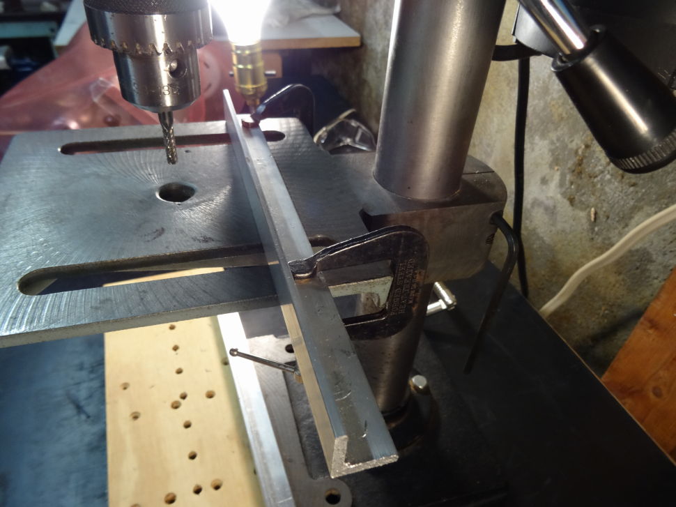

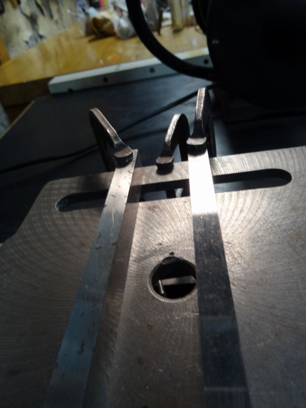

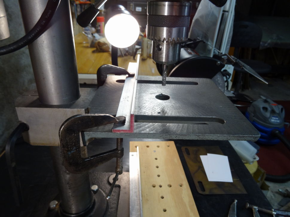

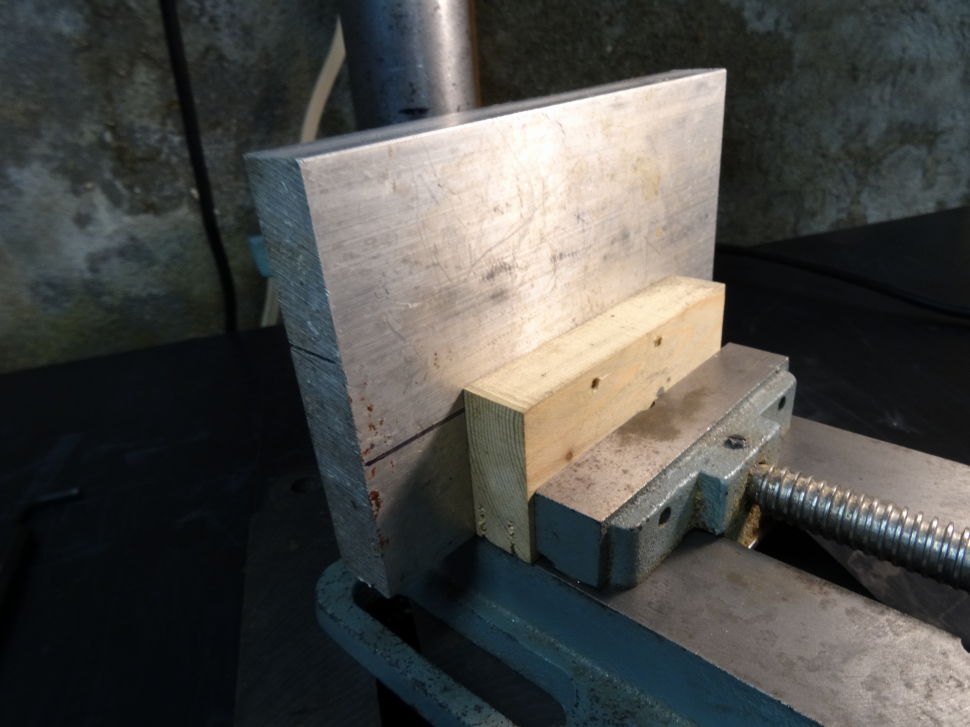

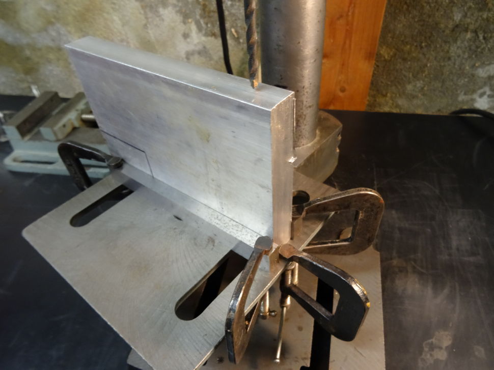

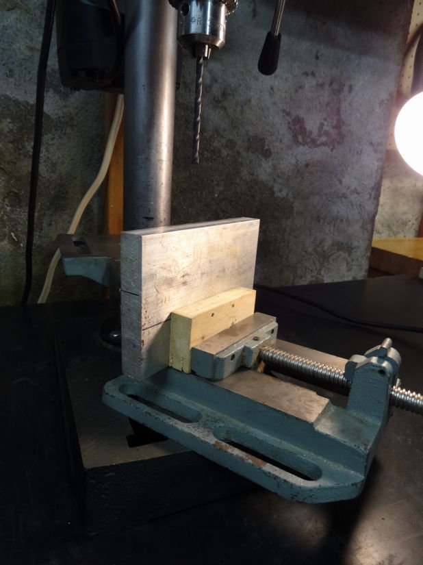

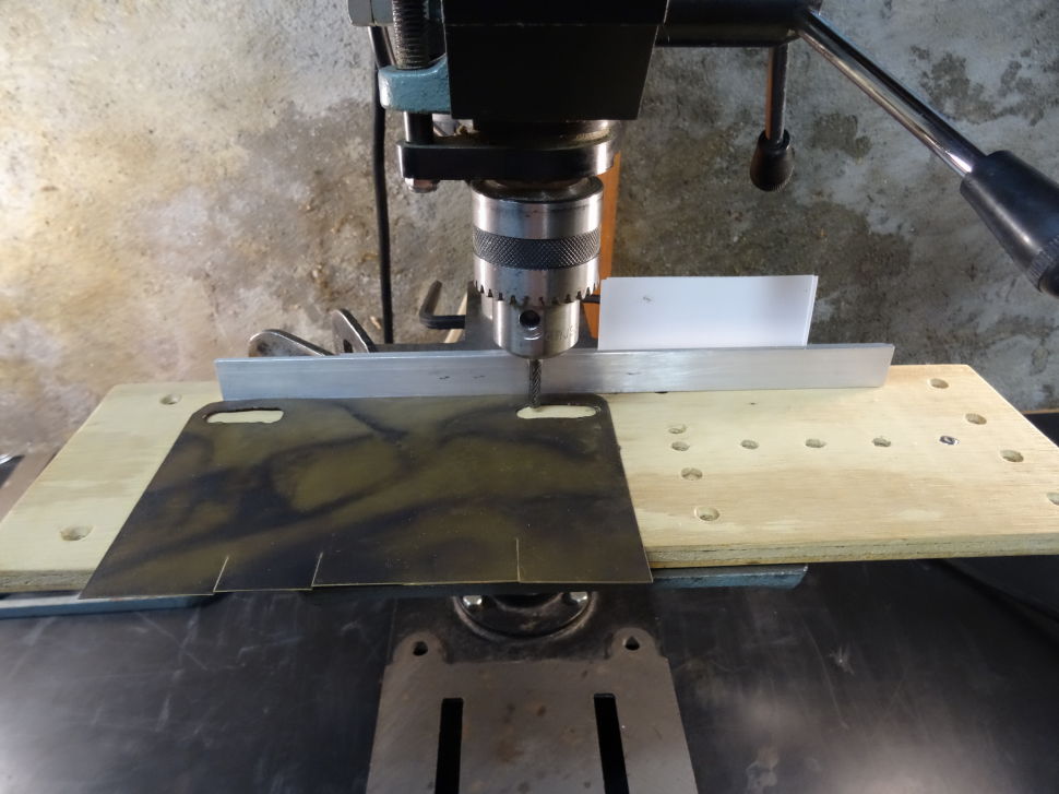

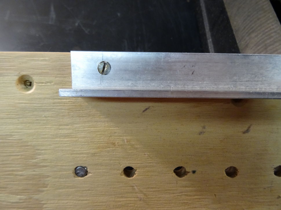

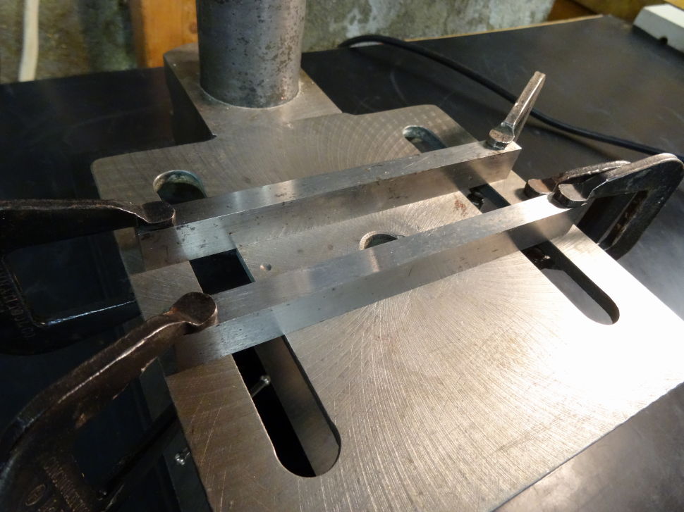

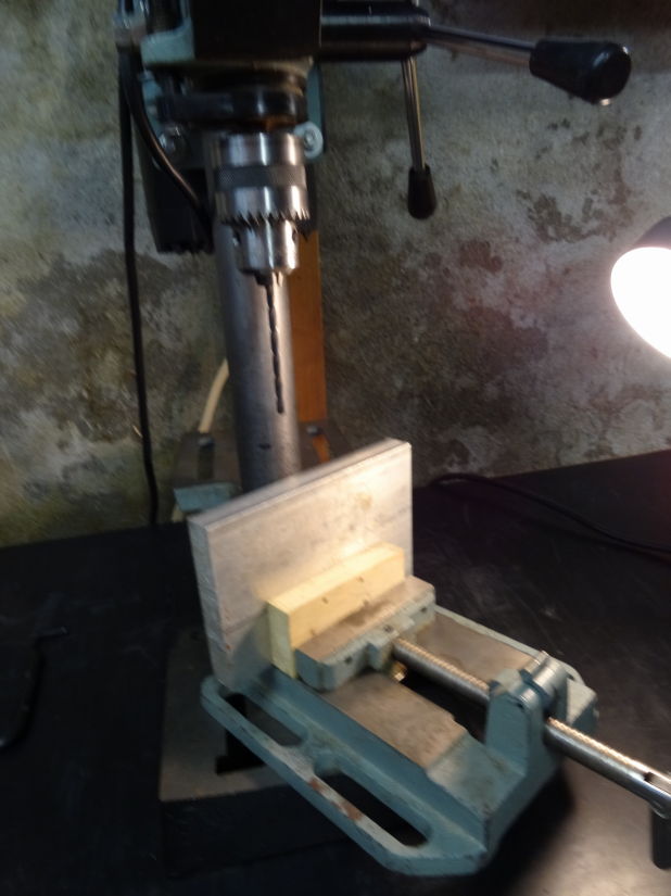

Here are two different heat sink drilling setups. The second setup uses two parallel bars and five C clamps with the 5th acting as a positioning stop for the heat sink. Use your hand to apply downward and towards the stop pressure on the heat sink while drilling to keep the heat sink against the stop.
Tom:
Many thanks. I knew about drill press hold-downs but will do a bit more research to select ones that fit on my relatively small drill table.

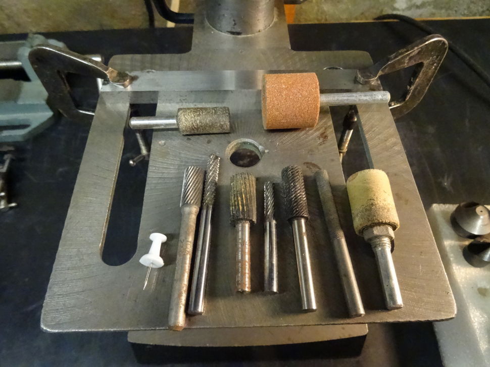

Upon reflection, I think I will try to use some kind of grinder - perhaps the Dremel again with a cylindrical grinding stone or sanding cylinder. I wish I had enough knowledge to use a trim router - that might do the trick.

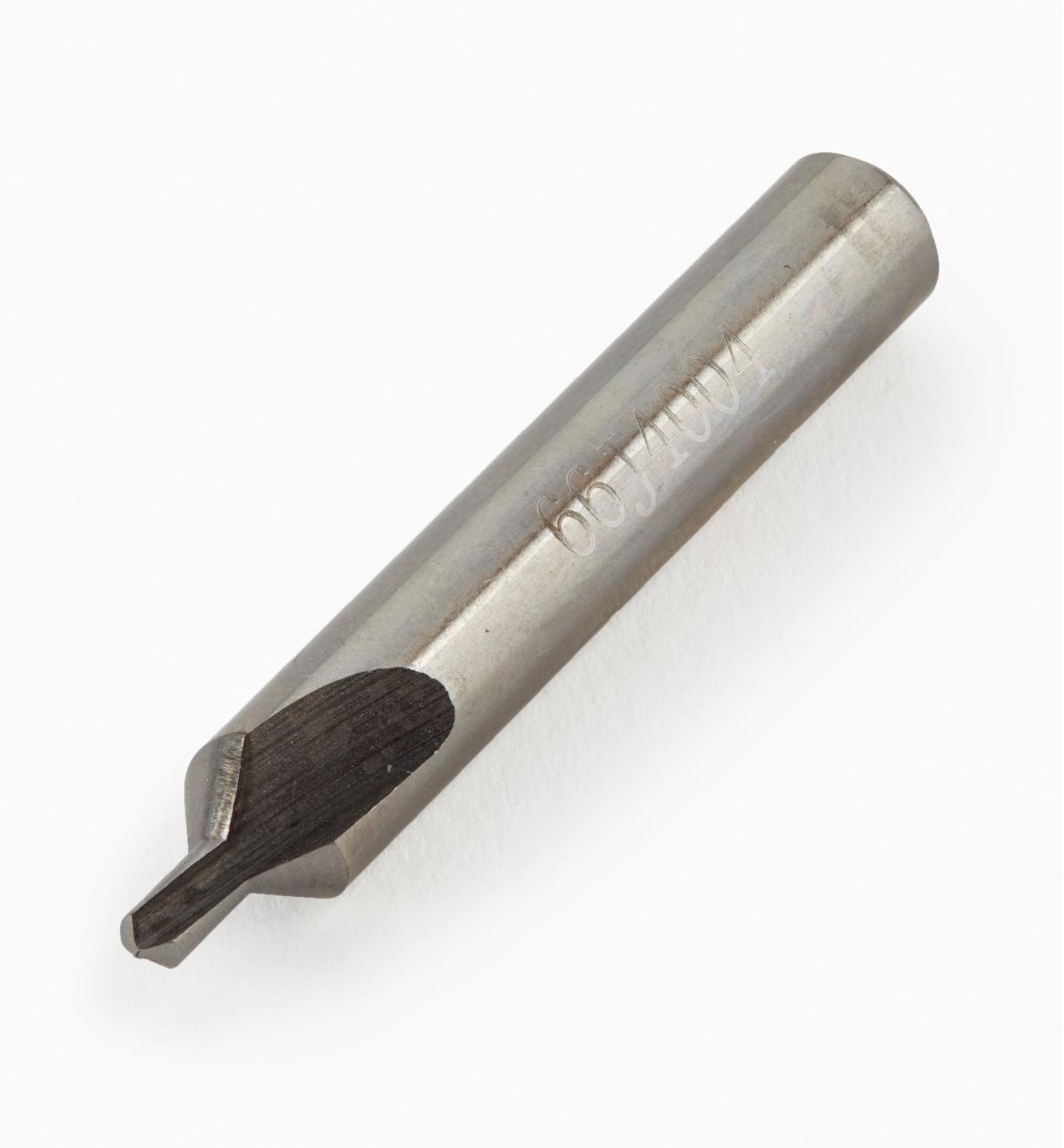

I find a small drill bit tends to wander too much. Maybe a small centering drill would work.

If you have a Dremmel I would imagine that you can find a bit that'll work for breaking the connections between the holes.

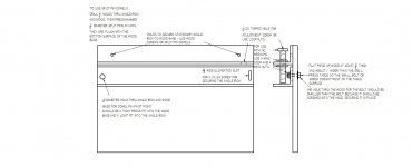

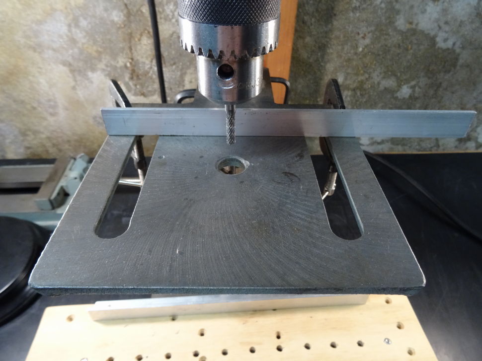

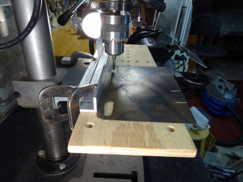

Occasionally I’ve used my drill press for deburring. And while drill press spindle bearings are not optimal for side loads I’ve had no problems. The setup is simple and only requires two pieces of angle iron or any straight edge, a flat piece of wood and three C clamps. To make the part holding fixture secure the straight edge to the piece of wood. C clamps would work but drilling a hole near each end so it could be screwed to the piece of wood is neater. Two clamps will secure a straight edge to the drill table and one clamp will secure the fixture to the drill table. The fixture does not require any special alignment.
The following process replaces only the filing with light deburring.
Secure the cutting tool in the chuck. Place one straight edge on the drill table. Position the back edge of the fixture against that straight edge Place the piece to be deburred on the fixture with one edge against the fixture straight edge and move everything together such that the end of the cutter is the very close to the edge to be deburred. Raise the table until the end of the cutting tool just touches the wood. Lock the table in place.
Use two C clamps to secure the table straight edge. Secure the fixture to the table with one C clamp at either the left or right side.
Think of the clamped side of the fixture, where it contacts the table straight edge, as a pivot point. So slightly loosening the clamp and pulling the other side of the fixture away from the table straight edge is like a very slight rotation that increases the depth of the cut.
With the fixture against the table straight edge slightly loosen the fixture C clamp and pull the other side of the fixture away from the table straight edge to bring the highest point of the edge to be deburred in contact with the cutter. Only make very light cuts. Now tighten the fixture C clamp and slide the part, along the straight edge, to a position where the cutter is not in contact with the edge to be deburred. While holding down the work piece, start the spindle and slowly slide the work piece back and forth until the cutter is no longer removing anything. The first pass is now done.
Now, with the cutter still running, slightly loosen the fixture clamp and gently pull the other side of the fixture away from the table straight edge to take a light chip about the thickness of a business card then place the card between the table straight edge and back of the fixture. Push that side of the fixture against the card/shim and tighten the fixture C clamp and repeat the material removal process as before. Repeat the process adding business cards or any other shim material for subsequent passes. Repeat this process until the edge is as smooth as you like.

Great Photos
@heryrljr:
Thank you for your explanation and especially the time you took to take the photos! I am looking very carefully at the photos and now can grab your approach, which is very clever. Thank you so much for this.

Henry: That's an excellent method. Thanks for sharing. It seems 99% of machine shop work is setting up the jigs.

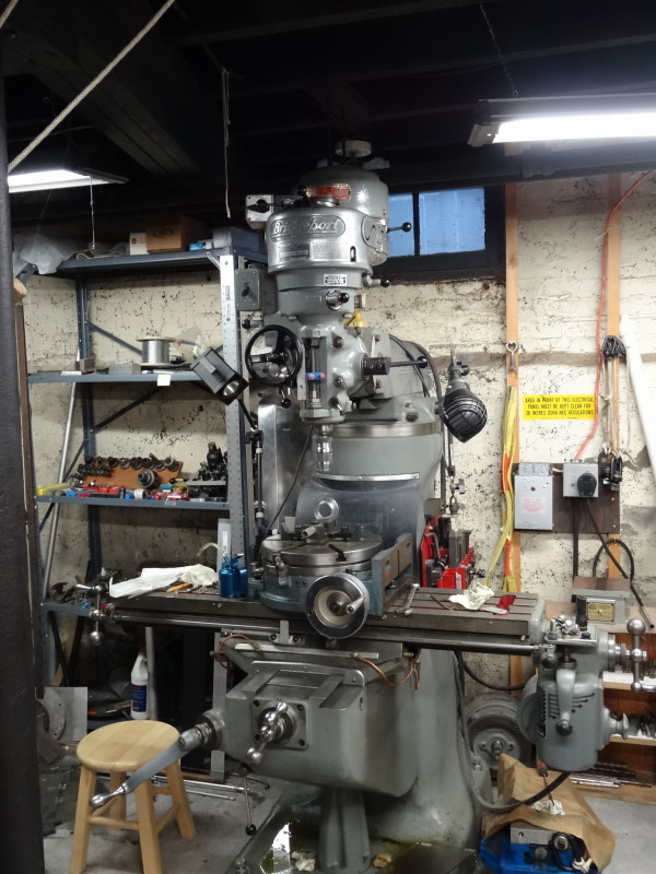

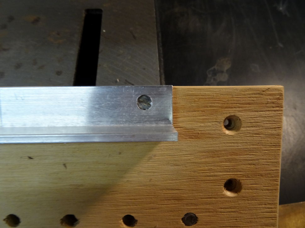

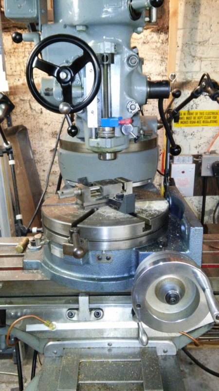

While I usually do most work on my bridgeport, if I only had a drill press this is how the fixture would look. By using split pin dowels and the wing nuts, including two on the 1/4-20 adjustment screw no tapping is required and no wrenches are needed. The hole for the adjustment screw may need to be closer to the top edge of the angle iron to allow use of wing nuts.
Great. Now I have milling machine envy... It's probably a good thing I don't have the shop space for one.

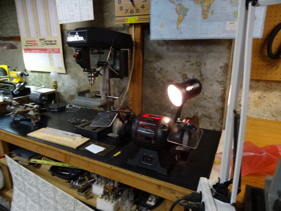

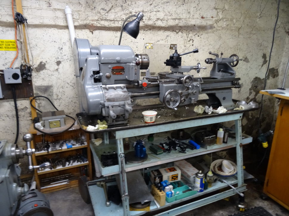

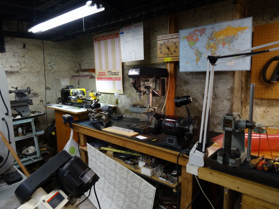

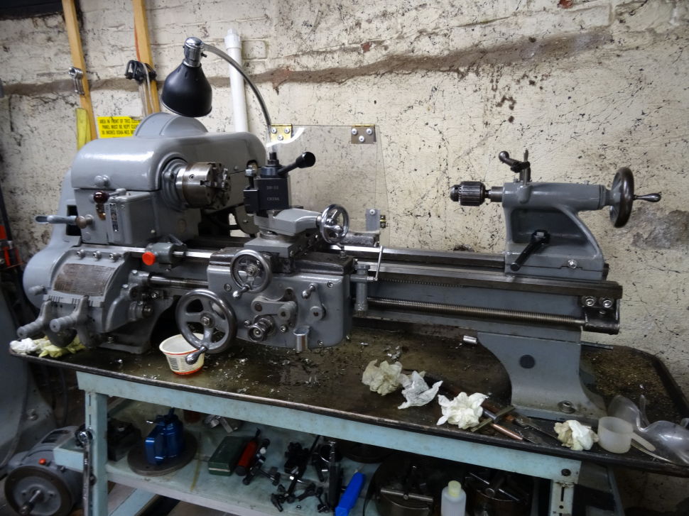

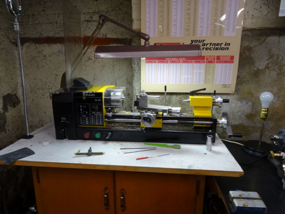

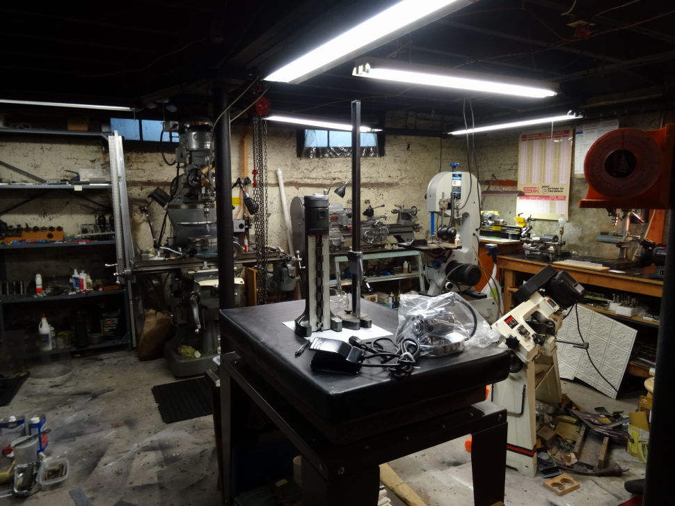

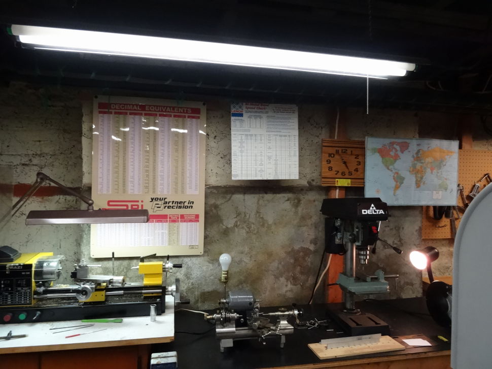

This is my playground. Well it was actually a home business where I did repair and custom work in all metals from A to Z, as in zirconium. I also designed, made and sold a few titanium clarinet tuning barrels and flute stoppers in titanium, niobium and zirconium. I also did design and make of prototypes working with folks with ideas for a patent. I mention this because I still except accept small, interesting jobs. I charge $30 per hour + cost of raw material and cutting tools.
For those needing super accurate work, my granite surface plate is flat wi/in .00005 based on calibration. I have dial indicators with divisions from .001 to .00005. Its just a bunch of great toys. And I have compound and single leaf sine plates accurate wi/in .0002. I've done several jobs for one of the largest aerospace companies, more than $30, requiring tight tolerances.
