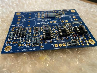

Hey everyone!
I have recently purchased some Modulus-86 boards from Tom (whom of which has been super helpful, thanks again Tom!) and just wanted to share some build pictures here. I'm about halfway done with one of the boards:
Best,
Kaden

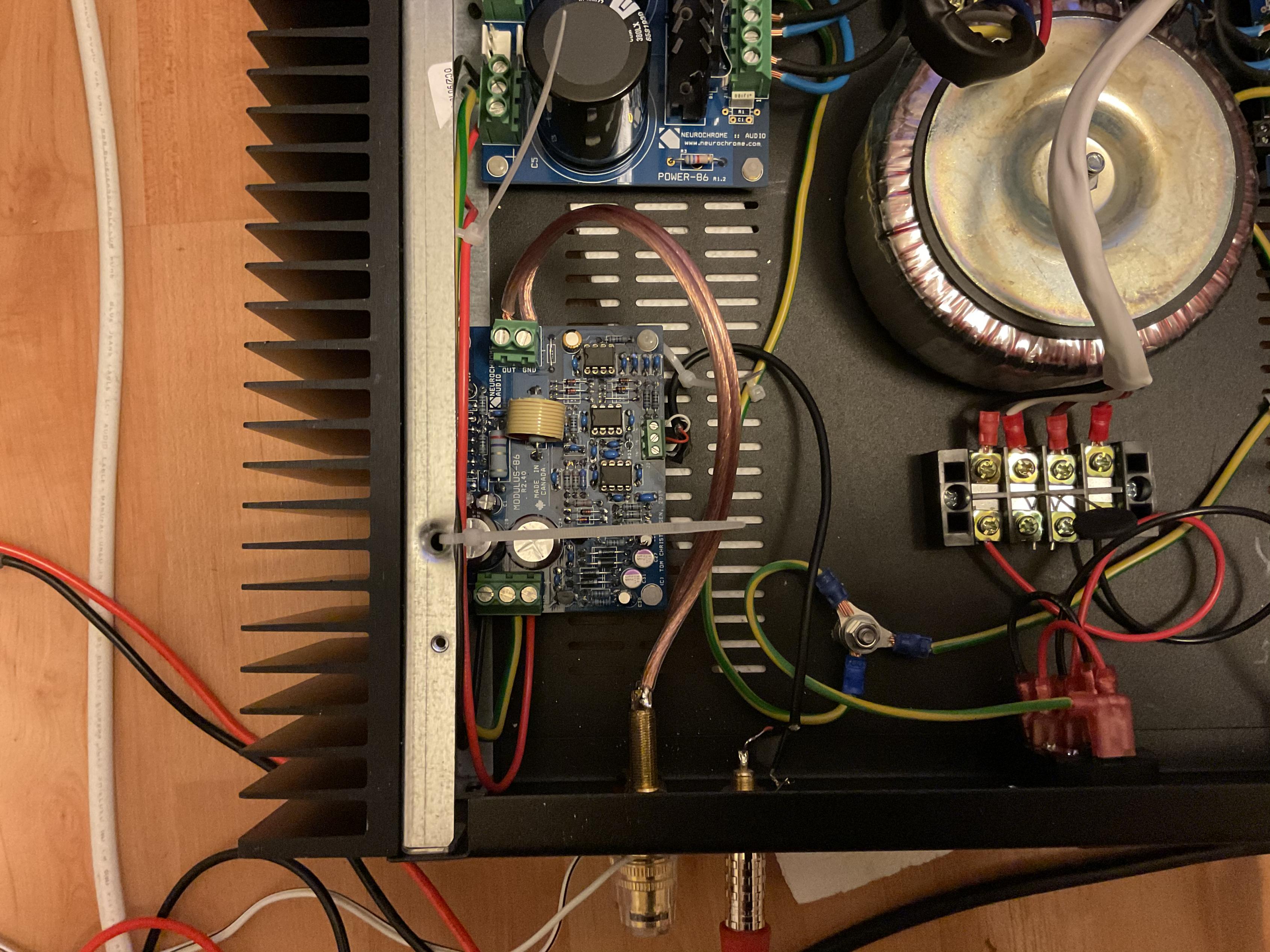

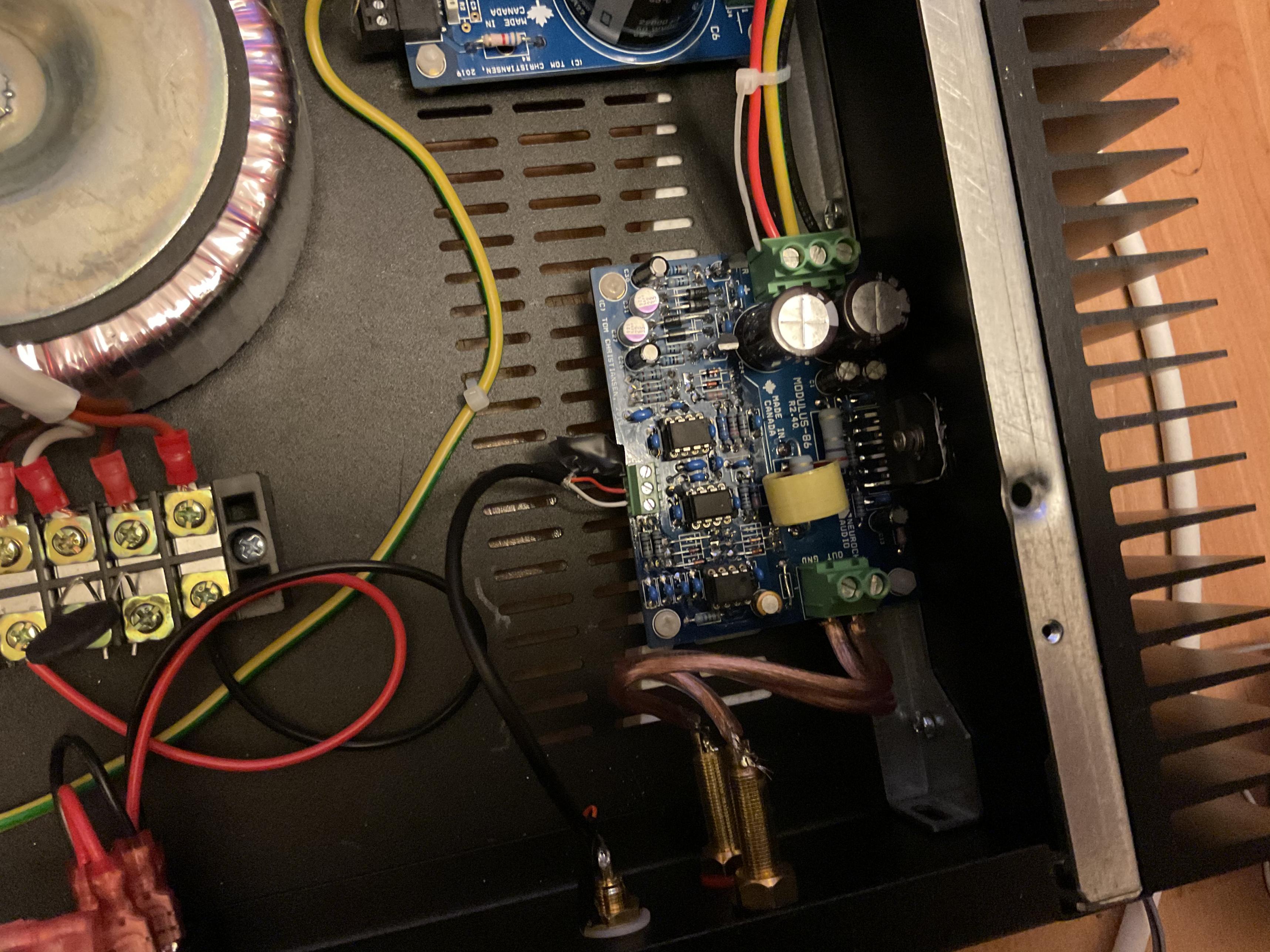

Hi Tom, I just finished assembling my mod-86.
powersupplies measured as expected. Finished connecting and turned on with lightbulb inline. no problem, all seemed nice. connected to my aikido tube pre and small car speakers I use when starting builds for the first time. got small sparks from audio input at the print both channels. Turned off. Cheked all connections all seemed ok. Turned on again, no sparks, no sound, no smell but ICs got hot. Turned off again. Cannot quite see what is wrong.
