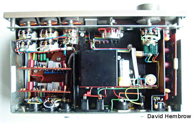

A fond memory of my first serious separates system - QUAD 33/FM3/303/ESL57, was the user adjustable phono and tape level plug-in “adaptor” PCBs. The line level buffer and phono EQ circuits were also on plug-in boards but they required removal of sleeve to access. While the use of space saving DIN signal connectors and the rather limited functionality of the 33 wasn’t to everyone’s taste, and the low output level required to match the 303’s input sensitivity reduced its compatibility with other brands, I always considered the quirky little pre-amp to be quite a fun piece, and certainly never hurtful to listen to. By comparison the Aerospace grade designed AGI511 or earliest Dayton Wright sounded more than a bit too glassy and “detailed” for my taste, and where the first hint that specs don’t tell the whole story.
