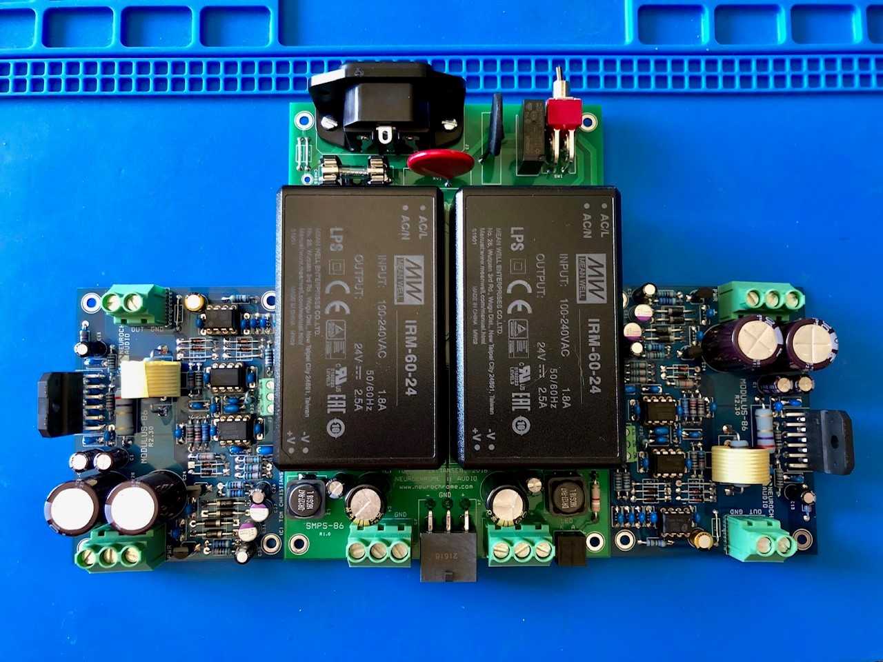

Boards stuffed ... need to pick a chassis next! Thinking Mini Dissipante will fit the bill nicely.

It's good to see a build shaping up. Nice work so far.
Yep. 28 W into 8 Ω with the SMPS-86. 28 W into 4 Ω too (the IRM-60 reach their current limit). For a desktop amp or an amp intended for powering efficient speakers, the SMPS-86 is plenty - especially with 8 Ω loads. If you have 4 Ω speakers and tend to really crank on the volume knob, you should consider using two SMPS-86 so you have enough output current available.
