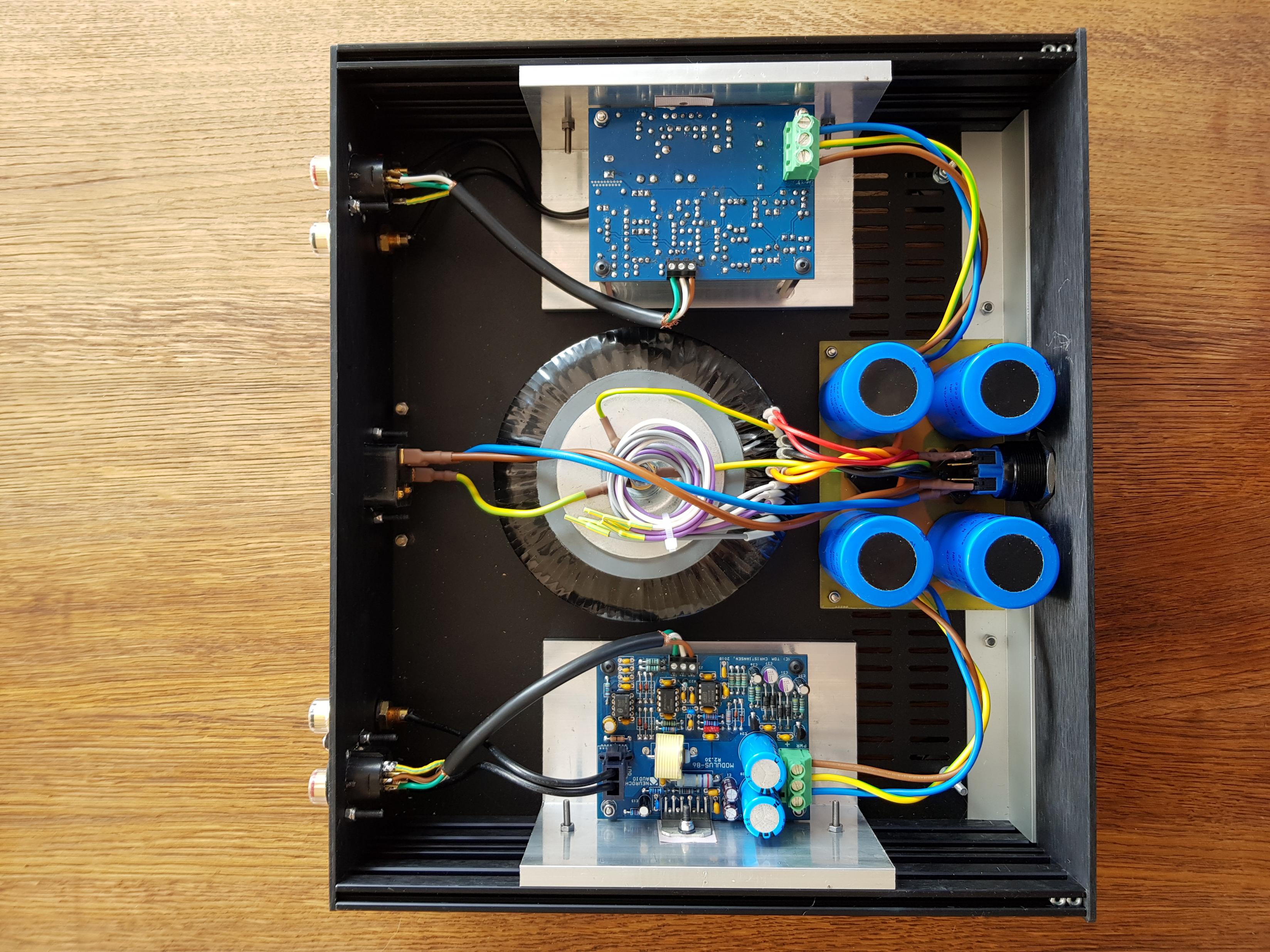

It's usually better to attach the images. That way they stay on the forum for everyone to see even after you delete them off your Google Drive. Click "Go Advanced" and then the attachment "paper clip" button. I've attached your image here.
Nice and clean build. Well done! I like the use of aluminum angle extrusions to make a module out of the Modulus-86. Who else does that? ;)
You're very low on heat sinking; i.e. there isn't any, aside from the chassis itself. For a small desktop amp that'll never deliver more than 100 mW or maybe 1 W when really cranked, you're probably OK, but if you were to use the amp at a house party cranked to 11, the amp will overheat. With the amount of aluminum in those angle extrusions, it'll take some time to overheat, but it will get there. For short bursts at max power, the thermal mass of those extrusions will keep the amp happy as long as the average power is low.
I do like the idea of mounting the terminal blocks to the back side of the board as you did on the right channel. That's a neat trick for those who want a symmetrical build. Thanks for sharing.

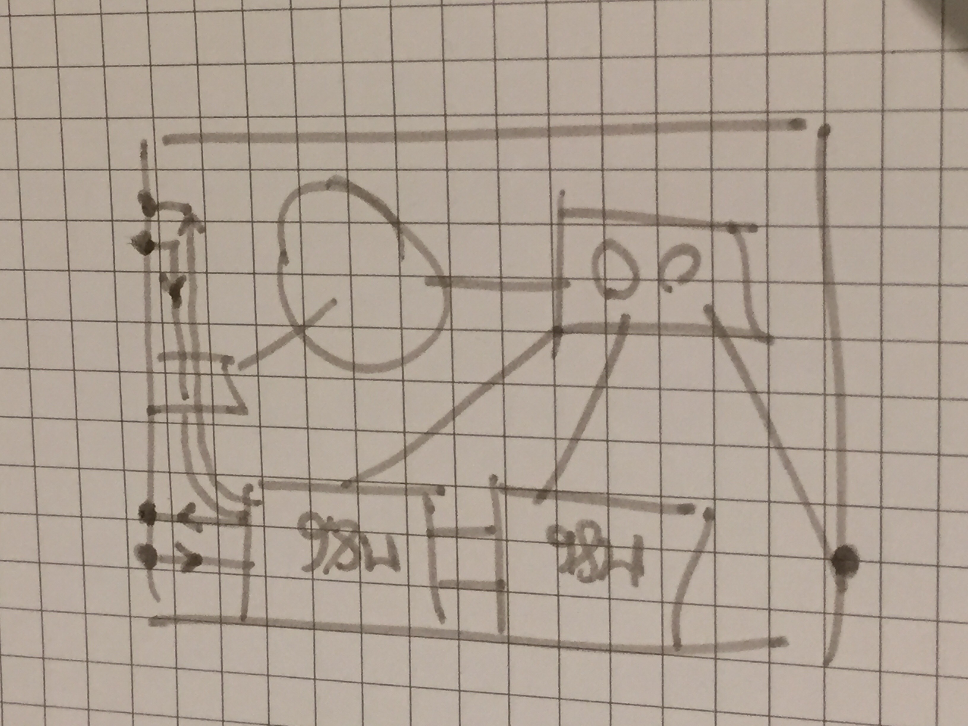

Can you put the stereo purchase option for Modulus 86 and do the Mirror finish PCB for L-R channels?
I'm curious what drives this need. Would you mind elaborating? What are you trying to accomplish with the mirrored PCBs? Are you going after this purely for aesthetic reasons or do you have a technical reason for pursuing this?
As mentioned above, I will not make a mirrored version of the Modulus-86 board as doing so would negatively impact performance. But if there is a technical reason or you're pursuing the mirrored version for a reason that I'm not aware of, there is the possibility that I could meet you half-way. Would placing all the connectors along one edge of the board be sufficient to meet your needs?

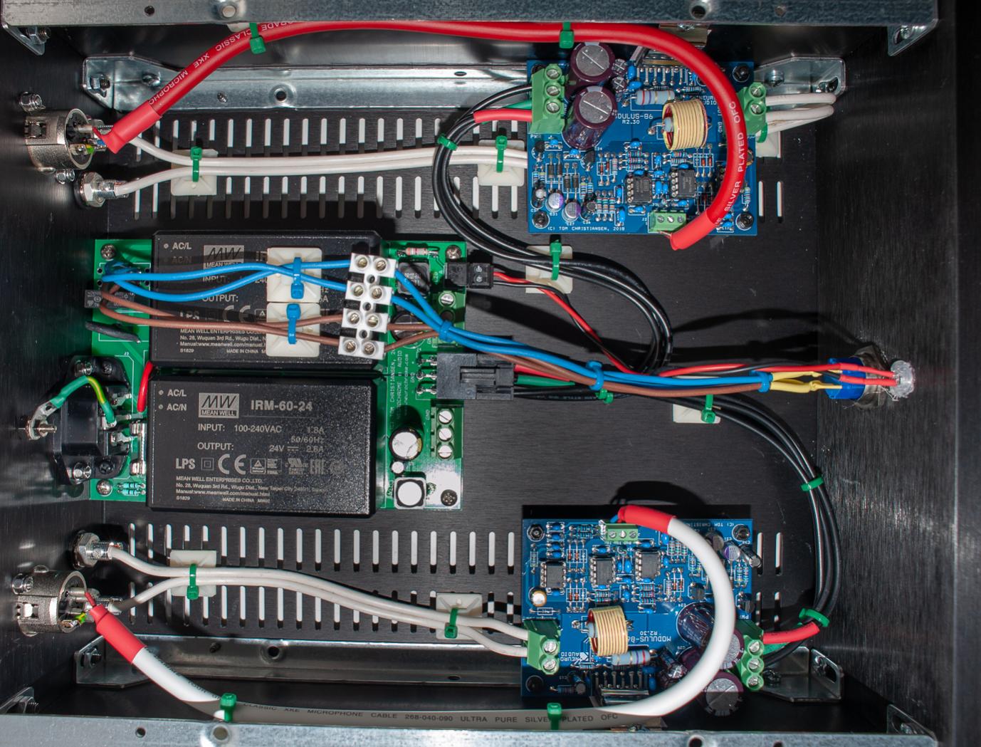

For the reference. Just another way of building Mod-86.

Maybe my eyes are deceiving me but I would not connect chassis ground to the center of the transformer bolt (your yellow wires with brown heatshrink). This becomes especially concerning if the transformer center bolt becomes loose. If it does, you've lost chassis ground connection and that is dangerous. Perhaps I am conservative but I certainly don't want you to get hurt!
The chassis ground connection should be separate and isolated on the chassis and it is recommended to use a locknut.
Here is a good example, although, I would minimize the use of regular nuts and just use washers/tooth washers and locknuts. You want the lowest impedance pathway to ground.

You would have better wire routing without flipping the left board upside down, so as having a neater looking amp when taking pictures or showing it off. With the Mod 86, the screw down terminals for wire connections are a pain to install if you flip the board upside down, unless you mount the terminals like Tiofrankenator did to the bottom of the board. In my case I am making three channel amps with a Mod686 and 2-Mod86 boards in them. The Mod86 will be stacked over each other on the right side and the Mod686 on the left side upside down with terminals mounted to the board bottom. Directions are based on looking from the rear of the amp. Mine are going in a 3U 330x300 minidisipante chasis so space is at a premium. It will be powering the top 3 drivers in an Lx-521 speaker.
Tom, based on the photo you reposted - and other like builds, I’m thinking it’s gotta be just the aesthetics of symmetrical wiring, and the theoretical sonic veils to be lifted from adopting same. Once the covers are in place, I tend myself to be less concerned with that.
Would have to agree with both the location of chassis ground and insufficient heat sinking. I used a very similar style of Modushop chassis (Galaxy or Slimline - can’t actually remember) for a Hypex classD build a couple of years go, but at full tilt, they produce far less heat to be dissipated.
Oh, I agree with that. But that's the only advantage I can think of. You'd completely shoot yourself in the foot on the PCB layout. You'd have to run the power supply traces past all the other pins on the LM3886 - so you'll have significantly higher supply impedance, which will impact performance. You'd also have a helluva time routing the other signals out from the LM3886, so now you're looking at 4-layer boards. All in exchange for someone going "oooh! shiny!". Meh. Not my cup of tea.
A good PCB layout involves much, much more than just connecting the dots.
What I can do is to put the connectors along one side of the board as I've done in the Modulus-186 and beyond. It still won't be a mirrored board, but at least the wire exits will look prettier. It'll grow the board (or make the board a 4-layer board), though. Is it worth the additional cost? Would you pay $10-20 more to have a board with the connectors along the edge?
True that. The JST VH terminals I use on the Modulus-186 and -286 would be better for that. There's a 90º version of those that you could use that'd allow for horizontal wire entry and plugging/unplugging of the connectors with all boards mounted.
I think that's the case too. However, creating a mirrored board would add veils for sure. So while you might think you're removing a veil with the pretty chassis wiring (I doubt the veil will be measurable) you'll be adding several (measurable!) veils by mucking up the PCB layout. I've made this point quite a few times now, so I'm a little perplexed that it still pops up. It makes me question whether there's some other reason that people would like a mirrored board that I'm just not aware of. Maybe I could make a board that would satisfy those needs without mucking up the performance. But I won't know until people tell me what they actually need. "Connectors that allow for better stacking of the boards" is a need that I can act on.
If "it looks pretty" is the reason, then the answer is a hard no. I won't muck up performance to make something look pretty. Sorry. That's not how I operate. :)

I also tend to like mirror because of the looks, but it's an unnecessary complication. I think it's much easier to have a layout with both boards in one side on the box and cables would all be same length as well. You "only" have to make sure that side has a big enough heatsink.

How much could a few more inches of carefully routed internal wiring that such layouts would eliminate possibly affect the measurable or audible performance?
Any added wire will add impedance, which could impact performance. Same for adding trace length on the PCB. The choice (neglecting routing issues on the PCB) is basically a few inches of AWG 12 wire vs a few inches of PCB trace. The latter will always have higher resistance, thus degrade performance more than the former.

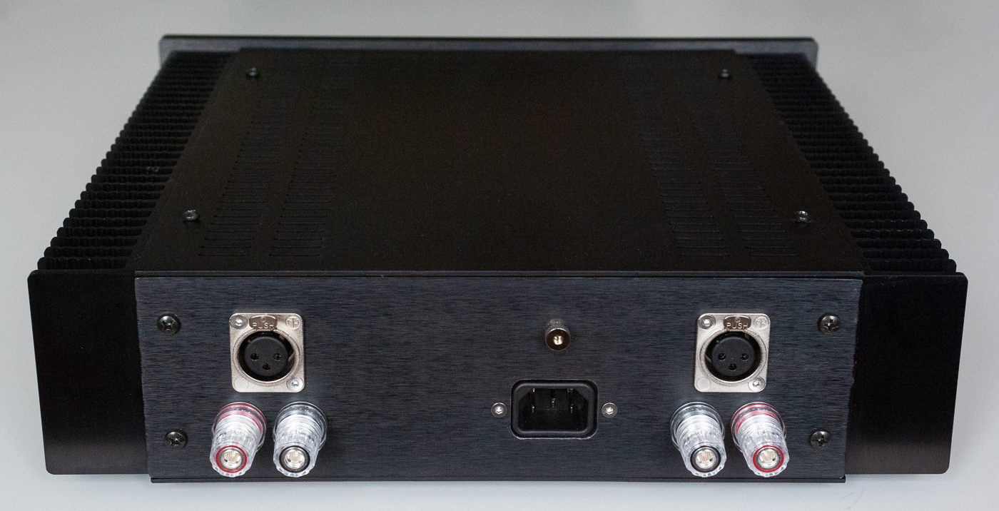

A few pictures of the finished amplifier attached.
