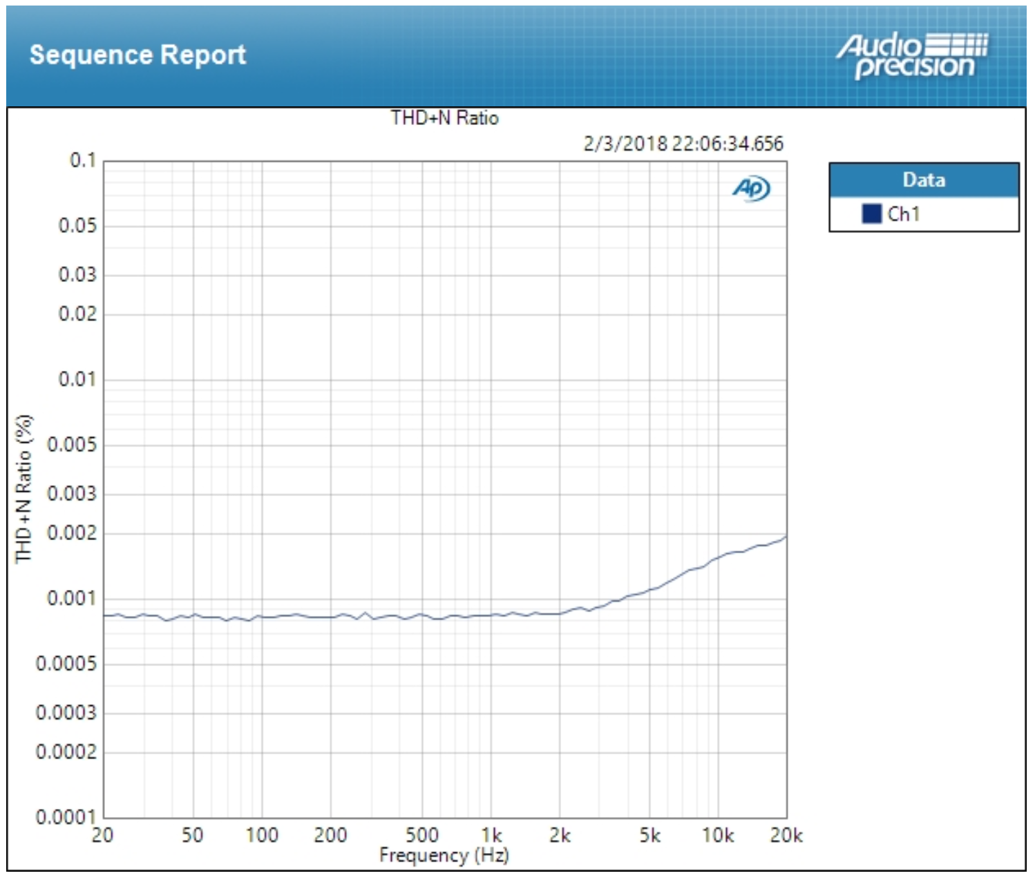

I don't have the ability to measure THD vs frequency as the THD of the MOD686 is below the measurement noise floor and I only have one precision oscillator (Victor doesn't seem to make them anymore).
I do have the ability to measure THD+N vs frequency. See attached. Most of this measurement is the noise (+N) part of THD+N. The noise is higher in this measurement due to the wider measurement bandwidth (60 kHz) and noisier analyzer (the 192 kHz ADC in the APx525 is noisier than the 44.1 kHz ADC).
Anyway. Above a few kHz, you'll see the THD starts to creep out of the noise floor. The measurement was done at 100 W into 8 Ω.
Note that this was measured on the prototype, thus subject to change (likely for the better).
I agree with your observation of rising THD+N. If the THD+N rises above audible (0.01-0.1% depending on who you ask) within the audio band, I tend to perceive the sound as harsh.
