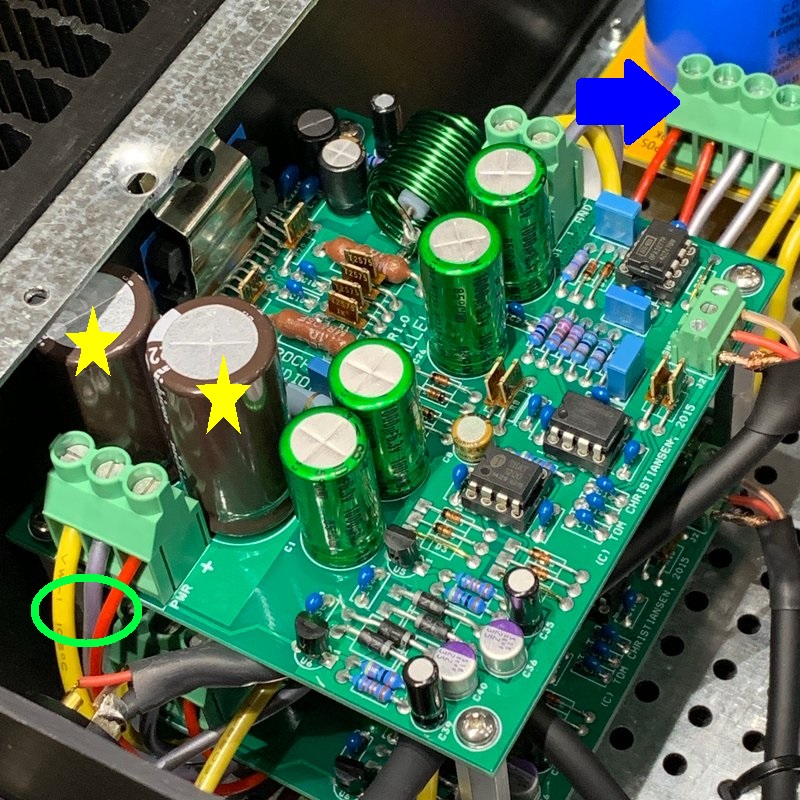

Measured secondary leakage inductance of the Antek AS-2222 is 1.6 microhenries; the inductance of a 1.5cm lead on the vertical mount snubber resistor is about 0.015 microhenries. Less than 1 percent. Nothing to be concerned about.

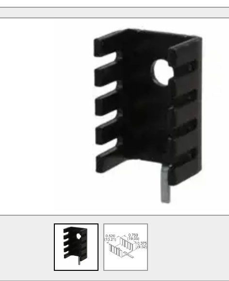

The diodes are mounted on Aavid 577102 heatsinks, same ones as on RingNot, picture below. The heatsink support leg is soldered to the PCB for additional support. The diodes themselves are in TO-220FP packages so you don't need shoulder washers or mica insulators for mounting. Just thermal compound, a bolt, a nut, and a drop of Loctite. The diodes' temperature rise above ambient, when delivering 220 watts to the electronic load for an hour, is 53 degrees C. Remember that the Antek transformer it only rated for 200 watts (200 VA); we're testing at 220 watts. Naturally, moving the diodes even further away from the capacitors would be even better, as Tom says. Don't make the board so small that it makes you nervous about overcooking the capacitors.
If you want to replace the eight resistors by eight jumpers, it will introduce extra inductance as Tom says. About 3 nanohenries in V+ and 3 nanohenries in V-. And then the power cables which connect the power supply board to the amplifier board, add a series inductance which is about 30X to 60X larger. That's why you install big honking bypass capacitors on the amplifier board itself: to minimize the supply impedance at the amplifier itself. That's why you choose low-ESR, low-ESL bypass capacitors for the amplifier board, and why you use several of them. To lessen the impact of the wiring harness inductance between the PSU and the amp.
In the photo below, the PSU outputs are labeled with a blue arrow. The wiring harness enters the amplifier PCB at the green circle. The yellow stars indicate (some of!) the big honking bypass capacitors on the amplifier board itself. Notice the extremely low inductance (proportional to wire length) between bypass caps and the amplifier itself. Notice the much MUCH higher inductance between amp board and PSU. Compare that to the 3 nH introduced by jumpering out the 3W resistors.
Valid point. But at least scrap the CRC filter by shorting out those Rs.

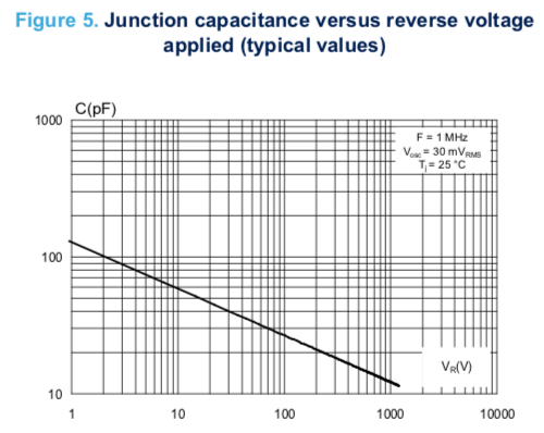

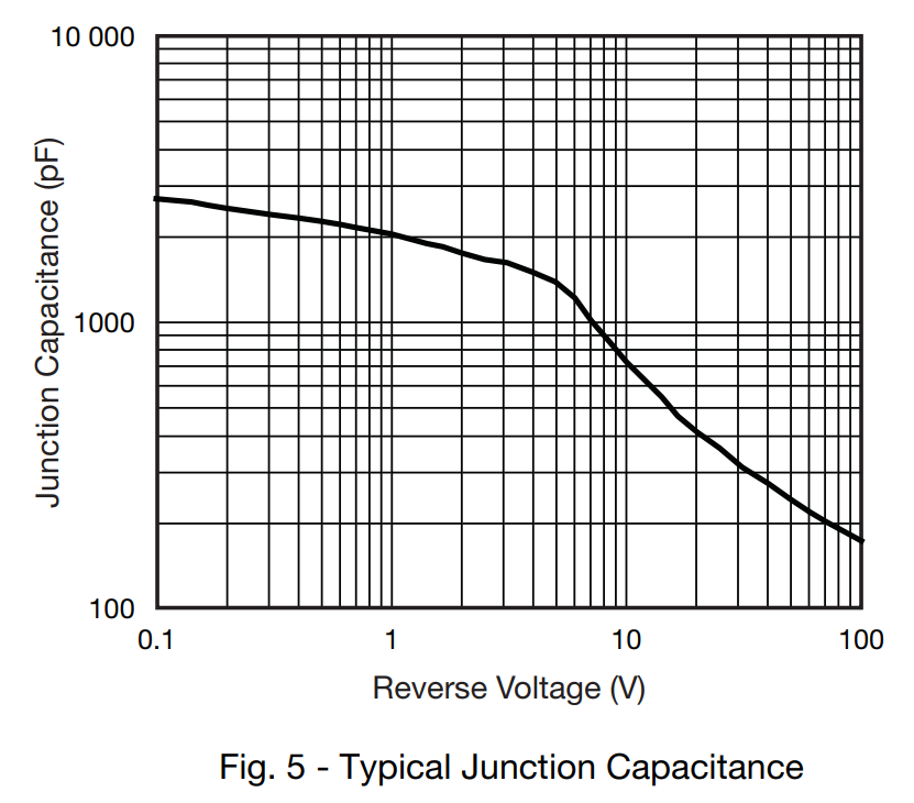

To further the understanding of this topic, it is worth noting that the ringing occurs when the diodes turn off - i.e. after they have "disconnected" the power transformer secondary from the output of the power supply. Thus, in order for any ringing to make it to the output of the power supply, it would have to couple through the capacitance of the reverse biased diodes. This capacitance forms a capacitive divider with the supply reservoir cap.
I looked up the reverse capacitance of a large-die rectifier diode. See below. You'll notice the reverse capacitance is sizeable - 35-120 pF depending on the reverse voltage, for the reverse voltages relevant to the Power-86 and Power-686. However, even at the highest capacitance shown in the graph, the capacitive divider formed by the reverse capacitance and the 22000 uF bulk cap in the Power-86 (44000 uF in the Power-686) results in 165 dB of attenuation of anything that occurs on the input side of the reverse biased diodes. At 100 V reverse bias, the attenuation increases to 185 dB.
Are you seriously telling the world that the ringing is so severe that 165-185 dB attenuation plus the PSRR of the audio amplifier isn't enough to suppress it well below the noise floor?

Hi Tom, here's another high power diode, rated for 30 amperes continuous current, TO-220 package, made by Vishay. Capacitance at switchoff (bias = 0) is a little more than 2500 picofarads.

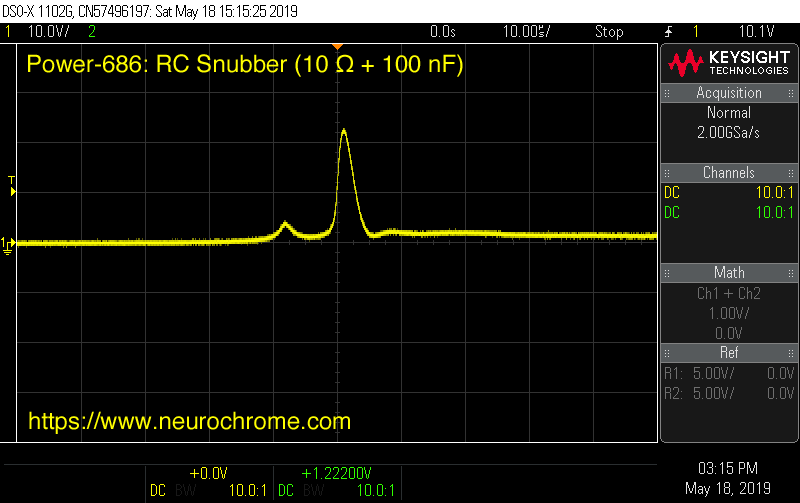

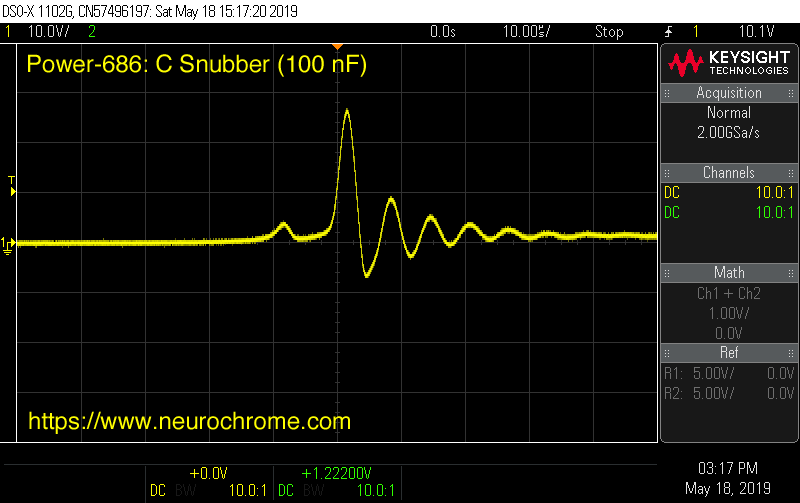

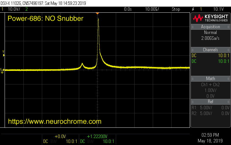

On a more serious note, here are data.
My starting point was the Power-686. So rectifier, reservoir caps, options for CRC snubber, etc. on a well-designed circuit board.
I started with no snubber. I then added my default C snubber (C = 100 nF).
I decided to give Mark the benefit of the doubt and try his CRC snubber. Mark was kind enough to provide a link to a thread that's dedicated to listings of CRC values for various transformers. My Antek AN-5225 was unfortunately not on the list, but the AS-4218 was. The CRC values for this transformer (150 nF, 11.5 Ω, 10 nF) are similar to other Antek toroidal transformers in the thread, so I doubt there's a lot of variation. I used 150 nF, 10 Ω, 10 nF, which should result in a slightly over-damped system (i.e. a system with minimal or no overshoot).
Finally, I tried Rod Elliott's RC snubber. Following Rod's lead, I used 10 Ω, 100 nF.
I measured the secondary voltage using the same method as Rod used (1 kΩ + 10 nF RC highpass filter connected across the secondary) using a 70 MHz oscilloscope. You can see the results below.
Results:
For the circuit with NO snubber, I found no ringing. The amplitude of the inductive flyback is significant, though. This finding is congruent with Rod Elliott's findings.
My simple C snubber reduced the flyback amplitude, but also created a bit of ringing. The frequency of the ringing is quite low, hence, unlikely to couple into sensitive circuitry.
Mark's CRC snubber creates the same ringing as my simple C snubber. The frequency of the ringing is a bit lower as Mark recommends C = 150 nF versus my C = 100 nF. The CRC snubber appears as effective or ineffective as the simple C snubber. It provides fundamentally the same result using three times the number of parts.
Rod Elliott's RC snubber is where it's at. It does a fine job of lowering the flyback amplitude and settles with only a tiny bit of overshoot.
From this point forward, I will recommend that you use either NO snubber or the simple RC snubber (R = 10 Ω, C = 100 nF). The effect of the addition of snubbers is not measurable on the output of the power supply, thus, will not impact the performance of the connected circuitry. As Rod Elliott points out, there may be cases where snubbers are needed; for example in cases where the equipment needs to pass an EMC test for conducted EMI.
