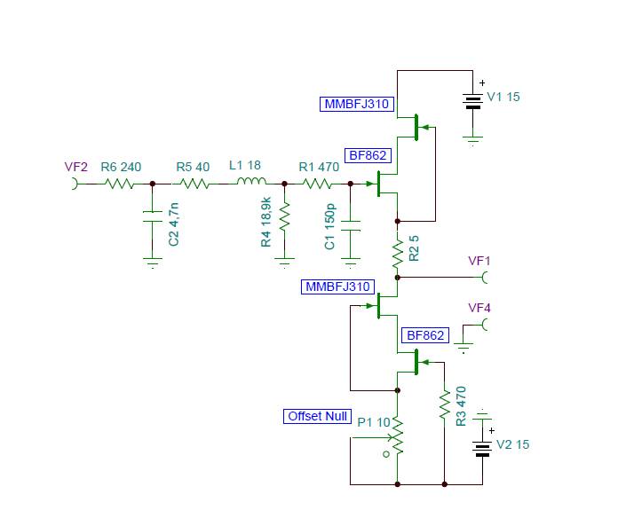

Is the JG filter/buffer a DIY usable design? I have seen numerous good comments about this and would like to incorporate it in my layout.

Here you go...
and very recommended... only not available anymore
http://www.diyaudio.com/forums/group-buys/216669-joachim-gerhard-filter-buffer-es9022.html

Thanks & I already put my name on the waiting list. Hope There will be a new batch coming out.

Or build it out of discrete components. The circuit is pretty simple and it wouldn't be too hard to build it on a piece of perf board. If I needed to build another one, I'd use J111 in place of the MMBFJ310 and 2n5458 in place of the BF862. Both are available at Mouser in through hole packages. Buy a few extra transistors and roughly match the Idss of the 2n5458 devices and you're good to go. Note, in the figure below that R6 (240 ohms) and C2 (4.7nf) are already on the V3 DAC and R5 (40 ohms) represents the resistance of the 18mH choke and is not a separate resistor.

Big thanks n I did think about building this myself. The only reason for the group buy is the size of the broard which would perfecrly fit to my small box.
