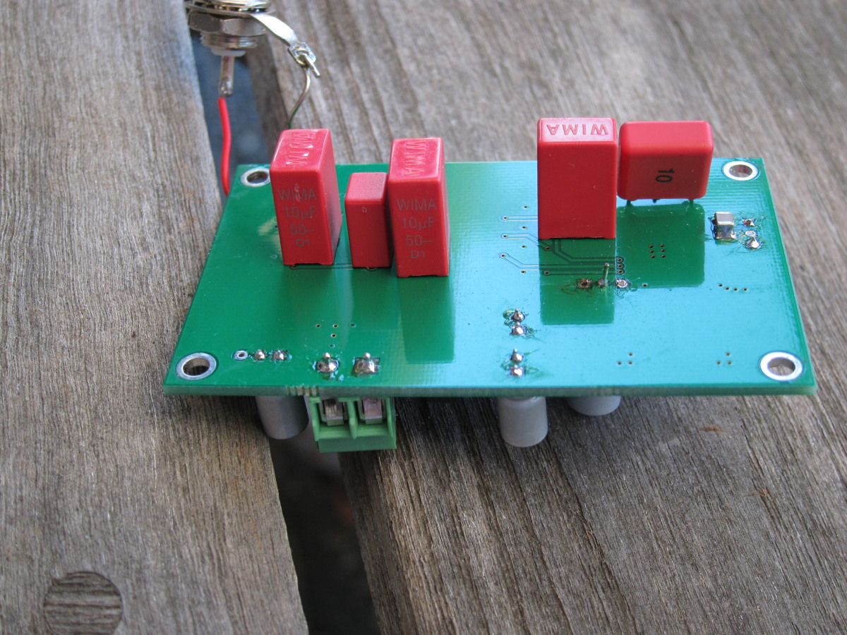

my experience
I should point out that all of these modifications are based on my ears only. When coming up with these tweaks, I had a version of the V3 DAC using JP's recommended BOM with the SAL-RPM capacitors as a reference and I was able to compare the sound quality compared to that reference as I changed parts. I should also note that the recommended BOM with the SAL-RPM capacitors sounds very good. If you build that you will not be disappointed.
I can't guarantee that your results will match mine. Your experience may be different and each of you does this at your own risk. With that out of the way, here are my findings on how to improve sound quality over the BOM.

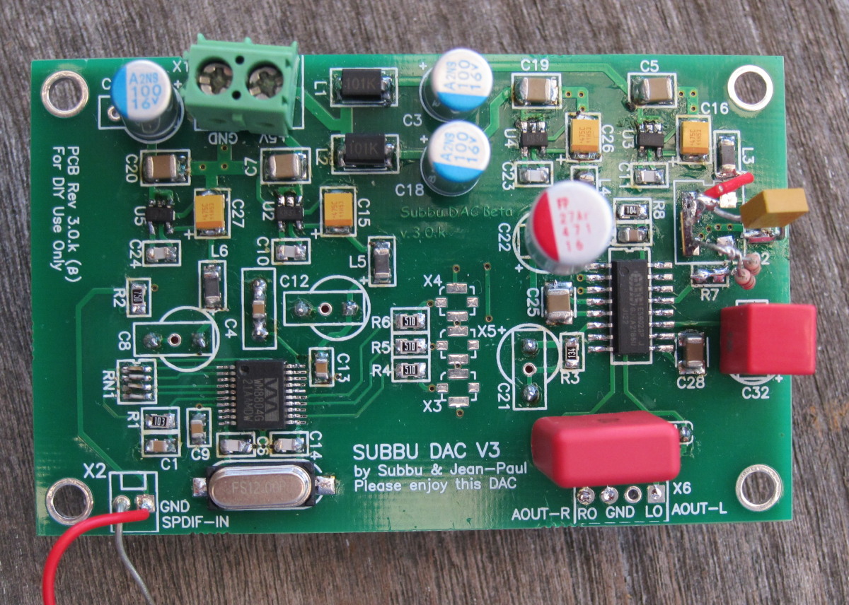

Tier 1 - most important change from the BOM
Upgrade C22 - the electrolytic cap for Avcc of the ES9023. I really like polymer caps and I find that the sound got better as I increased the size of this capacitor. I ended up using a 470uf 16v Nichicon capacitor. I think it was Nichicon part #PLF1C471MDO1, Digikey 493-3019-ND. You can get away with lower voltage parts (6.3v or 10v). Panasonic and UCC also make good sounding polymer caps. People have noted that polymer caps like to be bypassed by slightly larger ceramic caps than the 1uf cap used in the V3 BOM. In all of my builds, I used the 1uf cap and it sounded good. In the future I may experiment with a 10uf ceramic cap bypass.
For best sound, I also recommend adding an output buffer such as the JG filter/buffer.
Tier 2 - next level of importance. C35 - the cap for the NEG terminal of the ES9023. I played around with different values of C35 and found that I got best sound with a value of 4.7uf. I like the Wima 4.7uf 50v polyester MKS2 caps. Mouser part # 505-MKS2-4.7/50/10.
I also found some benefit by increasing the size of C4 - the SPDIF input coupling cap. I used the BOM 0.1uf cap and put a 3.3uf 50uf Wima polyester in parallel. Mouser part # 505-MKS23.3/50/10. I mounted this from the bottom of the board since I was worried about fitting it on the top. In hindsight, it would have fit on the top of the board if I mounted the 0.1uf SMD cap first and then mounted the Wima on top of the 0.1uf cap.
Tier 3 - small benefit. Use better quality caps for the 10uf electrolytics for the WM8804 and ES9023 - C8, C13, and C21. Either use polymer electrolytics such as Nichicon PLF1E100MCL2 (Mouser # 647-PLF1E100MCL2) or Wima polyester. I used the Wima 10uf 50v caps (Mouser # 505-MKS210/50/20) but these take up more real estate and must be mounted from the bottom. Of these parts, the most important one is C21 - the 10uf capacitor for the ES9023.
Tier 4 - changes I made that I don't think were worth the trouble. I tried a SAW oscillator for the 50Mhz clock and I liked the sound of it but I'm not sure it's really that much better. Since it's a different pad out than the current clock, it was very difficult to solder this one in. I used Kyocera KC5032A50.0000CM0E00 which is available from Digikey.
I've attached pictures of the top and bottom of my build so you can see how things went together. It's not that neat with parts on both sides but it's quite mechanically stable and sounds very good.

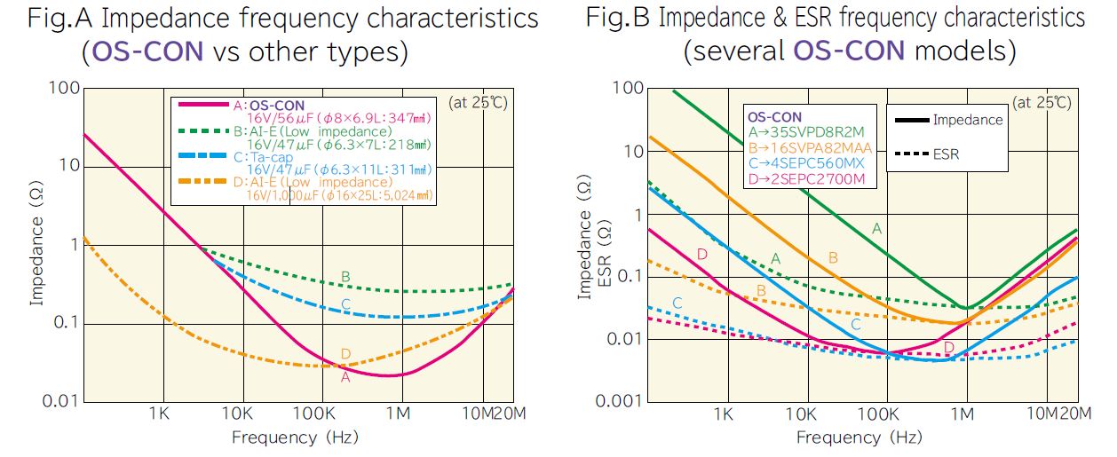

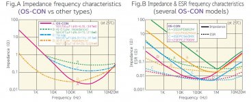

why polymer electrolytic Is better than ordinary electrolytic
Panasonic has a very good overview of polymer caps on their website. Take a look here: http://industrial.panasonic.com/www-data/pdf/AAB8000/AAB8000PE24.pdf
I have quoted one passage which seems relevant:
"The OS-CON is an electrolytic capacitor that has excellent frequency characteristics. It improves ESR greatly, and provides the excellent frequency characteristics because the OS-CON uses a high conductive polymer as electrolyte. Fig.A: The OS-CON’s frequency characteristic shows a nearly ideal curve. When compared at 100kHz, The OS-CON 56μF, and low impedance aluminum electrolytic capacitor 1,000μF nearly have the same feature. Fig.B: The resonance point of the OS-CON is at 100kHz to 10MHz. The ESR is an extremely small value approximately 5mΩ at 100kHz of 560μF."
---Gary
