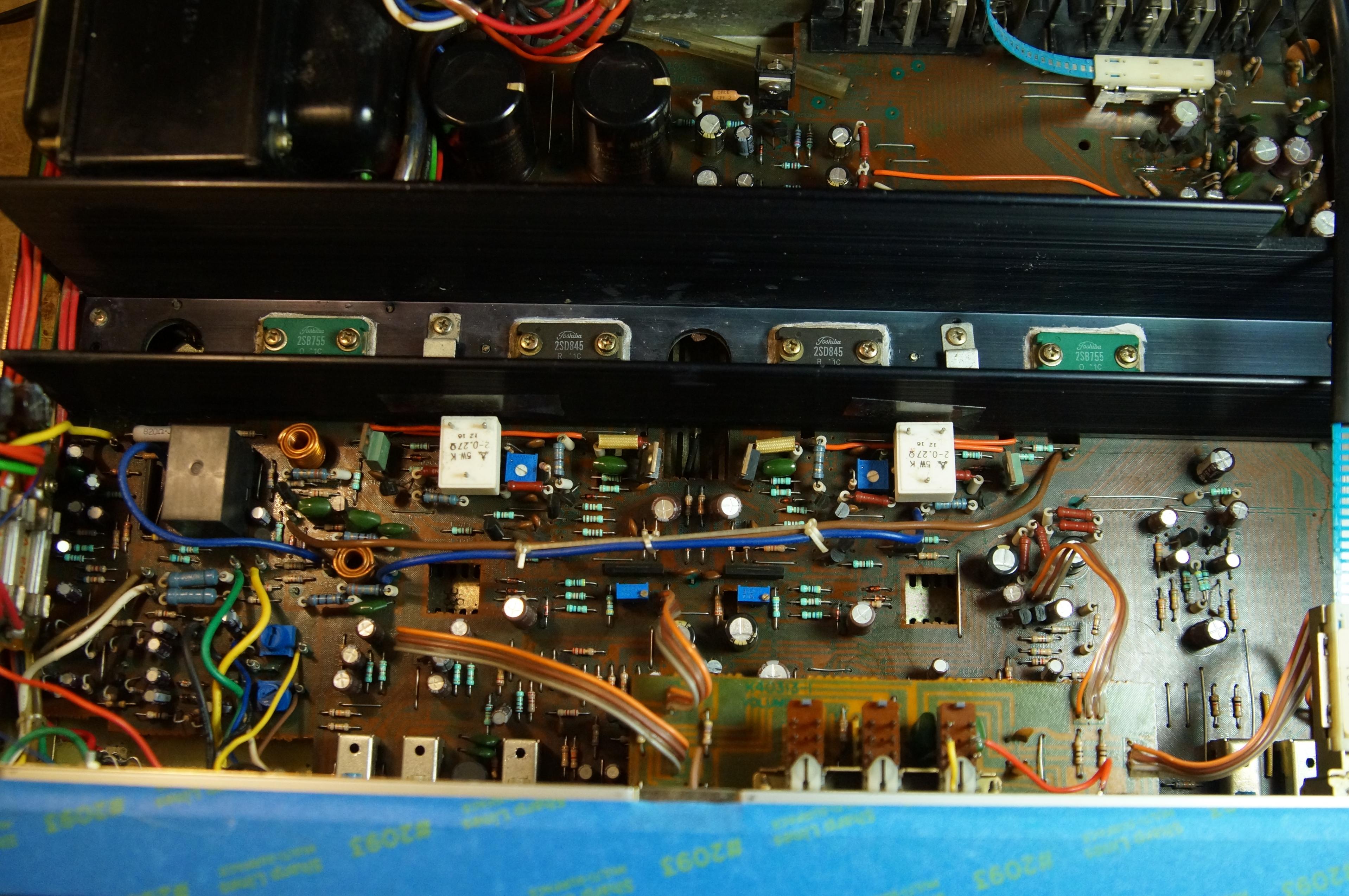

The picture in post #13 is of an amp made by Inkel in Korea, and also sold as either Sherwood S-602CP (most likely) or could be its little brother S-302CP. The S-602CP was rated 60wpc and the S-302CP rated 40wpc. Both from around 1980-1982
I have restored one S-602CP and still have it. It is a fine sounding amp. The S-302CP is very rare, used the same PCB as the S-602CP but with fewer parts installed.
Schematics and Service Manuals should still be available for at least the Sherwood S-602CP
