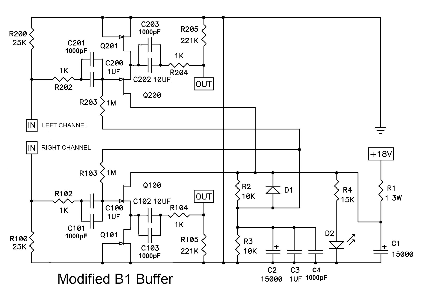

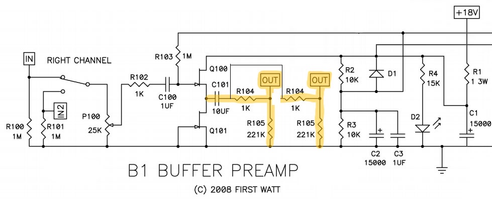

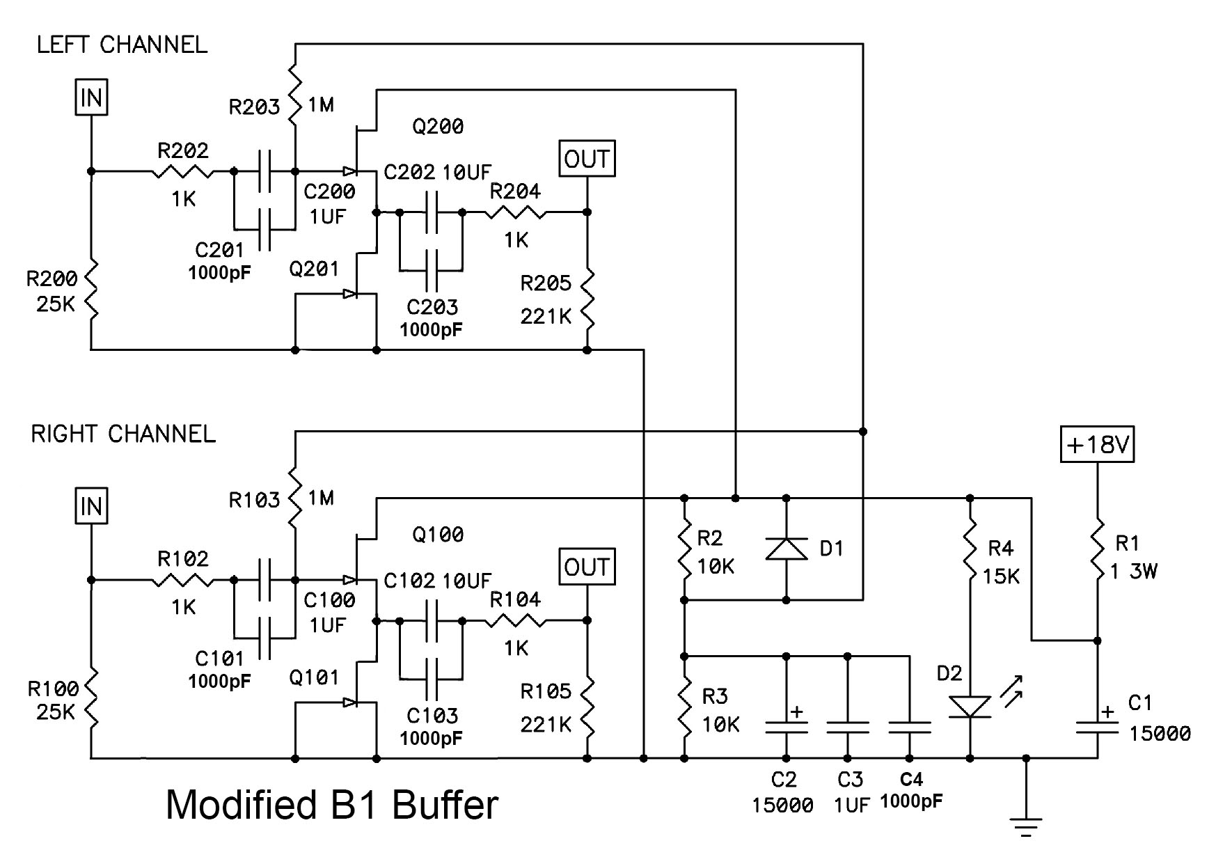

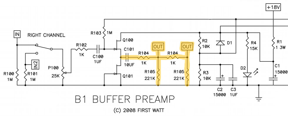

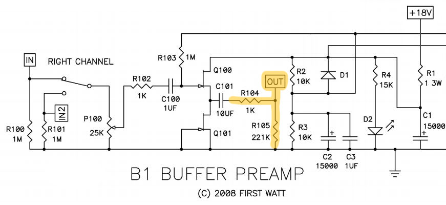

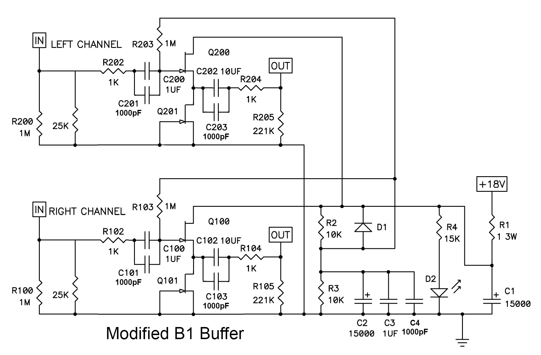

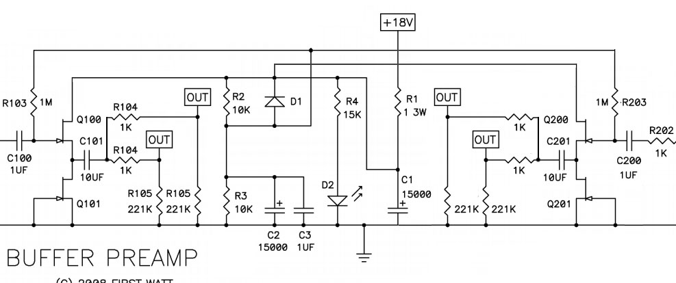

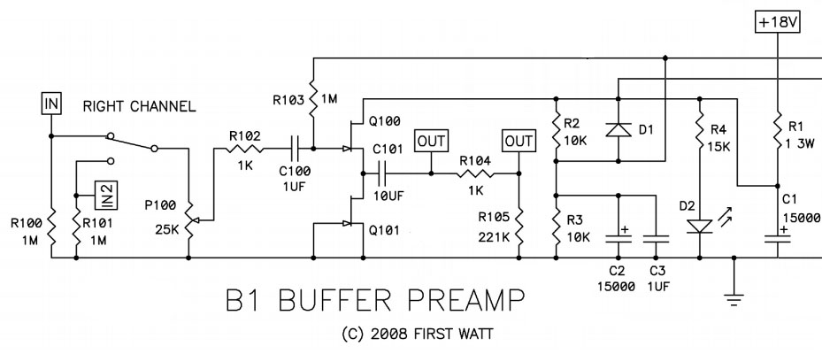

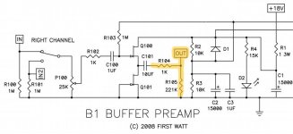

I need two outputs for my dual power amps so I wondered how to modify the B1 circuit for two outputs.
I wondered if I could do it like this:
Simply add another R104 and R105:

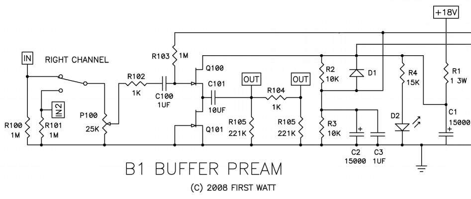

Move not delete. I don*t understand why B1 after already one output stage. More is better? Which dac is part of game?
This is for a pre-amp, not a DAC. It will have four inputs and two outputs as I use two power amps and prefer to avoid y-splitters to connect them to a single output.

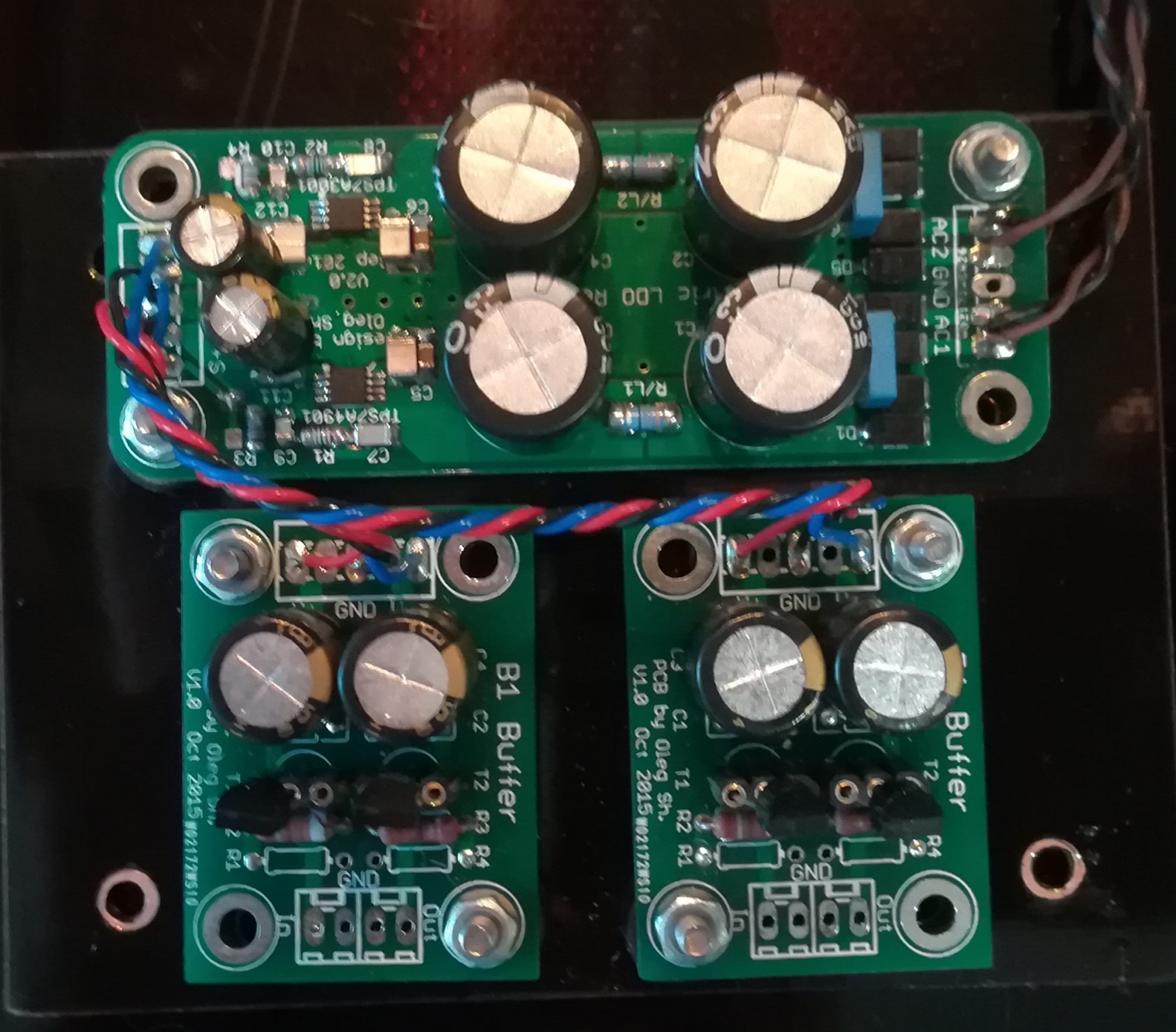

I have one pair B1 with dual Tpsxxx low noise power supply small compat design. No big signal capacitors are needed. Ready made for easy job. Plug and play. Just connect transformer and listen. Quality parts have been used.
