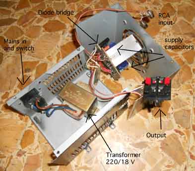

Could not resist to say : now it's time to dismantle the speaker !!
Funny thing ...I had a boombox very similar but older without cdp...same kind of amplifiers ,same VC equalizer ,but REAL switch(...a switch ! )and also Aux-CD input . Funnier thing is that the speakers were so good that now they are employed in my main speakers (helped by two woofers each).
So...good luck ! Now you have everything you need to do the changes

Well...reading through that schematic 1) I know what a 'digital transistor' is 2)the transformer should have 9 -10V AC secondary . 3) most of the circuits works at 6.2 V (at least the CD does) .
For my taste , if you need an amplifier and two small speakers (they go together ,for this power ),the best is having them separate ,or at least all together ,but with the amplifier(s) alone and the PSU (power supply unit ) ,plus a volume control ,if needed . Ok for having the radio . But the Eq is nothing good ,even if it works .
So , just cutting the connector to the CD and soldering each wire to the correspondent path ( sleeve goes to 'GND') ,will let you having an AUx input ,attenuated by the 15 K-4K7 resistors net ( R214-215).
Now I see also a BIG IC Signal Processor

Oh oh oh You get the 'philosophy'of it : less is better .
So...after the mains plug and the mains cable ,the voltage is being reduced (and isolated from the mains) by the transformer ; then the AC becomes DC after the four diodes (graetz bridge) and available almost 'leveled' after the supply capacitor : that's the Power Supply ,the current being calculated by the demands of all the circuits . The fuse breaks if something is going wrong.
Now I see ,the transformer has another secondary... So you basically need transformer +diodes bridge + capacitor and you can supply two amplifiers .
Those are the BA 5417 at pin 9 they receive B+ ,and are mounted on the big board ...later if you need you can type BA 5417 on google and find its datasheet ,to see how the mute and st-by functions are performed ( usually they need a 10 K Ohm resistor to +Vcc , to 'unlock' the amp )....
So Ground connections are important !
Volume control is a different job. Theoretically you could connect a stereo potentiometer ( or two singles) having a value ranging from 10 K to 100 K Ohm ,and you're done ! Practically ,is a different story : moving the cursor ,the central wiper of the potentiometer ,you vary the quantity of series resistance together with the resistance that goes to Gnd,but together with the amplifier's input resistance and capacitance ,it determines a low pass filter (RC) ,so at low volumes (high series resistance and low impedance to ground) you may feel a lack of trebles ...so it is a challenge by itself .
But if your sources provide volume control ...you don't need it

Yes ,the capacitor is located on the main board (should be near pin 9 of the BAxxxx amp ).
Groundis 'minus' ; B+ is 'positive' . Before the inputs of each amplifier there's also a transistor ,that goes to ground: I think its purpose is to 'mute' the inputs...and everything is controlled by the logic ,but we are going 'analogical' ...so you must enter the amplifier directly ,skipping everything else.
The extra secondary of the trafo is for supplying everything but the amplifier...just follow the lines (traces on the PCB)...

So I just regroup all the information together now(correct me if anything wrong):
- I need to dismantle the power board (a circuit with transformer, etc.......), so that i have fuse, along with the rectifier.
- I need to unplug the 2 amplifier IC (BA5417) from the circuit for assembly usage
- The 2 big speaker (most important element? X.x)
And thats all things i need from the radio player ?
If that so, how should them be wired up to each other ?

Hey ! I have that BA 5417 ! it is only one chip ,does stereo because each amp is Single Ended -it is output capacitor coupled- and yours are two 'cos they operate in Bridge Tied Load (more than double the power -must sound good !)
I would say the last thing ,before operating ...
You can try to do the first mod ,which is to cut that connection to/from the CD and put two RCA or one 3,5 mm stereo jack (T.R.S ).
If everything is done right , when selecting CD you should hear your new source. Then ,if you are confident ,you can cut out all the circuitry you don't need .
