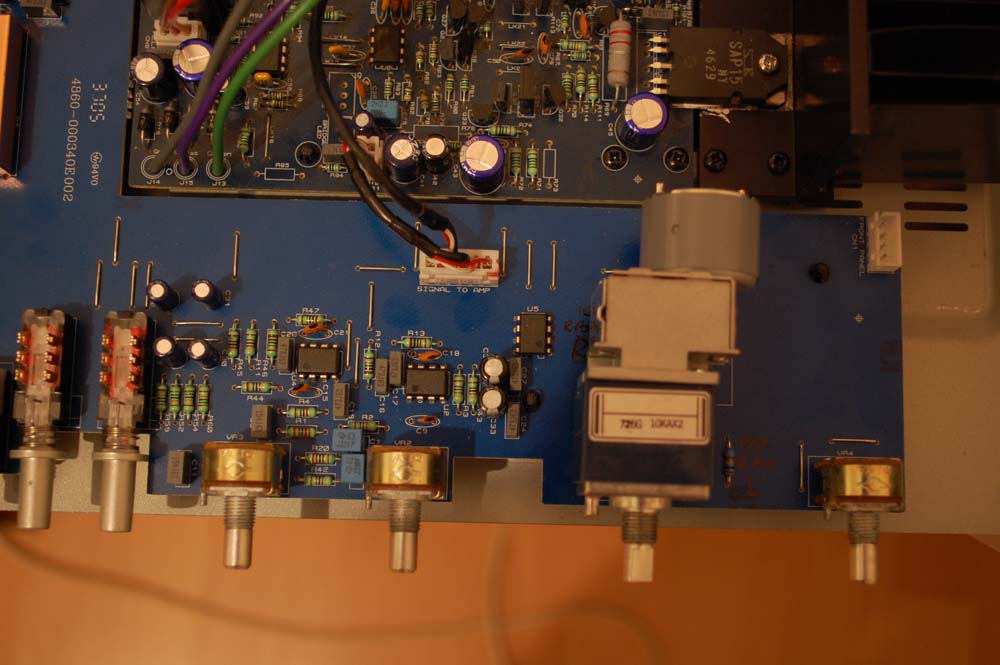

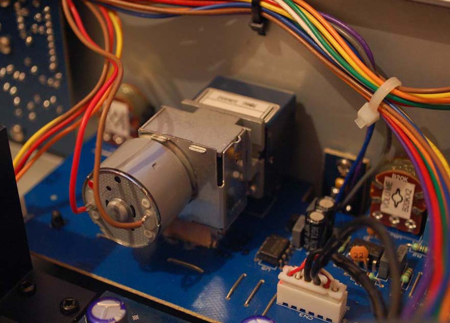

I managed to fit the volume pot the correct way up and use very short wire links to connect to the PCB. I glued a small wooden block to the bottom of the pot to support it in exactly the right position so I could remove the front panel and wire the pot in from the front.
Fiddly work but well worth it. The amp sounds fantastic now so that's how I'm going to leave it for the time being.

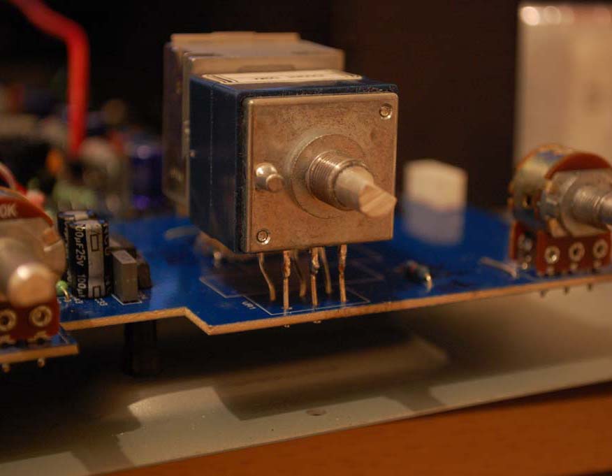

Here's a photo of the pot after I'd soldered in onto the PCB.

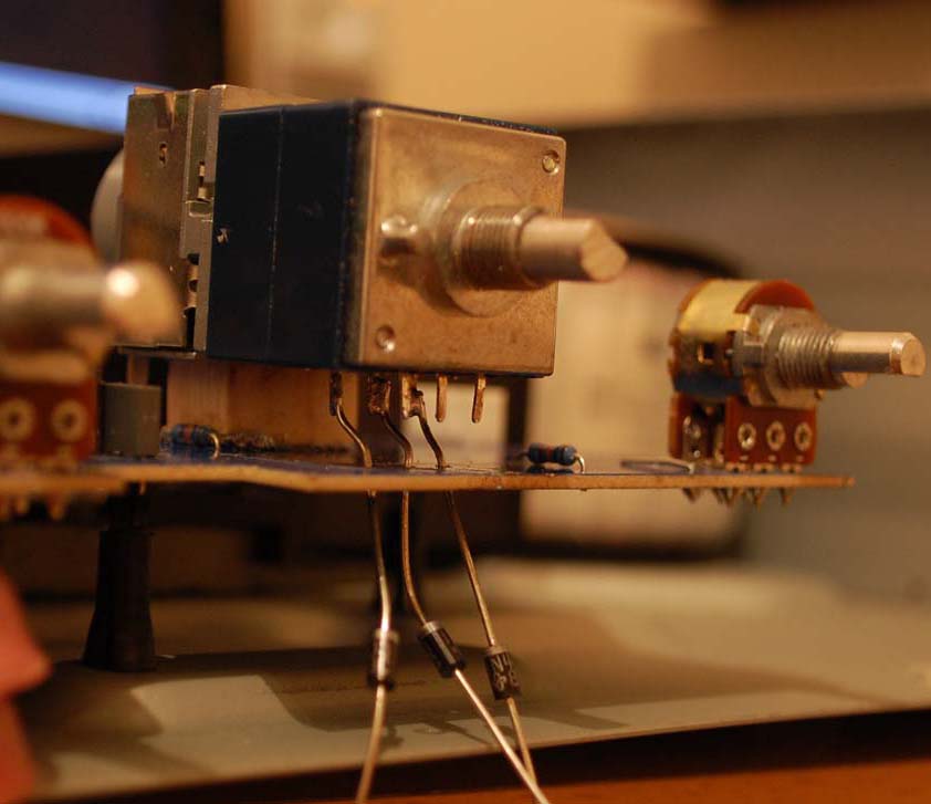

You can just see the small wooden block at the back of the pot. This was glued onto the flat section of the gear housing part of the pot. I applied glue to the PCB then refitted the pot into the front panel so when the glue dried it would be in exactly the right position. After the glue had dried I then removed the front panel and wired the pot to the PCB.

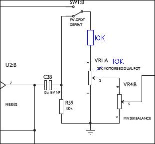

It was about £28 from an eBay seller called Familygate. It's an ALPS RK27112MC Blue Velvet. He has a datasheet in his advert.

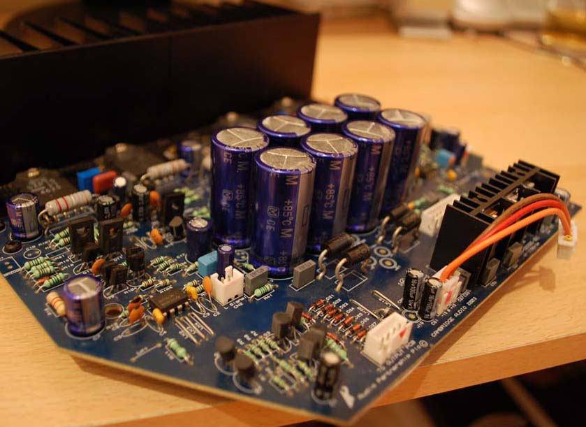

Here's the plan view shot you wanted... the photo's are a bit blurry as it was gone midnight when I took them, I really wanted to get it all done this weekend!

The original pot was a 20K log but the Alps came in either 10K or 50K log so I went with 10K and fitted 10K series resistors.

No problems with the lower value pot. With the 10k series resistors the previous buffer stage (U3) see's the same resistance.
The balance between channels is very good, there's no noticable difference between left and right speakers.
In terms of response to the volume control, you have to turn the knob round a little bit more to achieve the same volume compared with the old pot.
As a rough guide to volume achieved;
Old pot 9 o'clock = Alps pot 10 o'clock.
I prefer this as it gives a bit more fine control, useful when using the remote control as it has quite large volume steps!
I forgot to mention, the hole in the front panel is too small so needs drilling out to 8mm and the small locating hole beside it needs a bit of work with a needle file. You'll see what I mean when you have the parts in your hands, it's all easy stuff.
The best tip I can give is make your spacer (wood block in my case) just the right thickness so it slots underneath the pot when it's secured in the front panel. That way, when it's glued in place the Alps pot will be in just the right place for soldering the new legs in place.
