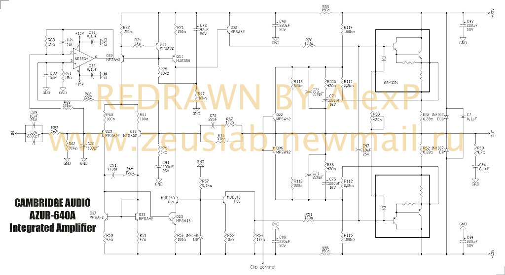

There is no separate transformer to manage standby mode in this model or the similar 540A. The standby mode simply cuts AC from the main power transformer secondary windings to the power amp rectifier, leaving the low voltage supplies for preamps, probably the headphone amps, (12V trigger?) 24V Abus control and 5V microprocessor still operational, so they can respond to wake up commands and switch the power amplifiers and protection circuits back on..... what in this amp consumes 10w at standby?.....
No doubt, newer models will conform to lower standby current regulations and use a different design approach. I don't think converting that to a separate standby transformer for the 5V supply would be easy or work correctly without a design re-think.
looked at this and this is definitely poor design. there are two stages, pre and power amp, the pre got +-15ac power from main transformer low voltage secondaries and change it to +-15dc and +5dc, and after that the latter powers standby to provide signal to high voltage secondaries relay switch which keeps them off until ir or manually switched on. there is no relay switch for keeping pre amp off as voltage change is done on it (and perhaps protection stuff and standby). there is missing small separate transformer to deliver power for standby only and ir and to keep main transformer full off.Standby transformer of dubious quality?
Do they keep the amp's front end powered up to keep it 'warm'?
Switch it off with a proper inline switch or switched power board. 10w in standby is either a fault or very poor design.
there is service manual available (540a v2) which covers also higher rated 640a v2.
any hints how good design solves it appreciated.

thanks Ian for reply. seems we conclude to similar results.
to fix it one need to add relay switch at supply side to cut off low secondaries in similar way add it is done for high line and then use separate transformer to supply +5vdc line in pre amp. if the controller chip is 5vdc then it might succeed. the +5vdc converter from pre amp needs to be perhaps cut off to not cause problems when new relay restores supply for pre amp. based on SM do you think it is doable?
tapnięte talkiem
tapnięte talkiem
ok, I've cut if 5v rectifier and connected instead over supply from mobile charger. it seems to work in standby with disconnected 15vdc until power switch it's turn on, then protection led is blinking, perhaps due to no power in amp section after while. the power consumption at standby is now 3w - 10w lower than base. now I have to rethink what to do with existing high voltage relays and new one for low power. the existing ones are supplied by unregulated 17 vdc just after gretz bridge. there is standby signal from pic and this unreg to drive relay coil. i thinking about changing existing relays to 5vdc type so i could replace this unreg branch with 5.6vdc from new supply. or alternatively add one 5vdc relay and let it turn on low power only, then ??? high power relays will triggers or not. the question is is it enough time to have second relays bump until pic secure something is not normal... have to experiment. awaiting relays.

Well capacitors and opamps done on the preamp PCB. Noticed there are two 2W carbon resistors which are part of the speaker protection circuity which are looking nice and dark brown. Obviously see a bit of heat. I have some 5W wirewound ones here which I am looking at replacing them with. I can't see any issues in doing this but anyone no of any reasons why I shouldn't?
because it's just circuit to drive relays and have nothing common with audio signal path?Well capacitors and opamps done on the preamp PCB. Noticed there are two 2W carbon resistors which are part of the speaker protection circuity which are looking nice and dark brown. Obviously see a bit of heat. I have some 5W wirewound ones here which I am looking at replacing them with. I can't see any issues in doing this but anyone no of any reasons why I shouldn't?

finally i'd time to finish my mod. herein some pictures and explanation what have been done.
wires from power amp to additional capacitors mounted side of board.
first sound check with additional capacitance and U7 op-amp exchanged to AD8599.
with mounted dac module TDA1543 on the left. the 2 rectifiers from dac are screawed to top of pre-amp heatsink.
voltage supply is taken from +15vdc link on pre-amp. output signal from dac is connected to tape monitor input
of pre-amp.
back side with optical input added.
all poor xunda electrolytic capacitors has been exchange with some good quality ones
2*4*3300uf 63v mounted on side below trafo
final look with additional relay on 17vac line to preamp. relay is driven by standby signal from lk105 and +5vdc taken from links on board.
additionaly I've disconnected D1 from +15vdc line and connected to +5vdc. the +5vdc power supply from mobile charger is in left bottom corner. it is conected in place of removed U3 rectifier on pre-amp board.
the only problem is with abus module standby signal. when connected the amp goes to protection.
when whole connector CN1 from abus is disconnected it starts ok but the remote control is not working.
so i've removed standby signal from CN1 connector (pin 2) and plug it in. now all works. i've checked module but have
not found any errors. maybe it is caused by too much current load on +5vdc line. the +5vdc power supply i've mounted is only 800mA capable.
the power consumption on stand-by after modifications is 3w compared to 13w before (11w + 2w additional from dac module).
