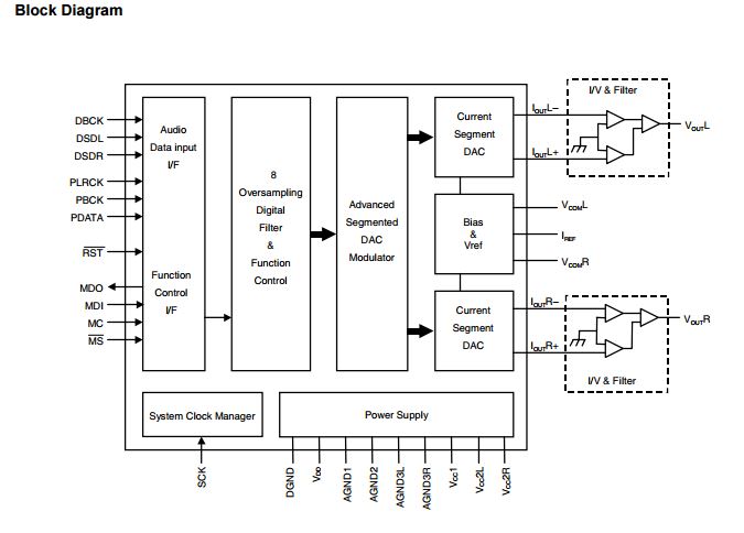

Thanks for the answer Calvin. As I understand, the DSD1790 is a difficult dac to be changed simply. The idea of Ken is the most simple, given that with the resistors will quickly minimizes the circuit. Your circuit intrigues me a lot, since it has everything already on board, and from what I understand it would be easy to modify for my dac. You have developed the pcb of your circuit?

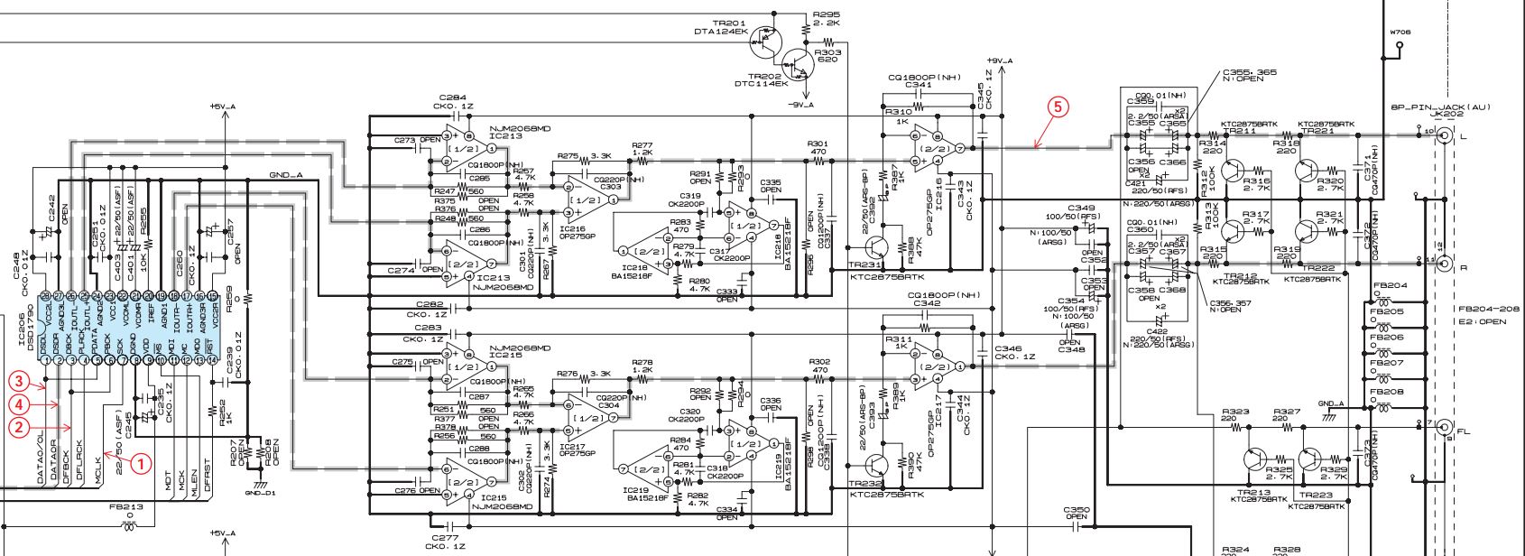

- Mod denon with zen I/V
