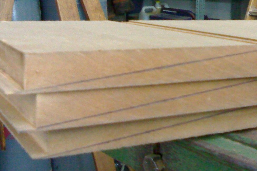

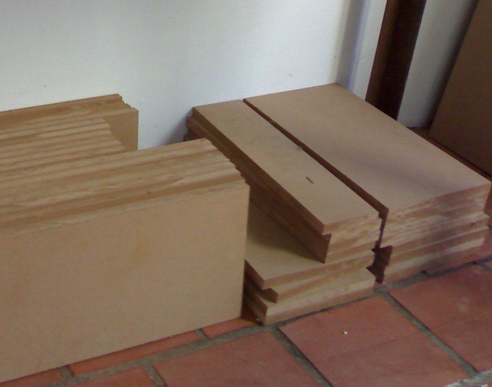

Progress Report
Well here's the dreaded MDF, all nicely cut into panels for 4 boxes.
One pair for me, and one for my friend who's workshop I'm using.

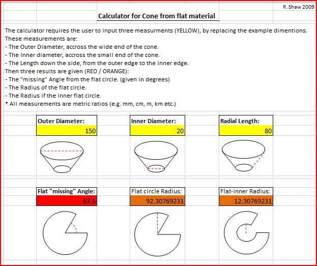

Calculator for cone from flat material
Raphael Shaw said:
- I am very interested in the EnABL process, I have been reading some good threads on it and it sounds very cool. I will carry on reading. In the mean-time, I'm going to practice EnABL'ing some cheap drivers that I have which have a similar size & shape paper cone to the the FE167e. I will let you all know how it goes.
I have made this simple Excel calculator for making EnABL pattern stencils. It calculates the angle of a flat disc which would make a cone of a desired pitch, using easily measurable dimensions.
BudP must have used something similar here:
Here is a sample cone you can cut out and make into a cone, either an innie or an outie. As you can see the block size in a ring set changes with the actual diameter that it must cover. The lisp program that I have performs all of these calculations and draws the resultant conic section as a flat surface. I have converted it ot a jpeg format for your convenience The specifications need to be for: The large cone opening diameter, or the diameter just at the lowest edge of the surround where it overlaps the cone. The small cone opening diameter, or where the center dome actually touches the cone surface. The material thickness, a guess will do. The length down the cone surface from the surround lower edge to the top edge of dome attachment, on the cone.
http://www.diyaudio.com/forums/showthread.php?s=&threadid=100399&perpage=25&pagenumber=1
I hope it's usefull. Perhaps it could be added to the EnABL-Process thread???
*! -Oops, I can't attach an excel spredsheet.
I'll find somewhwere to post it, and add a link.
-or just ask, and I'll mail it to you.
