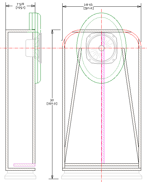

No Worries
Oh, well. done it now.
At least this way the sides will be braced a little better.
Thanks for the updated plans.
I have a question about the holey brace in the middle.
-why is it important that the two holes behind the driver are symmetrically positioned?
-and based on that reasoning, surely it's equally important that the angle just below the magnet is mirrored above it?
Re: No Worries
It isn't important that it is symetrical. The 2 big holes are there to open up as much space as possible (with as little work as possible) and still retain a mechanical path directly from the back of the driver to the back of the box. This last is one of the suble design touches that i should be more explicit about...
dave
Raphael Shaw said:-why is it important that the two holes behind the driver are symmetrically positioned?
dave
