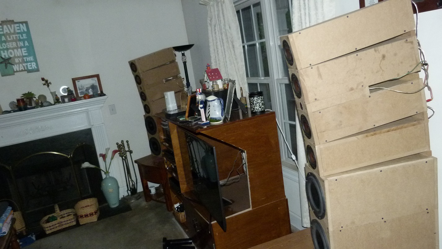

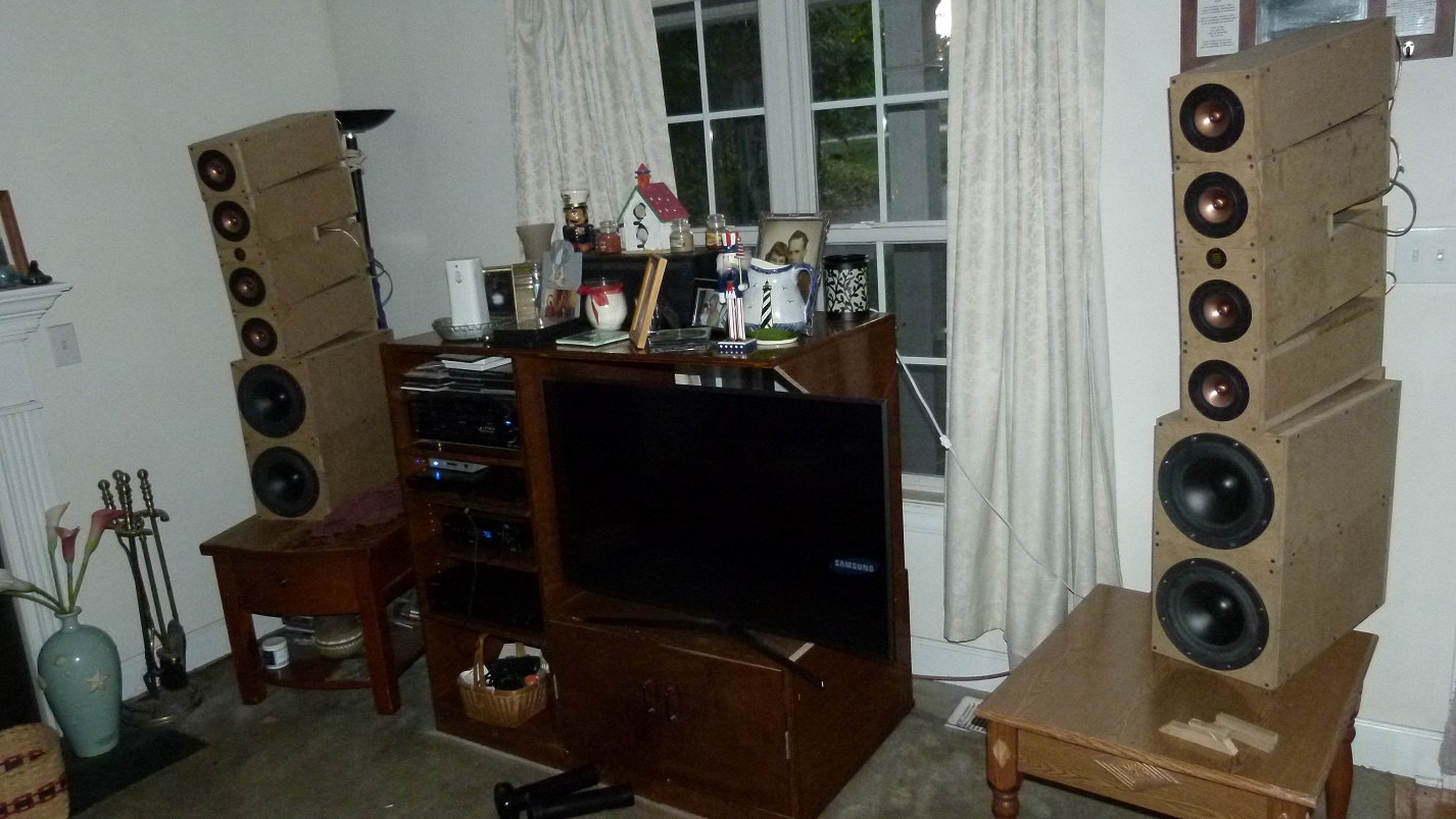

I was so impressed, 8 more Pluvia's are on order. That'll be 8 per side. Looking more like an array now as the title suggests.
Hmm... getting more interesting.
It's good nothing is glued together yet.

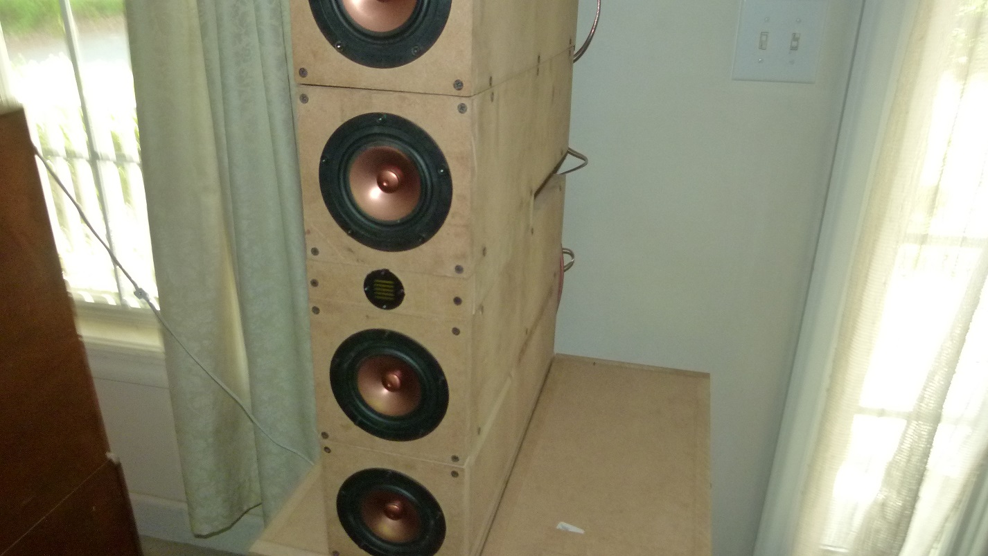

The plan is to disassemble the Pluvia enclosures and cut them in half depthwise. This will yield the quickest 16 enclosures. Currently there's 8 and they're 20" deep with internal volume of .31 cu.ft. and vented. The new boxes will be sealed or vented, testing is needed to see which sounds best. They should go down to 100Hz. But at least they will be light! The 20" boxes are 11lbs.
All enclosures will be modified such that the Pluvia drivers will be as close as possible when vertically stacked, so figure about internal volume of .13 cu.ft.
Also, I have plans to build a sort of stand for each array that will allow vertical 'aiming' of each speaker, when not stacked closely together although it will allow for that too. More on the stand later. The 2 SB Acoustics 8" subwoofers will be stacked on the bottom.

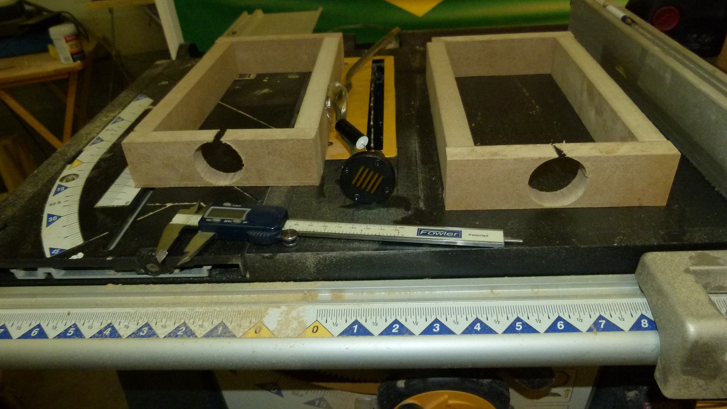

Today I'm working on the simple task of an enclosure for the AMT tweeters.

At the very least you should also move the stacked boxes to the front of the tables. This appears to be evolving into something very interesting. Whether you continue with it, or move on to something else, it looks like you've caught the bug, and minidsp could serve you very well all the way along your journey- just be prepared for a bit of a learning curve there as well.

Looking good. What are the bass drivers used at the bottom part?
I mistakenly said they were Dayton's a few posts ago. They're SB Acoustics 8" subs in a 10"x8.5"x20" box. I'm really tempted to make 4 more, so 4 per side. They're powered by a separate amp.
After stuffing the vents in each of the Pluvia boxes, the bass is now much more present. Must've been some cancelling going on between the two types of drivers.

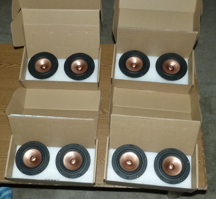

Here's some pics of the new MarkAudio drivers. Nicely packaged with precut gasket material and 'hex/Allen' mounting screws.
