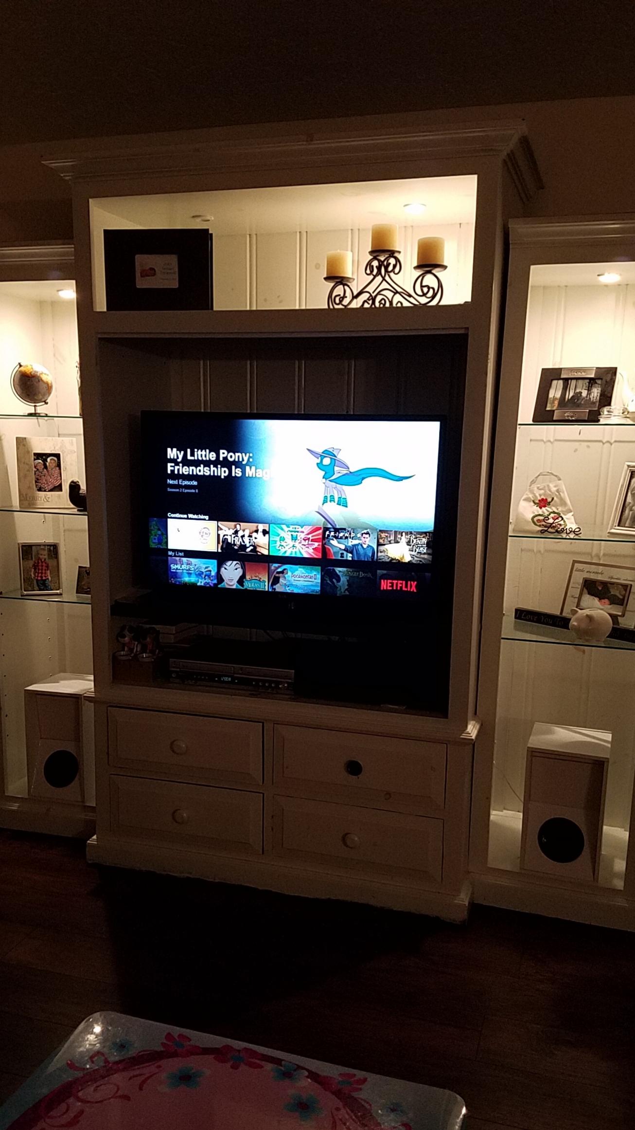

My first post is going to be a praise report on the 0.53x karlsonator w/pa130-8. I have read every post on this thread and the xki thread also... my goodness that took a minute. I would like to thank xrk971 for his seemingly tireless efforts to crank out simulations for every speaker imaginable like a mad scientist on meth, for free .
The 0.53x I built is made out of 1/2" Hobby Lobby foamcore with PVA glue/hotmelt method with no bracing and sounds amazing, even though I had to put them in the cubby-holes of our entertainment center. In the pic I had not placed the apertures on yet but they sounded alright with them off too.
I'm running these with a cheap sony 2 channel avr from best buy for mostly movies and background Pandora every now and again. While I had them out putting the wings on, the wife told me she never realized how bad the tv speakers were and told me to hurry up and put them back!

Thanks for the kind words Btram4. The white foam core matches your white entertainment center!
If you like the sound of this speaker, the dual 3FE25 will be 6dB more sensitive but sound similar maybe with a more resolved top end. But the PA130-8 can take more power so you could turn them up louder with bigger amp. Try moving these to the new location and test it out. If you still need more oomph make the dual PA130-8 XKi. If you want a nice all around smooth sound with good bass and nice highs, try the w5-2143. But I think you would be very happy with dual 3FE25-16. That’s a sure thing and not expensive. Dual PA130 XKi is about same price in drivers but a bigger box.

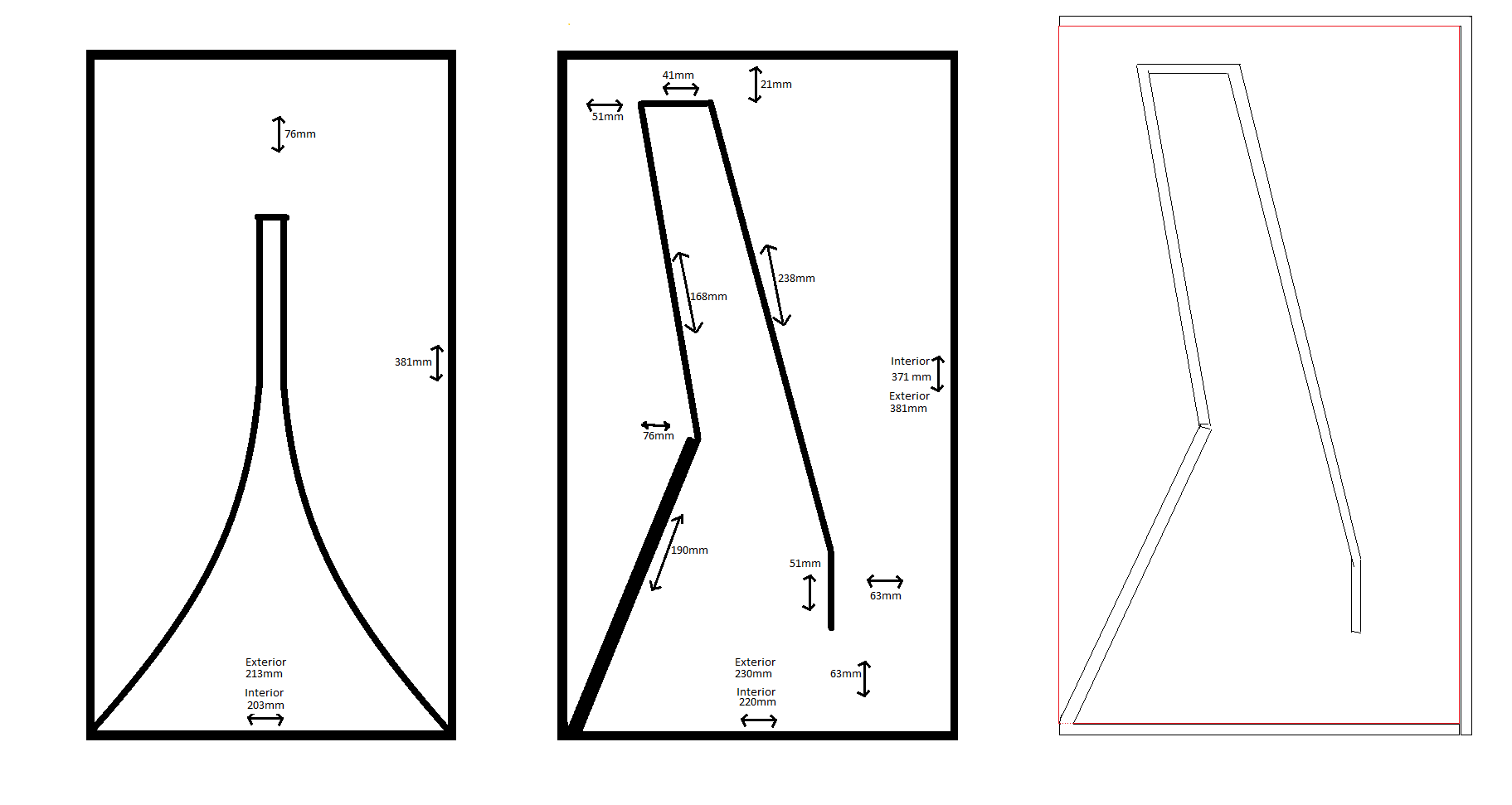

Okey, I've been comparing the plans and the biggest difference I could see was the height, your one is 381mm externally while the other one is 381 mm internally, so a cm difference in height.
I was bored at work today so I drew a picture in paint and added the measurements translated (and a bit rounded) to mm, does it seem to look correct? (Never mind the drawing, its just randomly drawn and therefore not correct,just to know what measurement goes where.)
And the drawing to the right in the picture is how I'm going to fold and cut and paste it together.
This was the fut and fold idea you had muddjester?
If the drawing to the right is understandable!

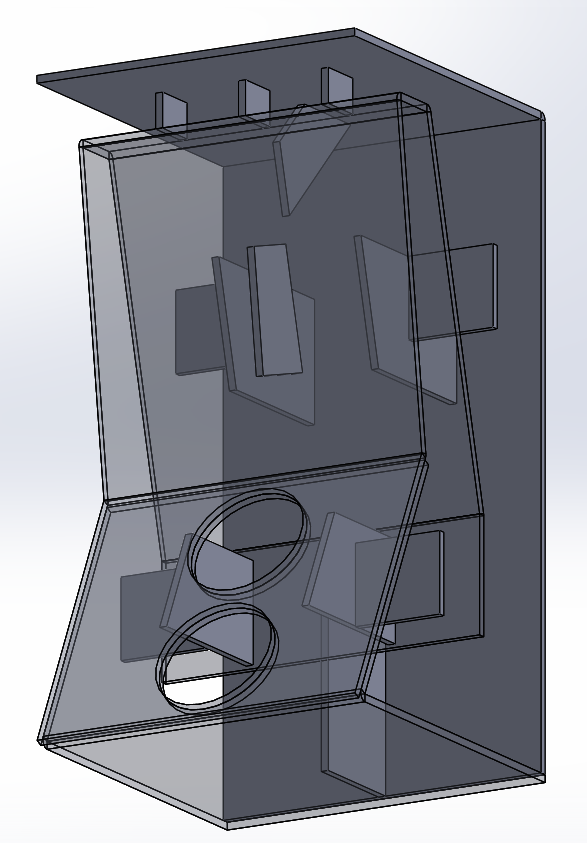

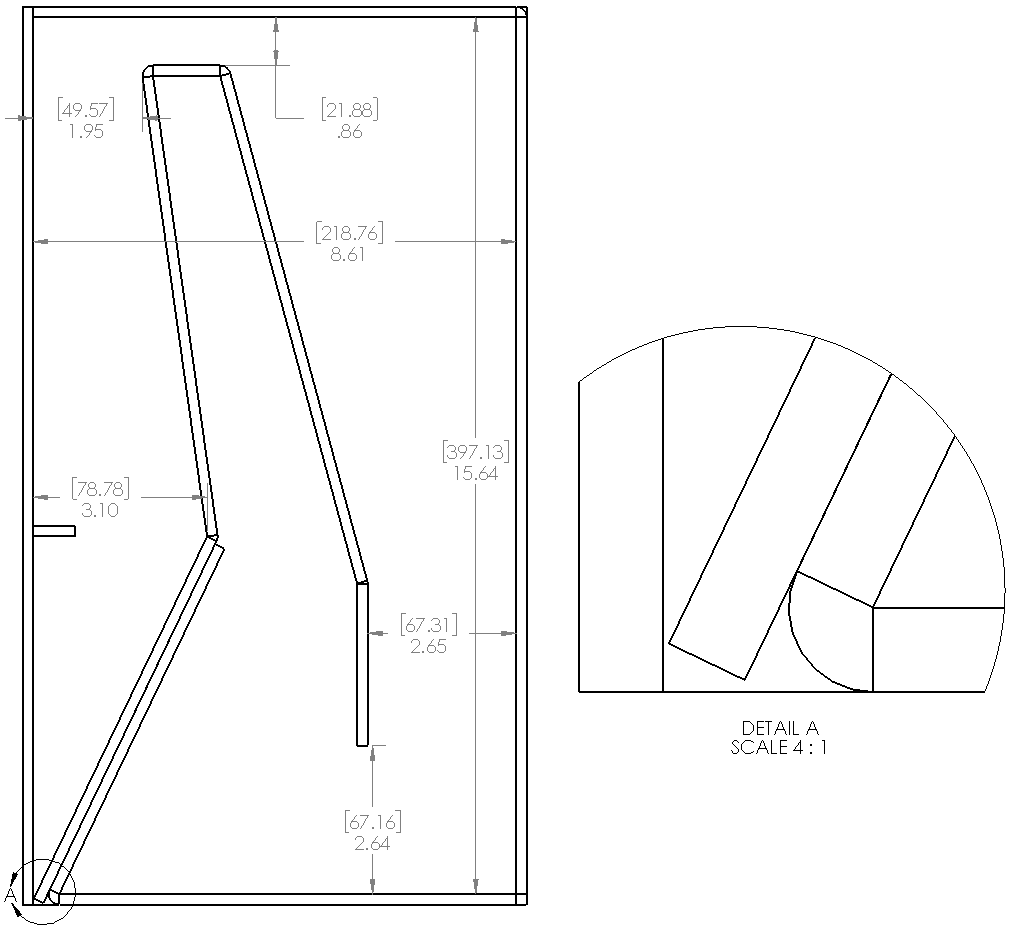

Here's what I am planning. I just need to add the bracing and I can start on the drawing. I decided to bring the front baffle to the bottom (shown in detail A) for aesthetics.

Awesome work - that’s the bracing scheme I used! Thanks for following it. It needs a lot because the walls are thin and span a large distance.
Looks really nice, perfect with the bracing also!
This one measures differently from both the CAD x0.53 and the xrk version in height, so now we have 371 mm internally(xrk), 381 mm internally(tb46) and 397 mm internally (MuddJester!
I think for "safety" i will go for the 381 to end up somewhere in the middle of everything.
Will start the build tonight!
Mine is a true x0.53 scaling of the original Karlsonator, focused on maintaining internal dimensions (the scaled down 3/4" walls of the original are thicker than the 3/16" foam core). XRK's was modified to make it easier to cut from 20x30 panels. Which CAD are you referring to?
the one by tb46 in post #198!Mine is a true x0.53 scaling of the original Karlsonator, focused on maintaining internal dimensions (the scaled down 3/4" walls of the original are thicker than the 3/16" foam core). XRK's was modified to make it easier to cut from 20x30 panels. Which CAD are you referring to?
