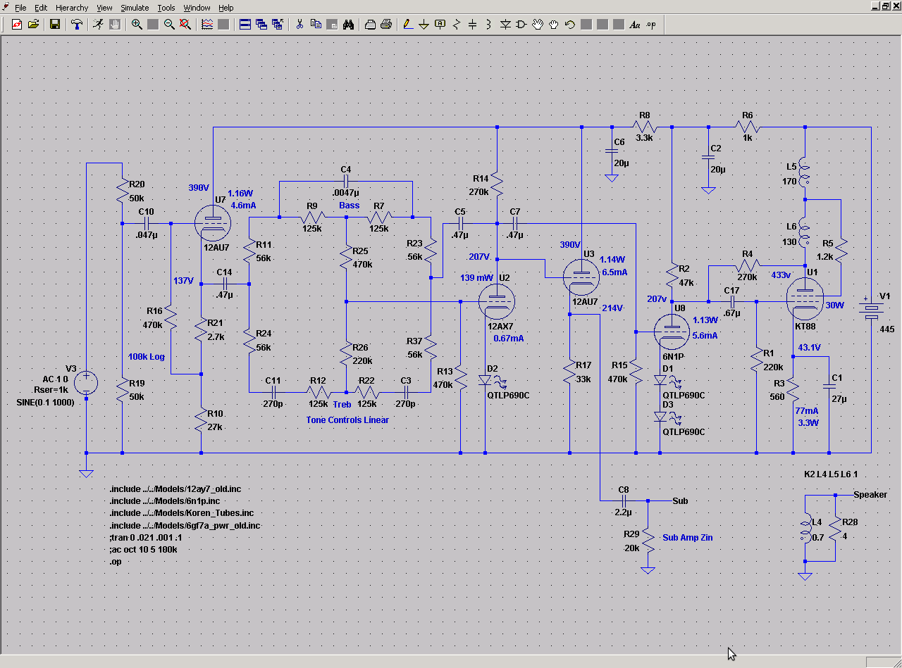

I have mentioned in passing a mini-console project that I am working on. As I am getting ready to start drilling the chassis for the PA section I thought I would post the intended schematic including the preamp section. I am sure that some details will change as I test the results.
The preamp (12AX7 and 12AU7s) will be on a separate small chassis salvaged from a hammond L-101. Power supply will be 5AR4 rectifier with CLCLC filtering. The speaker drivers will be MA CHR-70 (series one) in BR tuned to get solid output down to a bit below 40Hz.
One concern is that some subwoofer amps may not be able to adjust crossover down low enough to avoid a boomy bump when trying to integrate with the mains. I may try to add a switchable HP filter to help with that.
Comments welcome.

I just realized last night that this won't really cut it for my intended use. The primary input source is an iPod which in my experience has less output voltage than a CDP. I figure maybe 1V peak (1.4V RMS) which is no where near enough to drive this to full output.
It has been suggested to me that using pentode drivers would work better for the shade FB and I should think would also have more gain but I question whether even that would be enough. The preamp section above actually has a gain of slightly less than unity. I suspect that the easiest solution is to drill out an unused 7 pin socket on the preamp chassis and install an additional 9 pin socket which I could use for an additional gain stage (say 6N1P) immediately after the tone control section.
Opposite, actually... Parallel feedback makes it look as if it is loaded on a virtual ground.
With the circuit as shown that never happens. First each input leg has a 56K in series so the worst case load can never be worse than these two in parallel. Second, the feedback network is modified from the straight forward shunt derived shunt applied feedback by the addition of large series resistors from the sliders of the pots to the grid of the 12AX7. On that basis I would estimate the worst case load to be no less than 100K which a CC 12AU7 stage should have no problem driving.
Your guess is wrong again. Parallel feedback decreases input resistance. Ref: Ohm's law. ;)

Edit: similarly, U8 (6N1P) is loaded not only on 47K in parallel with 220K, but also on 270K/8 (I assume gain of KT-88 stage is 8). Plus, since gain of KT88 is non-linear, it is loaded on non-linear resistance.
Although the input impedance of the tone control is reasonably high, as ruffrecords says, it does vary with both frequency and tone control position. At centre, LF Z is 181K (56K+125K), HF it is 43K (56K||181K). This is why it needs a low impedance drive. However, I would have thought that the anode impedance of a common-cathode 12AU7 is low enough to suffice - after all, this is not hi-fi!
Actually, my correction was about the statement that input impedance is high because it is a tone stack in feedback loop. It was incorrect.
Since your tone control is a negative feedback type you don't really need to drive it from a very low source impedance like a cathode follower.
Yes, I agree that the tone circuit is loaded by a virtual ground. The issue is input impedance. This is high, but unfortunately too variable.
Note that the high value resistors from sliders to grid do not raise the input impedance, as the grid is not the virtual ground. The sliders jointly form the virtual ground. The high value resistors merely reduce the open-loop stage gain, and isolate the two pots from each other.

I did play around with simulations of the power amp sections a little bit this morning. I ran it without FB and with FB and as I suspected the amount of feedback as designed is pretty minimal (if the tube model is fairly accurate). The output level dropped only about 2dB.
A variation that I have seen a couple of places is to place a resistor between the driver plate and the junction of the feedback resistor and output tube grid. I tried it out using a 22k ohm resistor on the assumption that the rp of the 6N1P is in the 4k to 8k range and this added resistance should put it close to the 1:10 range suggested by Schade.
It changed the ratio of open loop to closed loop gain to almost exactly 6dB. The FFT results (I use only for comparative purposes and not to predict absolute values) indicated some improvement in HD2 and HD4 but interestingly little change in HD3.
I would think that the series resistance would mitigate the variability of rp some and thus improve distortion somewhat beyond just the higher feedback ratio.

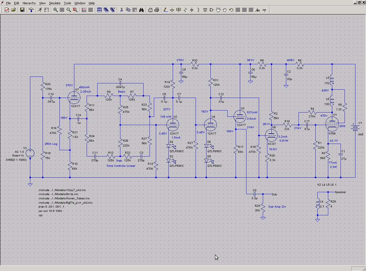

I played around with the changes I mentioned and I do like the looks of the gain and headroom improvements. This is the last circuit that I sim'ed. A couple of notes.
1. All preamp tubes are 12AY7 simply for their good microphonics properties and linearity. I could be convinced to use something with higher gm if the microphonics are as good. As it is though the performance requirements don't seem that high in this application so it looks like they should do fine as is.
2. C12 is intentionally sized to reduce output below 30Hz to avoid wasting power on frequencies below that which the main speakers can really handle anyway. Since I now have plenty of gain I may even put a second order network in there instead. The sub amp output of course does not filter out these lower frequencies.

Any opinions gladly considered.
Another thing I wonder about is whether the input CF would perform better with voltage divider bias rather than bootstrap.
Oops, the 214V tag by U3 is bogus. I forgot to delete that label after the last round of bias adjustments.
BTW, not having a 6CG7 on hand and only one 12AY7 I checked the bias differences and it looks like substituting a 12AU7 (which I have tons of from a Baldwin) will only change bias by about 10% and so I think I will go ahead and build a beta test version using 12AU7 as the driver. I will only need to switch up the heater wiring when I get the proper tube.
I may also try doing a beta of the preamp using the tubes I have on hand by using the original schematic but adding the 12AY7 final gain stage and see how it goes. If the gain structure seems right then I can switch out a few resistors and move to all 12AY7 in the preamp if it still seems like the right thing to do.
Time to go digging through my parts and see if I have all the necessary passive components on hand.
Using 'Schade' (i.e. anode follower) feedback with UL is a bit like using both a belt and braces to hold your trousers up. I would use one or the other.
Putting the tone controls before any gain carries the risk of some thermal noise from the highish value resistors. Have you done a noise calculation, just to check it will be OK?
What do R19 and R20 do, apart from attenuate the input signal?
2dB feedback is not worth having. 6dB feedback is about the optimum amount for maximising high order distortion! You need either no feedback, or at least 15-20dB.
R19 and 20 represent the volume pot. I have not done a noise calculation. I put the tone controls first to reduce the amount of swing that U2 has to deal with. I could reverse the order if noise turns out to be an issue but I would have to be careful that the tone control tubes (primarily the second one) are not over driven.
As to belt and suspenders I plan to try it with and without the FB resistor. If it sounds just as good without I will dispense with it.
