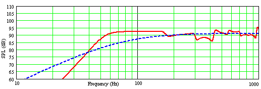

A monolith is a style of cabinet (aka a tombstone)... here is a Monolith FE127 box (called Mileva). Based on the numbers for the FE127e Metronome and tweaked by Scott into a baby ML-BIB sort of thing... it stands less than a metre high and less than a 1/2 ft deep. (looking at the plans 11 1/4 x 32 5/8 x 5 1/8 (287x827x132) excluding the optional base)
A larger driver is going to mean a larger box, but it gives you an idea of how it might be configured.

rcdaniel said:Very nice job on Mileva - there is something inherently aesthetically pleasing to me in wide and shallow cabinets. Will the plans be posted?
Thanx. The 1st build of these is underway. If they turn out we will post the plans, and will see what other drivers look like in a similar scheme. To get an idea of how big they would be for any driver, take the numbers for a suitable Metronome, height goes to a bit more than half (add 25-30% to the Metronome height and divide by 2), and the footprint will be about Sl.
http://www.frugal-horn.com/metronome-table.html
dave
rcdaniel said:if Mileva could be could be developed for the FF165k or 168ESig, at a reasonable size
The quick math suggested above suggests a cabinet a bit over a metre high with a footprint of 14" wide by 7" deep. It could get shallower with a bit more width, but some room for the driver to breath is important.... a supraBaffle like on these PAWOs might be helpful (and certainly a cosmetic plus (but not with Chris' SO)
