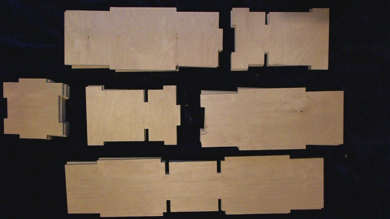

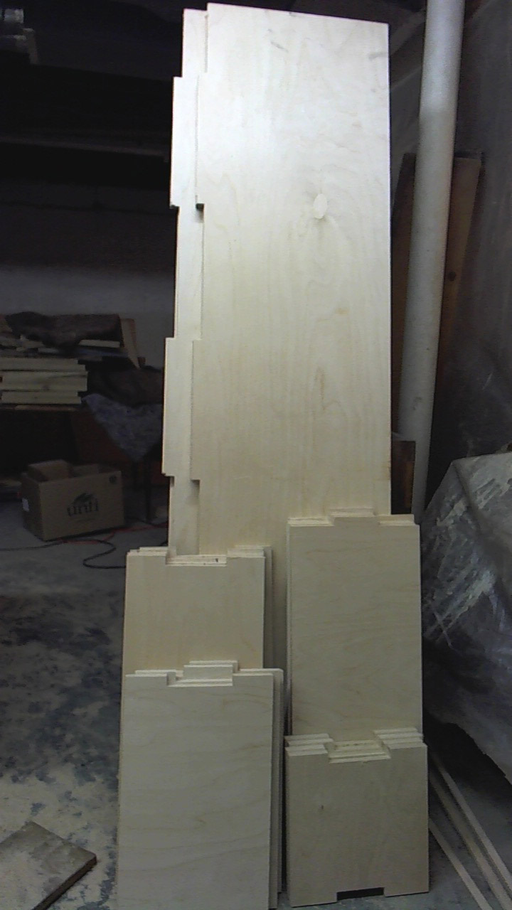

Box Joints
I am not going too crazy with these, as the main purpose for them is to align everything for glueing. They sure look cool though. I am think I want to incorperate them with the solid maple exteriors I have planned, we will see...
Still a lot of cuts, something to look forward to after work tomorrow.
Thanks for all of your thoughts, this would not be going as well as it has without them.
God bless,
Allen

Allen,
Nice job on the cuts and good choice in construction technique.
I read in one of your earlier posts that you might screw them together and Zia's comment about backing out the screws and filling them. Instead of fill you can drill the hole larger and insert a piece of doweling 8 mm or so, this will also add strength to the join and is decorative if you use a contrasting piece of doweling like purple heart or black walnut. Use a smaller head screw like a #1, you can also drill the hole at an angle to give the finished dowel an oval look.
Looking forward to seeing your finished product.
Bernie

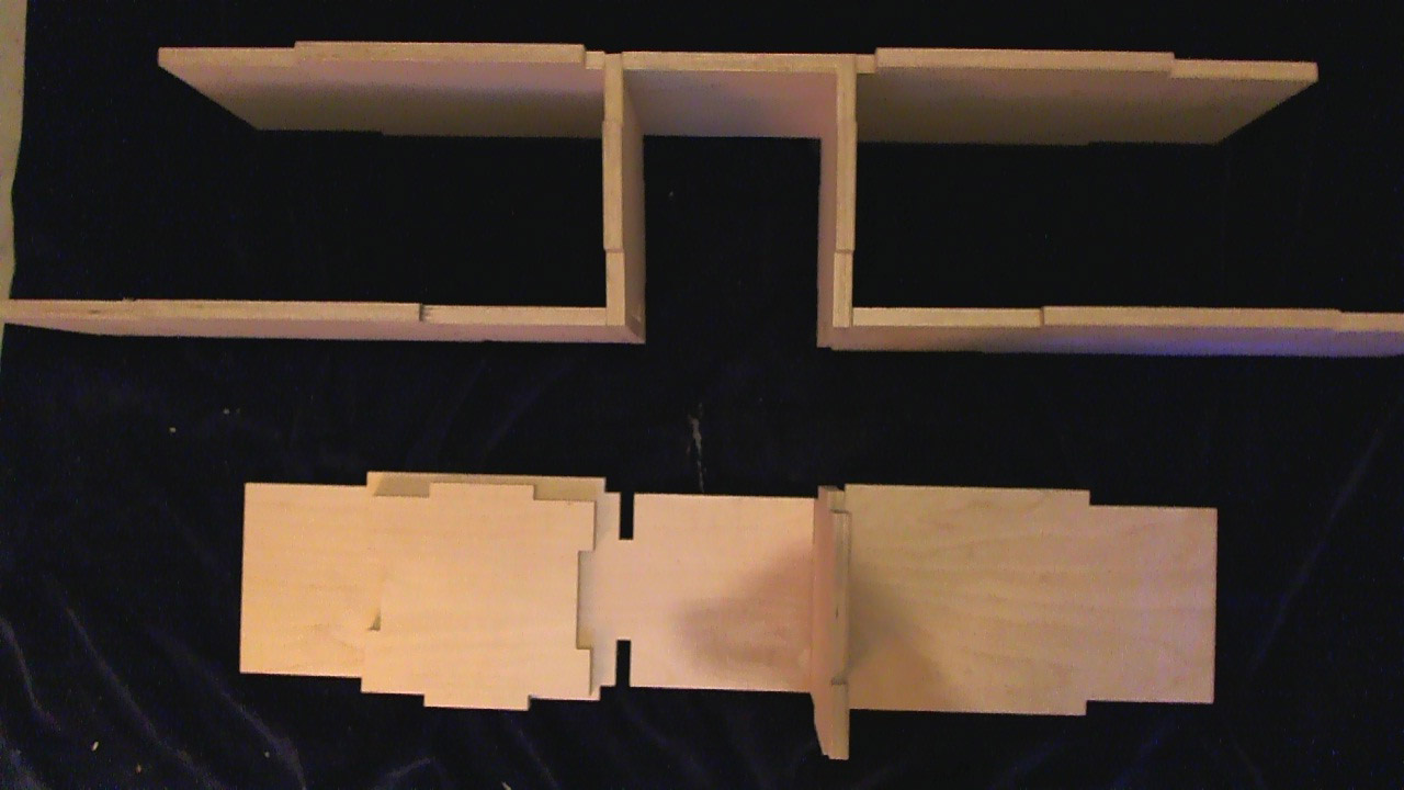

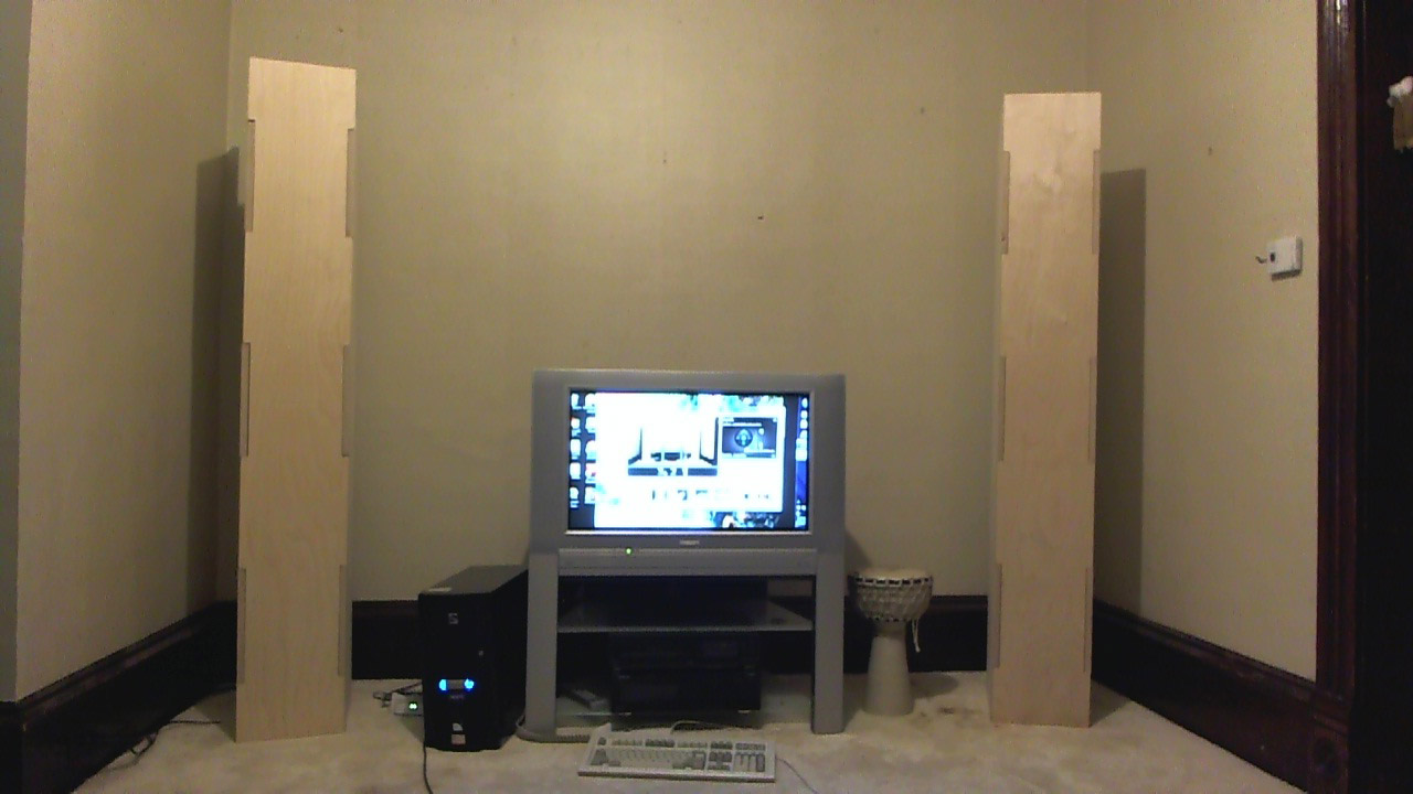

A taste of victory
A struggle in the shop today, some joints off a little (biggest is 1/8"), but that is where the science yeilds to art. I will show you later how I will fix this. All and all this is part of the normal process, things are really going well. I still have a lot to do, it would be too easy to do a "sick" day off work tomorrow, but they really need me...
So, here are the front and sides dry fit, standing on their own. Victory is at hand, it is a matter of continuing to press forward.
Thanks Bernie, Gychang, and those of you in hiding for all of your encouragement. I will respond to some of your comments at a later date as I am in the heat of battle right now!
Allen
Allen
Allen

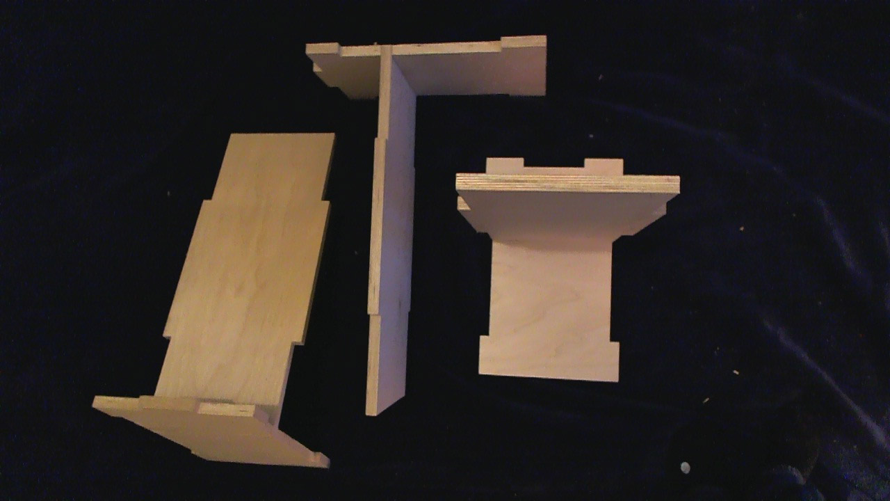

Puzzle Pieces
Had a couple of short yet good sessions in the shop. Got all horn profile pieces notched and fitting well. Now alls I have left to notch are the front and sides, some of which must be done free hand!
Drivers are waiting for me at the Ironwood post office as Dave sent them with delivery comformation, which I am glad he did. I have a pretty heavy day at jobs tommorrow, so not sure how much will get done, although those drivers will be unpacked for sure!
I have also been collecting a couple of clamps here and there from freinds, so I hope to pile up enough to get these glued up. It seems no one person has enough clamps!
Enjoy the pictures...

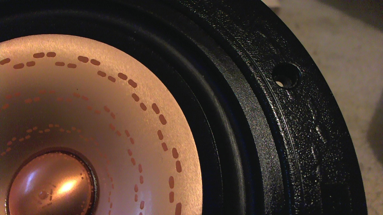

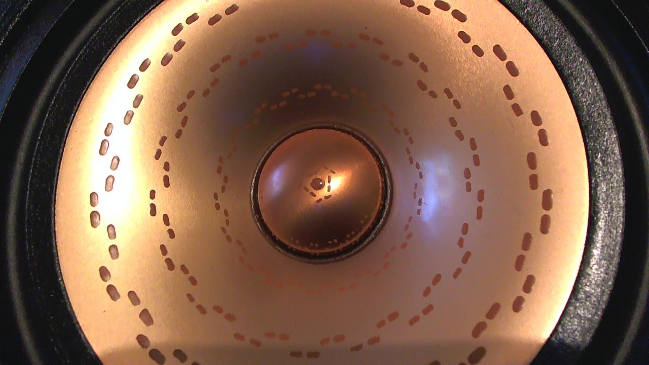

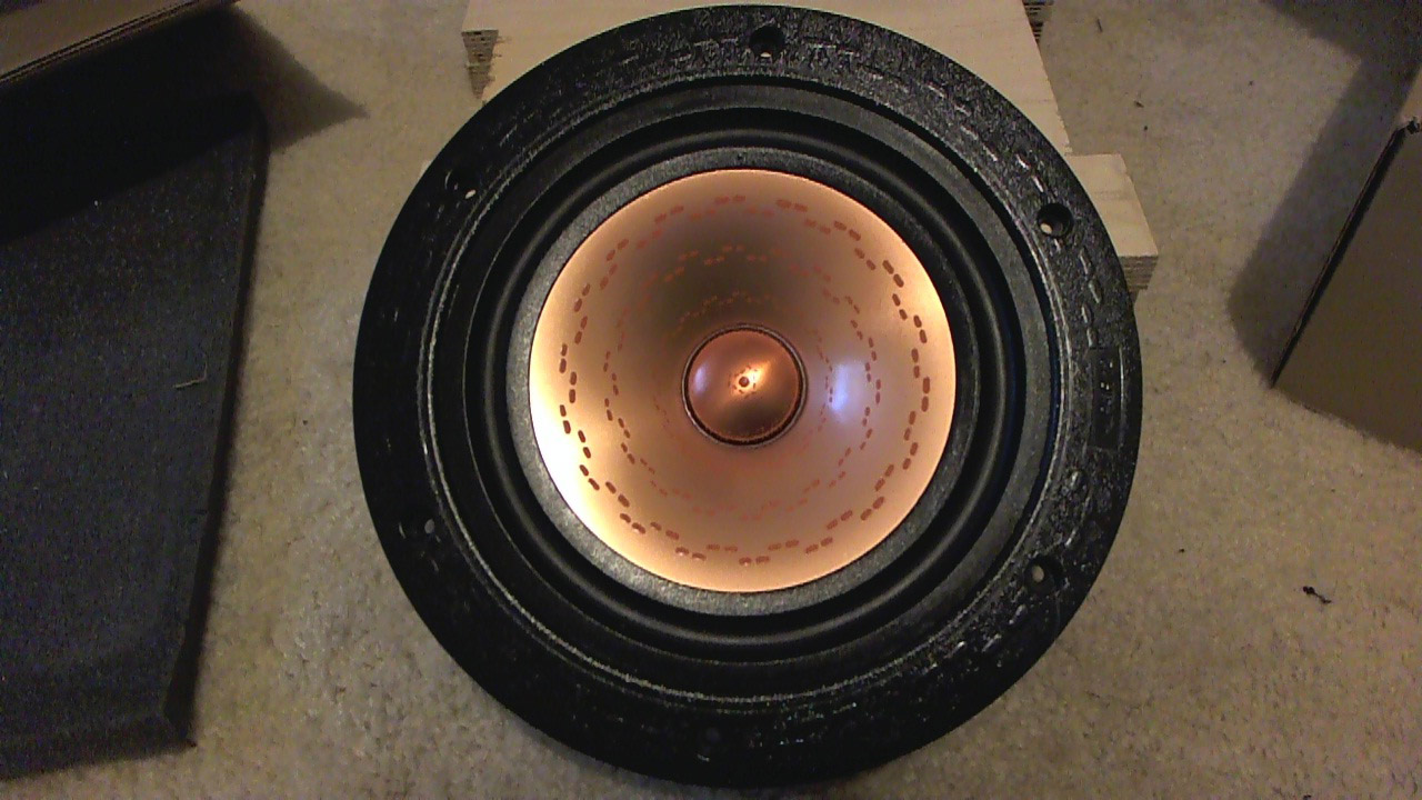

Wow!!!
There is no buyers remorse here! I am so very impressed. Hats off to both Mark and Dave. It is rare to find artistry at this level these days, there is hope for humznkind yet! I can not wait to hear them...
...I would start breaking them in, but I do not have an amp! I sold my Sure class-T amps with my last system, as it was designed to be a self powered system. I am keeping my eye open for a mass market amp cheap, although I am reluctent to take any chances with these drivers. Even when I am done with my GC, it will be tested on some cheap drivers I have laying around first.
So what kind of wire have you guys been using on your full-range systems? I liked the cat-5 wire I used on my last system. I used four wires/conductor as in 8 wires/channel on my last system. Would more be better for this system as it is full-range? Or would you guys recommend diferent wire altogether? I need to figure out the wire, so I can decide how it will work with the cabinets. I would like the binding posts on the bottom in the back, which means I will need to build a base of some kind. If I go with that plan, that will also mean the horn will be off the floor about 3-4", so not sure if that is a good idea... details, details, details.
I will difinately be covering these cabinets with the solid maple pattern I have designed. After seeing these drivers, I am certain that is the right thing to do, eventhough it will cover a lot of this neat joinery I am doing. It appears we are going all the way with this system!
