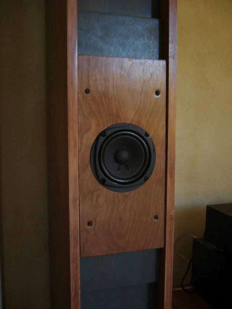

Scottmoose said:That'll be the Chang cabinet with the Pioneer B20 & helper tweeter. Better with the Fostex units of course -depends on your budget.
I am also very fond of mikasa with 4.5" Pioneer "el cheapo" driver with helper tweeter. Both are great cabinets.

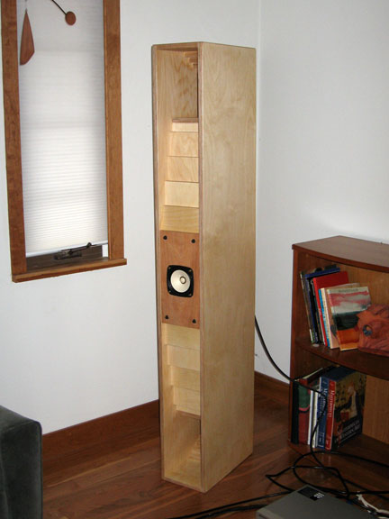

cervelorider said:Fostex 126E installed.
good job, looks high class.
gychang

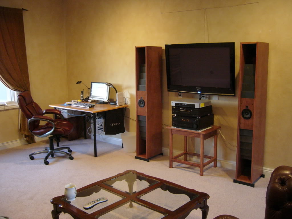

Sorry, I haven't browsed fullrange forum recently... but now the weather is warming up for the ideal speaker building...
My favorite remains Mikasa, for auditory qualities for minimal $$. I listen to jazz/popular at least weekly basis. It has tremendous visual appeal as you can see here on youtube.
http://www.youtube.com/watch?v=crbljRFoO5w
I have the same set of speakers in BIB detailed here (http://www.diyaudio.com/forums/showthread.php?s=&threadid=134923) but for me Mikasa is better. Neither (BIB or Mikasa) is designed for these speakers, but I can assure u these cheap speakers in Mikasa sings with surprising bass extension (I don't use or miss subwoofer in either cabinets). I have been lazy and have not done any more mods, they sound great to me as they are.

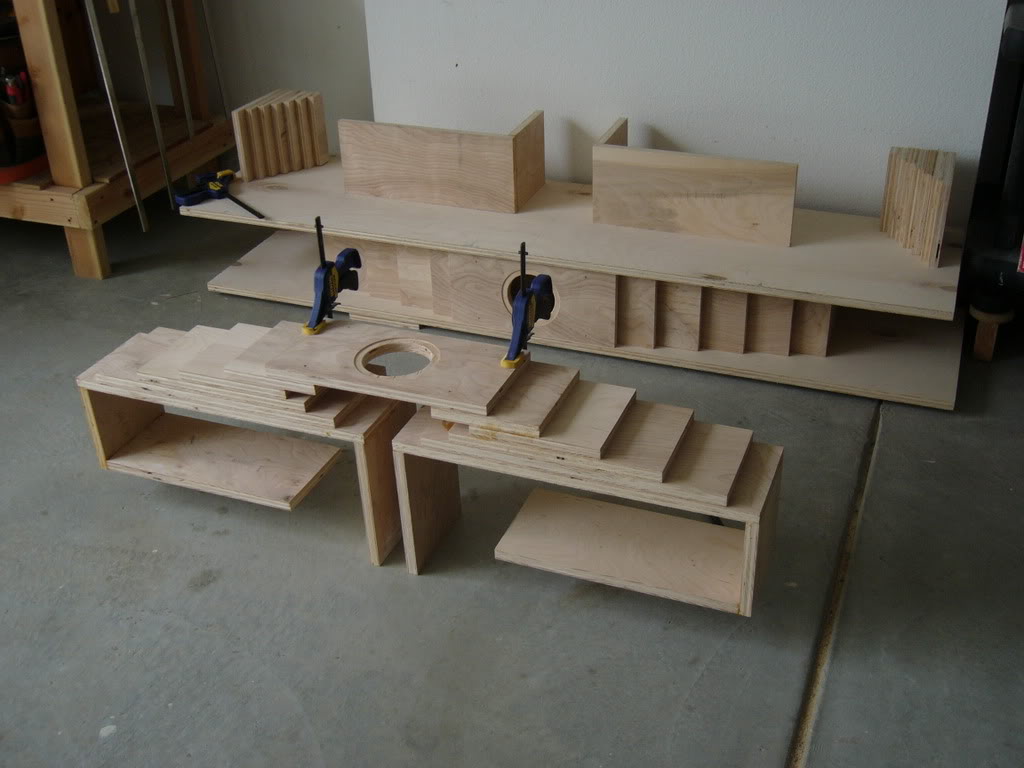

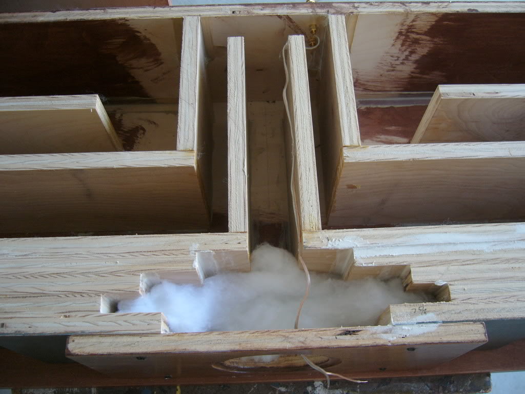

Now my future project remains 2 more sets of Mikasa with same speakers setup. I will likely use the same stuffing technique but will add the triangle piece near the back of the cabinet. My relatives are begging after listening and seeing my pair, and I have agreed to oversee their build in my garage in few weeks. These young guys can be pushy.

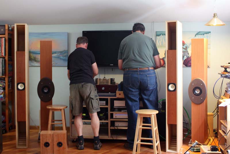

Maeshowe was specifically designed for the Mark Audio drivers (CHR & EL70/ Alpair 7), but serendipitously enough works like a charm with FE126E
Here they're shown next to a pair of Saburos, and the tallish gentleman who built the latter. The Maeshowe is 60" tall, and a pair will consume 2 sheets of BB ply (in our case 15mm worked just fine)
The elliptical suprabaffles were built to accommodate quick change demonstration with the above mentioned 4 drivers - which others might work satisfactorily would be anyone's guess.
