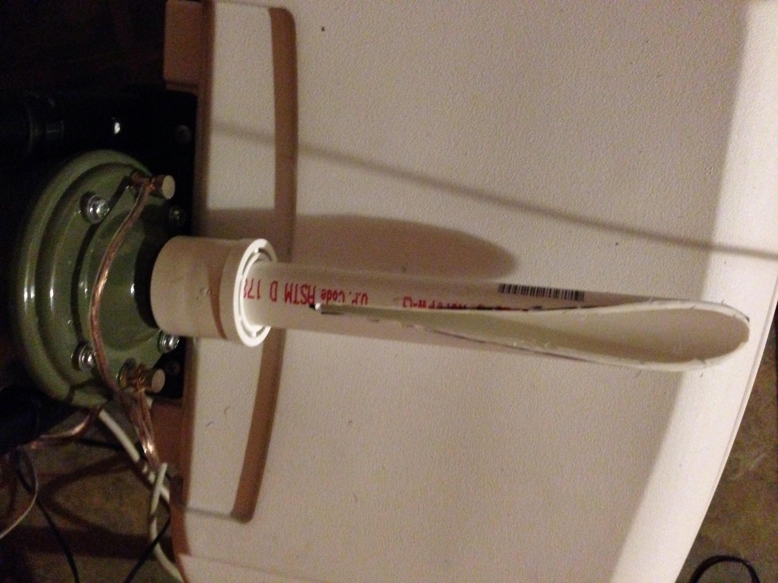

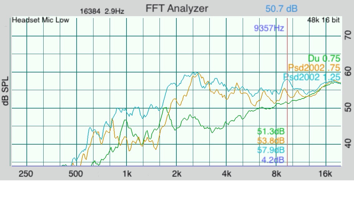

I tried some 3/4 " PVC pipe mates to my compression drivers via a reducer .
Sounded somewhat better than the larger 1 1/4 " pipe even through the graphs don't show it. This is workable as a tweeter, though probably not as a midrange as originally intended . As in the previous experiment, the eminence sounded better than my mcm paging driver.

that's a cool looking tube - maybe for helper tweeter use try ~3.5 " long (?)
a 1" pipe ~5.3" long should sound pretty good and better than some CD waveguide provided a high enough xover.

I agree, dispersion is good and doesn't seem to have too much drop off with increasing frequency .
I missed it if it has been mentioned, but was there any Xover on either set of measurements? I see no other reason for either the paging CD or PSD2002 not to have solid output down to at least ~900Hz.

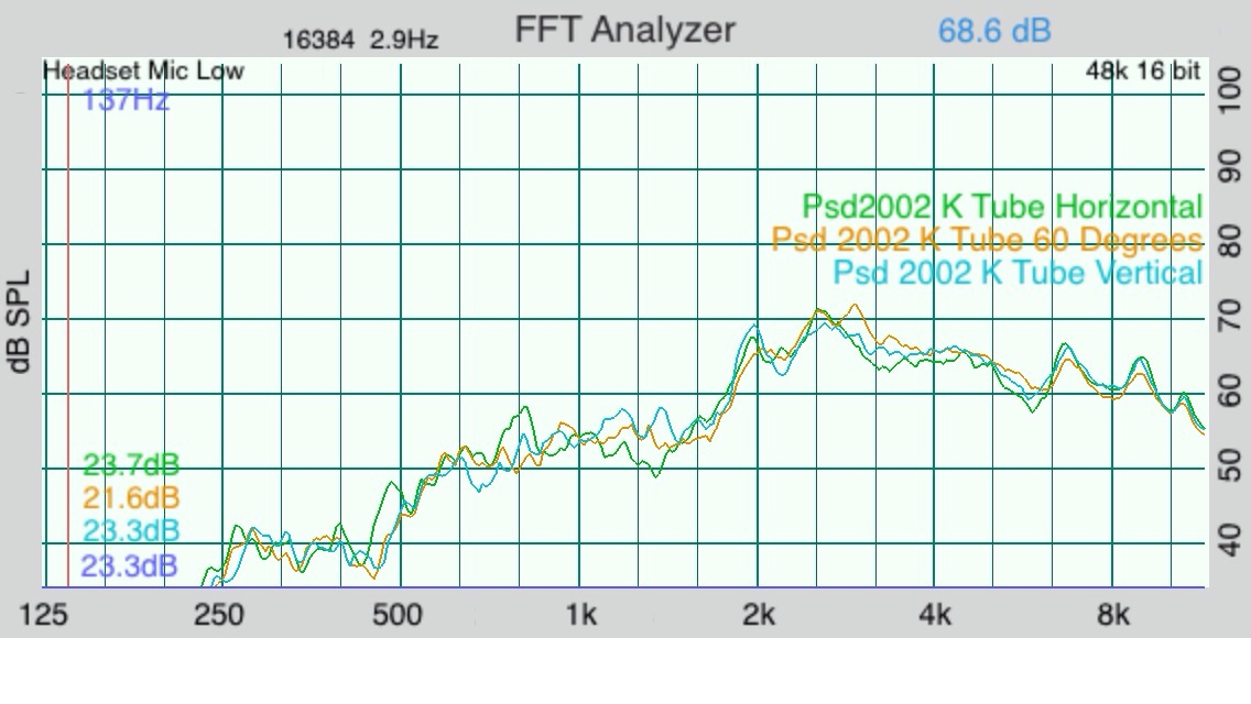

No crossover, though the measurements were farfield in-room . Over the weekend, I might re-measure with the tube axis pointing straight at the mic and the slot facing upwards. Wondering if angling the tube or pointing it at the ceiling would be better since the slot arguably diffracts the sound away from the axis.
I can try and take some more SPL measurements outdoors (as well as impedance measurements).
the output of a tube perpendicular to the long axis seems to compliment the other perspective
the other device on this graph is Speakerlab's "wide angle" version of EV's T35 - its not attenuated
so the tube is ~10dB hotter. my 3.3uF/0.55mH highpass was not optimal for the DE25/K-tube combo.
