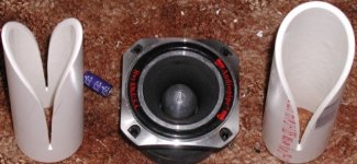

I have a pair of midrange paging drivers that will allegedly do 100 Hz on the low end (yeah, right).
1 3/8 X 18 Thread 40W Rms Midrange Driver Threaded | 54-050 (54050) | Distributed By MCM
Pondering if there's any potential used as a midrange K-tube with some PVC tube stuck on the end.

you may get a surprise and find they can play that low the question will be how loud? they can't push a lot of air given the diaphragm size. I have found that a 1/4 wave line is all you need. Pick either the given Fs or look at the peak on the impedance graph if one is available. I like to use the double cutaway K-Tube which looks rather like a bishop's hat see the one on the left side. Best regards Moray James.

That is a really interesting driver - how does it sound and does it really reach 100 Hz? You can so a quick and dirty test with just stiff card stock.

Assuming a fairly standard profile, that is, a single half-elliptical cut in the tube, the effective length is roughly 90% that of the slotted length. An initial un-slotted section changes things, but I have not studied that much myself. I base this upon my measurement of BMS 4550 on a Transylvania Power Company "The Tube". It is 5.3" long and slotted on its full length. Versus the "naked" driver, i.e. no horn/wg, there is a reduction of distortion starting at 700Hz. This suggests the need for a 37" or so tube to work down to 100Hz. The proportions will then be much different from my tube that my assumptions might not hold up though.
The Faerber Equilibrium speaker uses a super-long unslotted section, I'd sure like to see raw SPL and impedance measurements for that one. Freddi experimented with something similar.

GM, how would you analyze the following K-Tube measurement? This is the Transylvania 1" tube, 5.3" long, fully-slotted, on a BMS 4550 1" driver. Mic was "nearfield", which probably means a few inches away IIRC.
Blue Trace - "naked" driver and its distortion
Red Trace - loaded with The tube and its distortion
We can see distortion is reduced above 700Hz, up to ~1600Hz. Output is stronger below 1600Hz down to driver cutoff. The 2kHz dip and distortion peak may be throat mismatch/reflection? Response is often smoothed-out by the K-Tube in the upper registers.

This is the crux of the matter and since a 1" tube is 'done' at around 4316 Hz, it realistically will be 'done' ~3 octaves away or ~540 Hz, so figure only usable from ~1080 Hz, just as its response indicates. Increasing the tube's diameter to 2" will help down low at the expense of the HF output, but now power handling has been severely compromised without increasing the driver's Fs.

That's @kenpeter 's old (and much despised) clothespin. IIRC, I "might" have that actual piece somewhere in the garage. That 2" diameter waveguide is tuned higher than I want for this experiment and from listening to it many years ago, it wasn't that good sounding on an eminence PSD 2002 compression driver. That said, I'm aiming to go lower for this experiment (maybe as low as 300 - 500 Hz). Back then, we did have much better luck experimenting with K-tubes using some smaller vintage alnico compression drivers (which I should still have, hiding somewhere).

Here is the Transylvania Tube and next to it, a brass tube I made, which is essentially the same, but with a ~1" or so unslotted "stub" section.
Driver is BMS 4550 again. Mic was probably a foot or two away, at a certain angle down the slot, judging from the rolled-off HF. The brass tube apparently introduces a notch, which I can only attribute to the plain stub at the base. This also allowed support for greater LF output

Any slot fabrication hints that you can offer?
I was thinking of transferring a paper template and using a dremel cutting wheel to define the rough profile and a dremel grinding wheel or sanding disc to finish things up.

If anything, the driver needs more loading to flatten it out based on its published response, so a 'fast' adapter to a longer 1/2" dia. pipe might be worth experimenting with. This increases the pipe's HF cutoff a full octave higher and if ~25.1" long [1 WL of 540 Hz], it may still be usable to ~1080 Hz if it damps the ‘dip’ good enough without rolling off the top end too much.

Pretty much what I did. I drew my half-ellipse in Illustrator and printed, cut with Xacto knife, wrapped around the tube, transferred the slot area to be cut with a black marker. I did the rough cut with small cut-off wheels and mostly filed the rest by hand, since brass is pretty soft.
