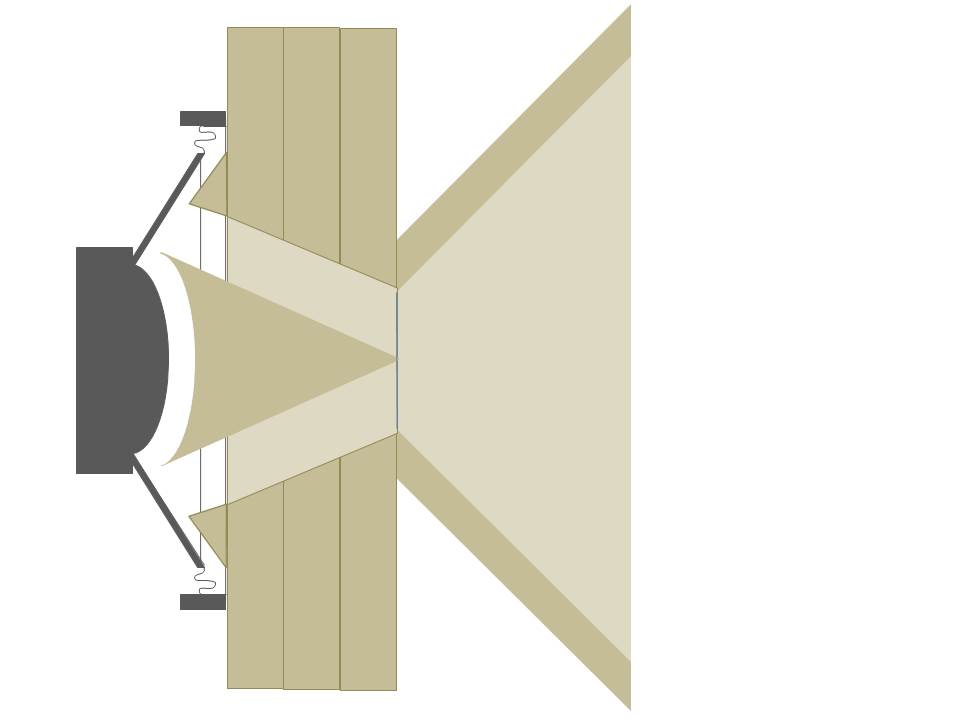

I went back to centauraudio.com.au to revisit phase plugs and played a bit with drawing a cross section (boy, do I miss having AutoCad!!) and Hornresp. What you see below is far from optimized, but rather to confirm if I'm the right path.
  1. First picture is a cross section of the driver + axisymmetrical conical phase plug and matching throat + 90 degree conical horn.

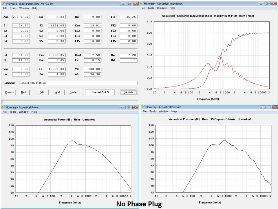

  2. Second picture is the Hornresp output for this driver and conical horn, without phase plug. Notice Vtc is 100cm3, which is my estimation of the volume in front of the cone and before the conical expansion. Note Atc=94cm2

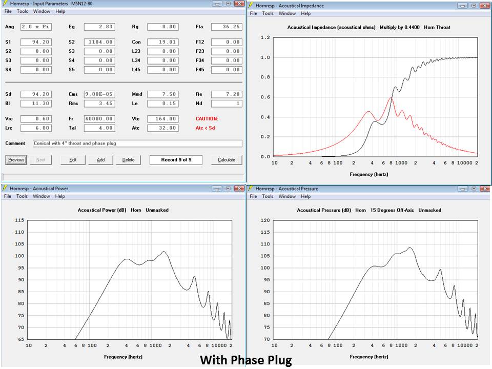

  3. Third picture is same, but with phase plug. Now Vtc is same 100cm3 + volume of the conical cavity in the throat - volume of the conical phase plug. While the phase plug takes volume away, it is less than what is added by the throat...Also note Atc is 32cm2
As expected, higher frequencies get boosted, but the higher Vtc acting as low-pass filter plus mass roll-off brings response down like a rock around 2kHz. Significant ripples also.
At these frequencies, am I right to look at coustical pressure rather than acoustical power?
Am I sort of kind of on the right path?
FWIW Sd/Atc=2.94. High, low?
One way to reduce Vtc is to make the phase plug shorter, but I'm thinking that would create higher turbulence at the exit. Should I make the phase plug longer?
Another way to reduce Vtc is to make the space between phase plug and conical throat thinner.

Is it correct that the phase plug acts primarily as a throat chamber volume reducer?
From the picture, it seems that it would also act as a port between the throat chamber and the horn. In HR you can model a sealed chamber as "throat ported" and then the length of the phase plug becomes the length of the throat port. You can model different lengths and find an optimum or best tradeoff.
