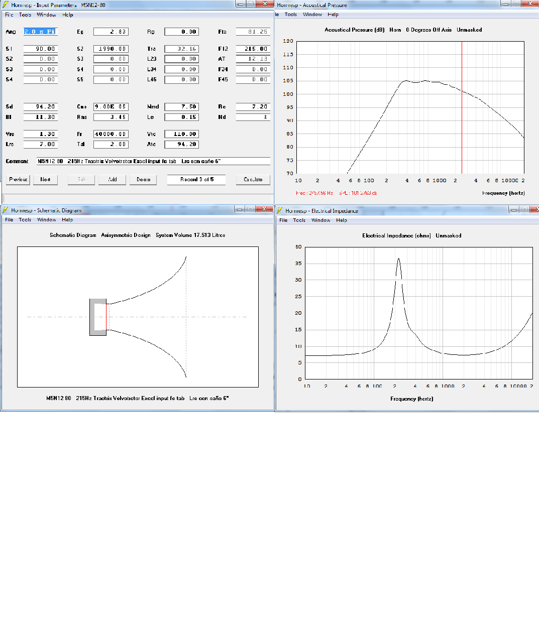

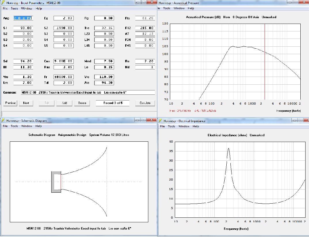

Have you considered Hornresp to simulate and produce dimensions for the horn. It gives you the choice of width flare (con, exp, uni) and will export the dimensions of a horn (rectangle, symetric, petal) to a CVS. It's an excellent tool and free courtesy of @David McBean and can be downloaded at Hornresp .
