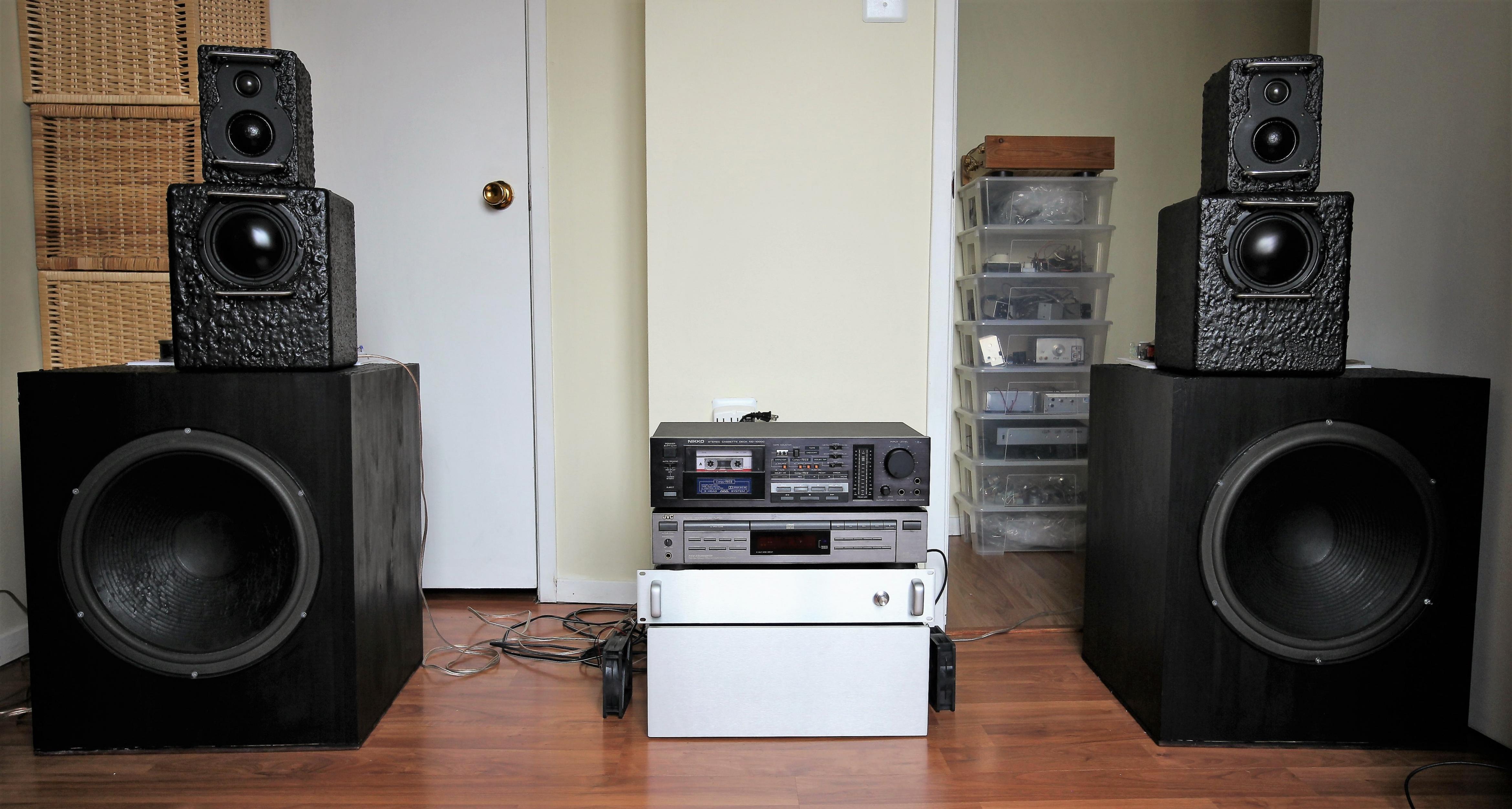

I love domes, properly used will yield a great sound. I have about 4 speaker systems utilizing some domes. Here is 4-way I just finished working on crossover. Absolutely happy about the result. I have not moved it downstairs to compare to the main system yet, but I can live with this sound.

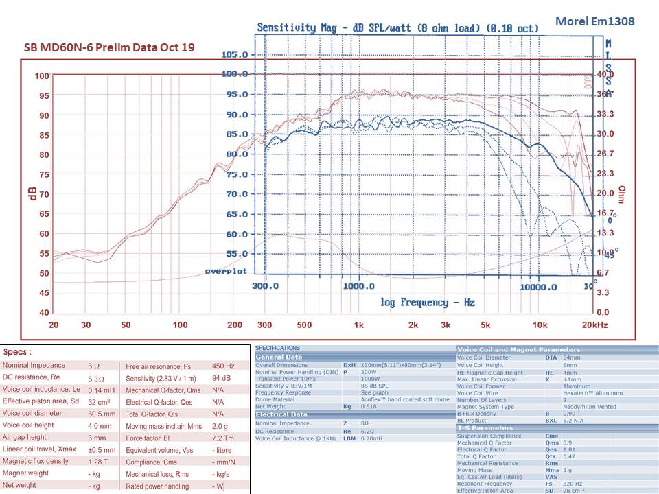

Quick and dirty comparison between the Morel EM1308 and SB MD60N plus specs. Data taken off datasheets from both company sites with graphs re-sized to be the same scale.
I am hoping that the full data and production unit graphs plus prices and availability for the SB are going to be announced next month as previously touted (iirc there is a big HIFI show in the far east then?).
