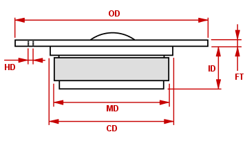

Vifa makes this. I've used this to good effect . It has an open back and the low end can be tailored by a rear enclosure/dampening wizardry.
D75MX-31-08
Nominal impedance [ohm] 8 SPECIAL FEATURES:
Voice coil resistance [ohm] 5.9
Nominal power [W] 80 Precoated fabric
Short term max power [W] - diaphragm
Long term max power [W] -
Operating power [W] 2.5 Low moving mass
Sensitivity [dB] 92
Frequency range [kHz] 0.5-6 Internal ferrite
Free air resonance [Hz] 300 magnet
Voice coil diameter [mm] 76
Voice coil height [mm] 3 Very linear impedance
Air gap height [mm] 2
Voice coil inductance [mH] - Internal Diaphragm
Eff. diaphragm Area [cm²] 55 protection grille
Moving mass [g] 3.3
Magnet weight [g]/[oz] 240/8.5
Force factor [Bl] 4.7
VAS [l] -
Qms -
Qes -
Qts -
Mark
