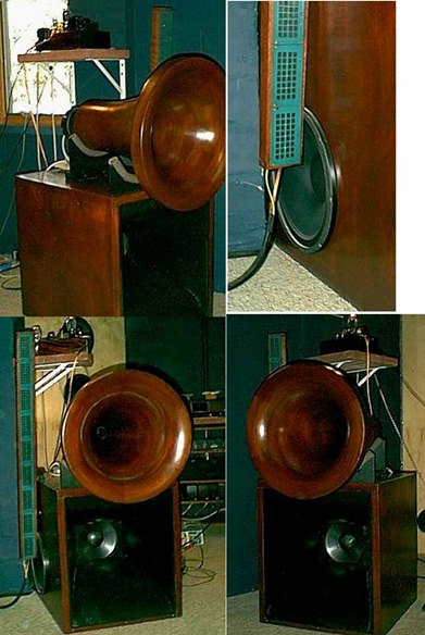

Probably true. I think there are just a few ways to slice the cake, and that surely is one of them. Recipe #1 that has worked for me is a full range in a large round tractrix type horn covering most of the vocal range, adding in mid bass and sub bass, or just a bass section, with a tweeter on the very top,
OR:
(your recipe):
Sub of your choice; mid bass= horn loaded 8-10 inch cone 100-750ish, mid range from a nice compression driver/horn 750-4kish, tweeter on top
Yep. There ya go: recipe # (looks like a combination)
