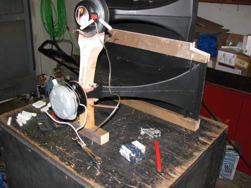

re: cheap Selenium, here's the Trio version on a 511 Altec horn

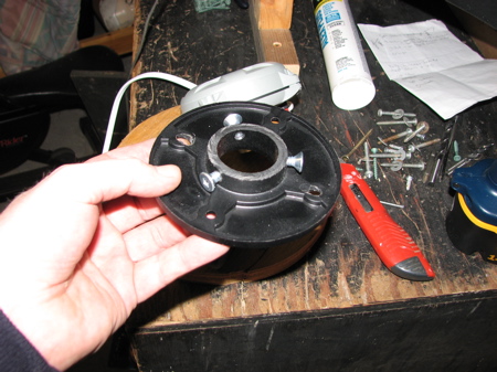

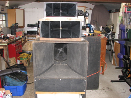

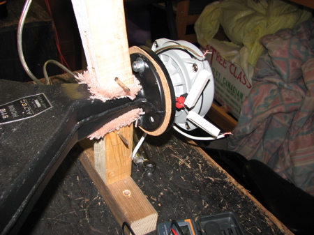

re: cheap Selenium, here's the Trio version on a 511 Altec horn.
Good to see. That's a combo I use. I had to make the waveguide/adapter you see in the pics. It's actually a PA loudspeaker pole mount socket. Hey ya gotta do what you can with what you got right? :)
is there a compression near enough the old Altec 288-C in the new cheaper of shelf drivers ?
I wouldn't think so. That a big hunk of metal and I can't imagine it's equivalent as being cheap. I sent mine to Great Plains to have the 8Ω aluminum diaphragms installed and a remag and they are a great driver when mounted to a big horn like the 1803 or 1505.
