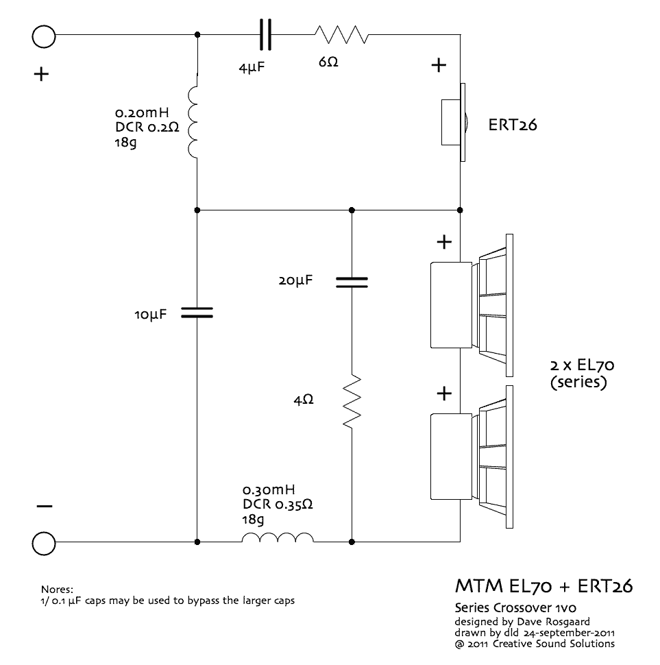

hmmm… an interesting experiment. I have both a regular microTower and a set of Thirlmere R. mT currently has CHP70.2 with ERT26, i am goining to pull them and install some CHBW (same except up top). I was already going to install CHBW in Thirlmere, Scott having said they will work. My plan is to use those as a helper woofer.

That's a good discussion to have. After my recent upgrade, I of course have 4 orphaned EL70 drivers. If I use them again, I will likely want to cross them to some tweeters. They really only need help from about 10k up, but blending something in starting around 6k might be best.

I have some ERT26, 1 set EnABLed, another not (i think i still have that last pair)
One of the Nessies with the and EL70 firing up and the tweeter above the front EL70.
This box maximizes bass extention at the expense of some ripple.
