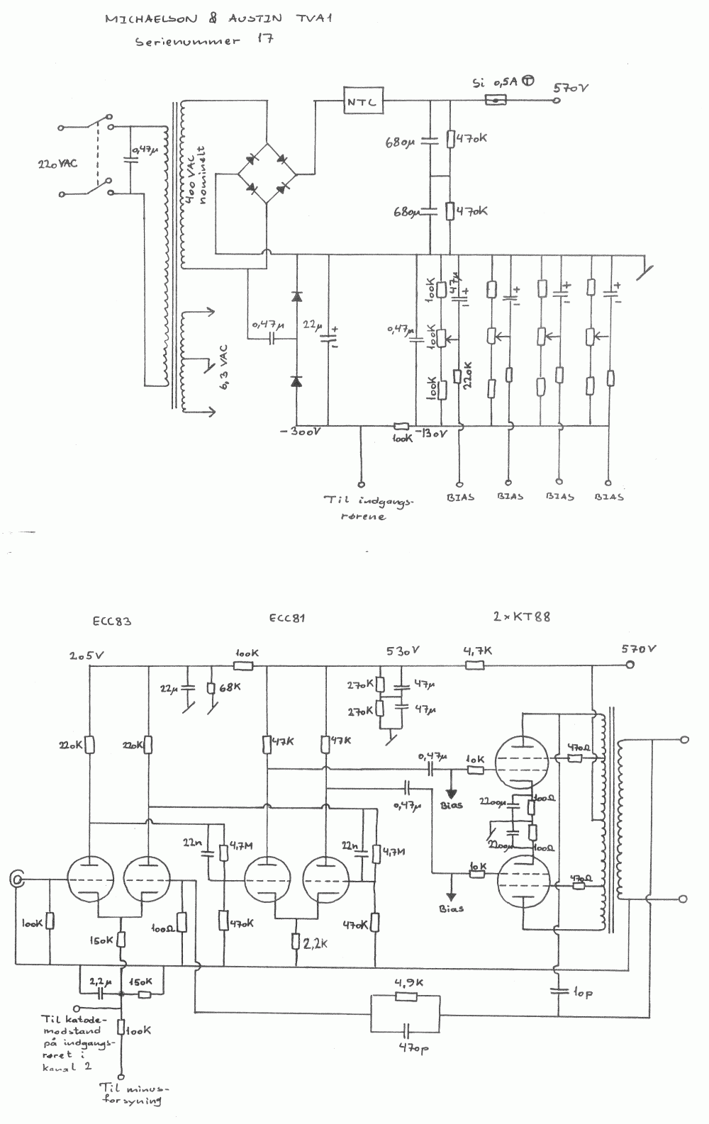

Hi Torben,
Thanks - If you can find the two papers - the one you draw and the paper you believe to come from the original service manual - we finally can determine the genuine TVA-1 circuit.

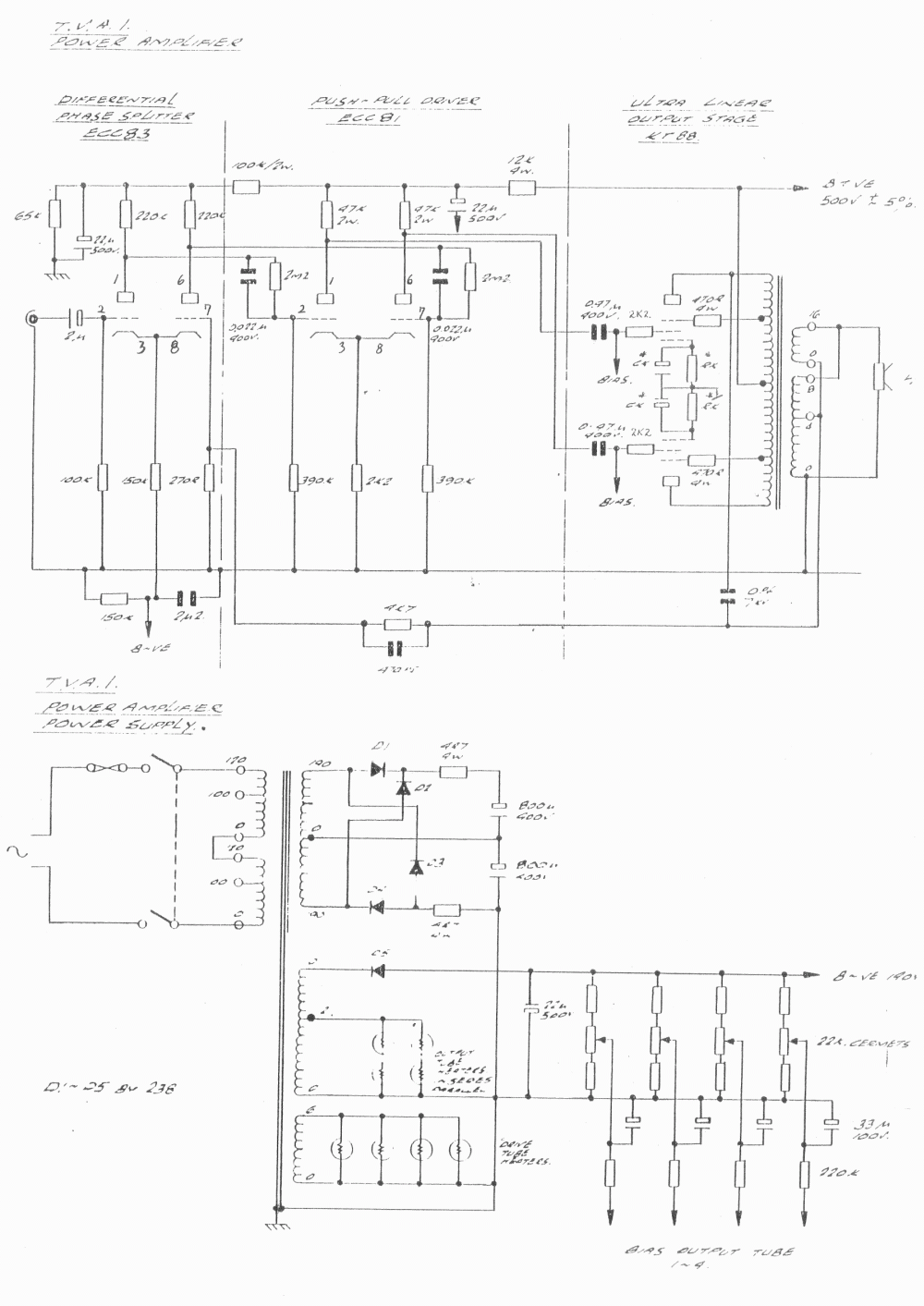

The schematic I found by checking several japanese pictures is slightly different compared to the circuit in Hiraga's book "Rörförstärkere". As mentioned erlier the bias resistors in the japanese amplifiers is 220K just like you suggested the highest value to be calculated from grid to cathode on KT88. The first picture in this thread is identical with the circuit in Hiraga's book.
It surprices me that you messured +B to heroic 570V. According to 2 times 190Vac times (approx.) 1,4 = leaves a little more than 532Vdc on the plates of KT88. Perhaps this is not a world of difference, but it makes me understand why the lower current drawn by KT88 keeps them steady.
The intension is to come as close to the original circuit as possible - but with stability. I think TVA-1 is a wonderful amplifier as well.

Hi
I compared Torben's schematic of the power supply to mine this weekend and it is in fact exactly that. Would anyone be able to assist me in getting the appropriate specs for the NTC (thermistor) to replace the one in my amp? The body of mine was cracked and I took it out some time ago and subsequently misplaced (lost) it. Sadly I lack the knowledge to come up with the appropriate specs myself. I appreciate any help.

Hi again
Here is a schematic drawn from my brothers TVA-1 amplifier more than 20 years ago.
Note: The smoothing parallel 47u capacitors and 270 k resistors were originally one 22u capacitor in bad condition.
Regards, Torben

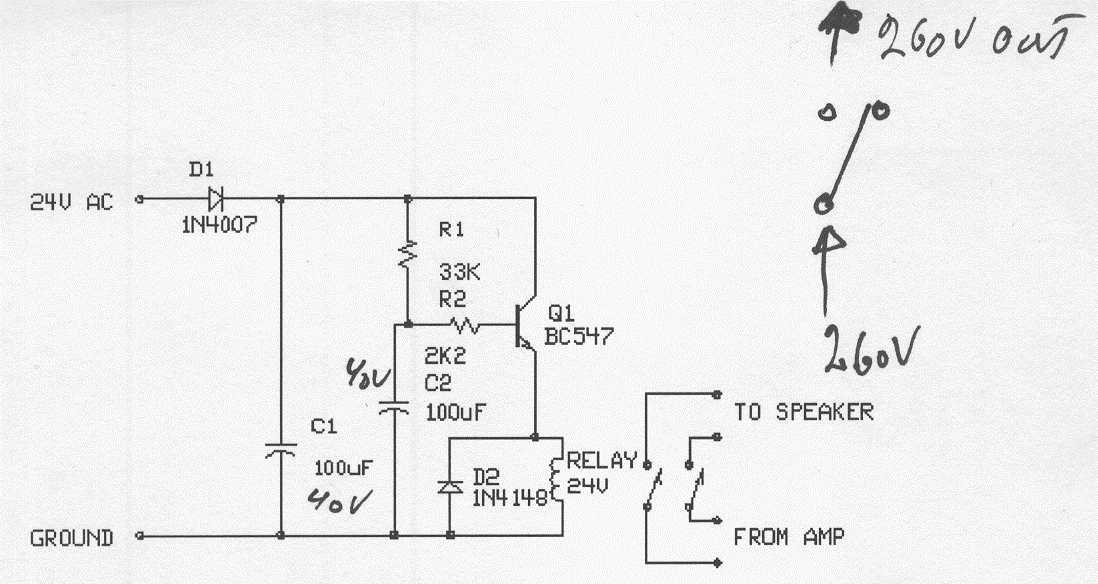

The suggestion stated by Torben using one 5W resistor to replace the NCT thermistor could be one alternative.
A second possibility could be a 5-10 second delay 6 or 12vdc relay with a 25W aluminum resistor parallel or across the relay contacts.
The resistor size is, if we have 330Vdc across it, and allow the amp to draw 50mA at startup U/I = 6K6 - and the needed wattage is UxI 330x0,05= 16,5W
Because the resistor is only 530Vdc loaded in about 5-10 seconds 25W is sufficiant. The relay takes approx. 100mA from the heatersupply with a approx. 5 sek delay on the attached circuit.
One may have to ajust the resistors in the circuit as the design is made for 24V.
We will get some protection of the high volt capasitors at power on, and the heaters has some glow-up time before the full high voltage is applied.
Just one idea!

Yes I am very lucky to get the TVA-1 unmodified, from what can be seen on the pictures. I have not received the amplifier yet - the lady who sold it to me, can't lift it ! -)) - She needs help! I may get the M&A first in the new year.
I think Torben's drawing is very, very good and close to the real amplifier, and I will try to check the circuit of mine later and return to you with details.
